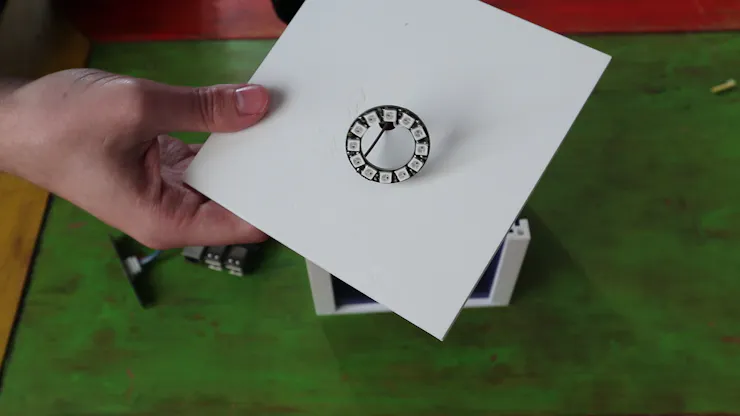

Happy with our box, we can 3D print a poop emoji made by 3DCreatorPurzi. All we have to do is add a hollow space in the bottom to hold our NeoPixel ring.

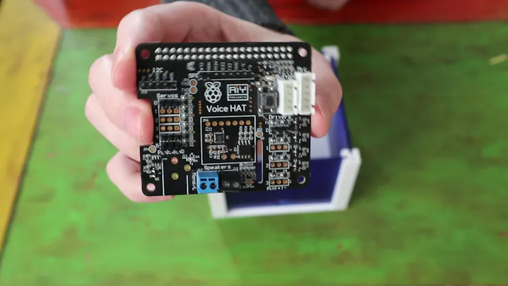

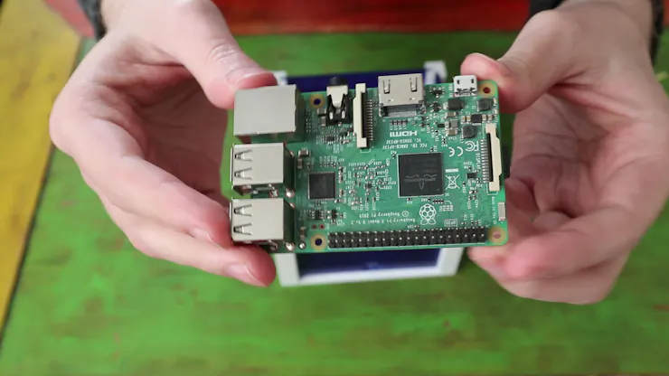

It all starts with a Raspberry Pi 3B+.
Because we want to use Speech-To-Text we also have to add an AIY VoiceHat and the corresponding microphone. It's all documented right here.
Last but not least, we wire up the NeoPixel ring, here's a great tutorial for just that.
With everything set up we can test out the Speech-To-Text and NeoPixel ring, the test code is attached.

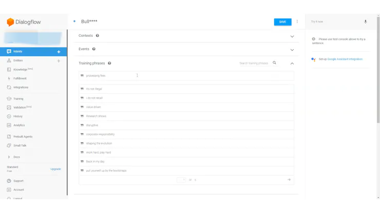

Training the AI - Dialogflow
For our AI we are going to use Dialogflow. Originally, it's meant to be used as chatbot software, we can slightly misuse it to train our bull**** detector.

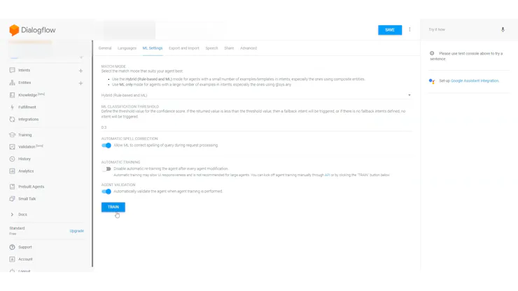

We create two intents, one is our fallback, and the other bull****. Next we add all the content in the training phrases of our bull**** intent. You can really go nuts here.
After saving, our bot will be training to detect bull**** based on the given training phrases. Once done, we can use a bit of python code to connect to our freshly trained AI.

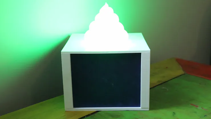

- On our Pi we check the name of the intent, and if it's 'Default Fallback Intent' we tell the lights to flash green, meaning no bull***. Otherwise we flash red, indicating bull****.

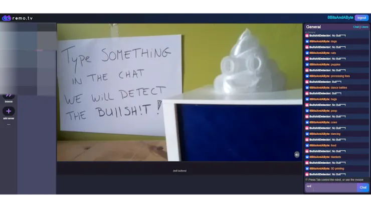

We can't keep something so powerful all to ourselves! So, we are going to make our detector available for everybody. To make this happen we are going to use Remo.tv, a robot streaming platform.
All we need to do is attach a Pi Camera and follow their setup instructions.
Once Remo.tv is set up, we will write our own chat handler. Instead of using Speech-To-Text we directly send the chat messages we receive on Remo.tv to Dialogflow. The rest of the logic remains the same. Just add a note in the background to tell visitors what they are looking at, and we're all done.
Result!
We successfully built a AI powered bull**** detector, which can learn from new input!
You can try it out yourself right here.
