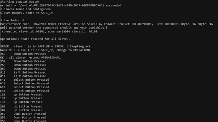

Running the Master Code:
On running the master code you get a result similar to the following,
_6gBceQugKU.gif?auto=compress&gifq=35&w=740&h=555&fit=max)
Results:
By now you would have successfully programmed the Arduino and Esmacat master !!! and the button pressed on the LCD Shield can be viewed on the display similar to the gif attachment at the start of this tutorial.
Output on Master Terminal:
The image below shows an example of pressing the corresponding buttons on the LCD on to the Master Terminal.
