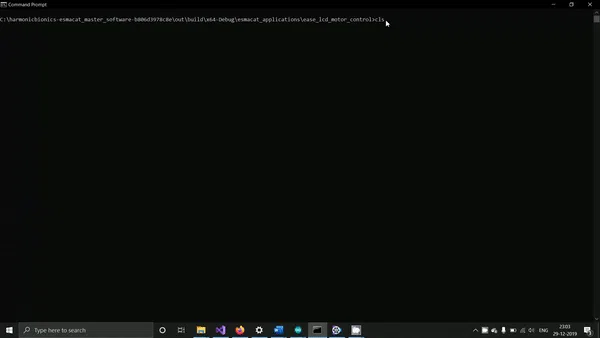

Running the Master Code:
On running the master code you get a result similar to the following on the Master terminal (the result attached below is an example result on execution on a Windows PC) with the motor selected and the desired position/speed change.
Results:
By now you have successfully programmed the 2 Arduino boards and the Esmacat master! The button (Up, Down & Select) pressed on the LCD Shield can be used to control the motors connected to the Motor Shield similar to the GIF attachment at the start of this tutorial and the video below.
