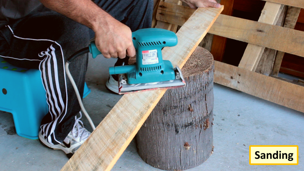

Lets start the project by sanding the planks to give them a nice and smooth texture.

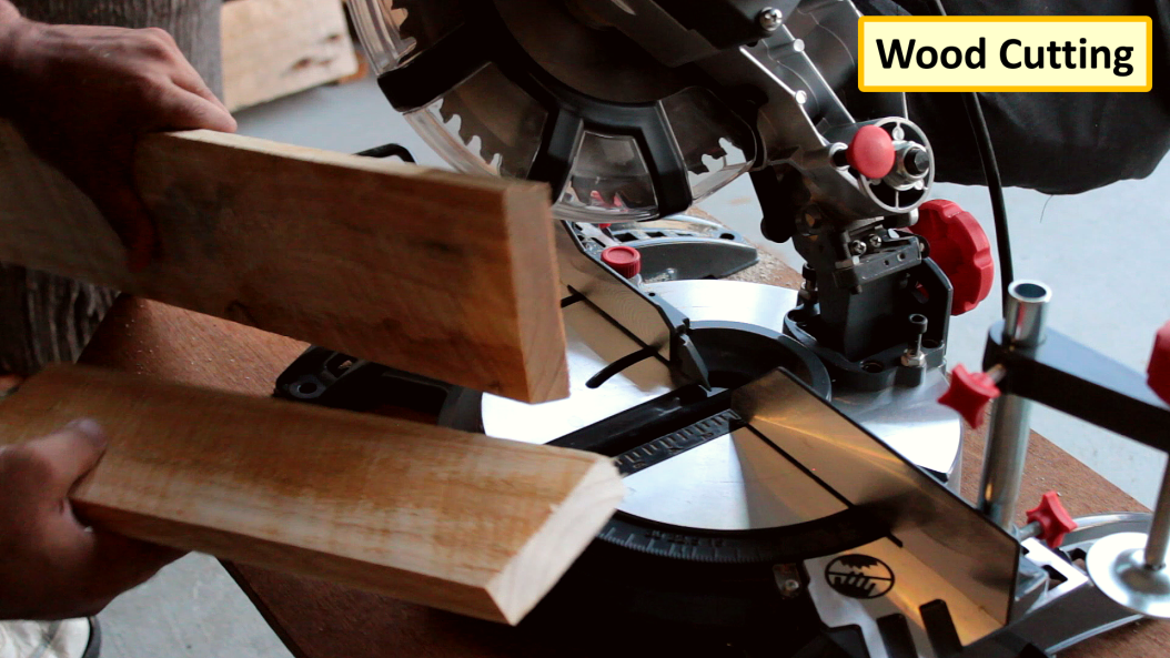

Next using a chop-saw, I am cutting the two sides, bottom and the top sections of the clock.

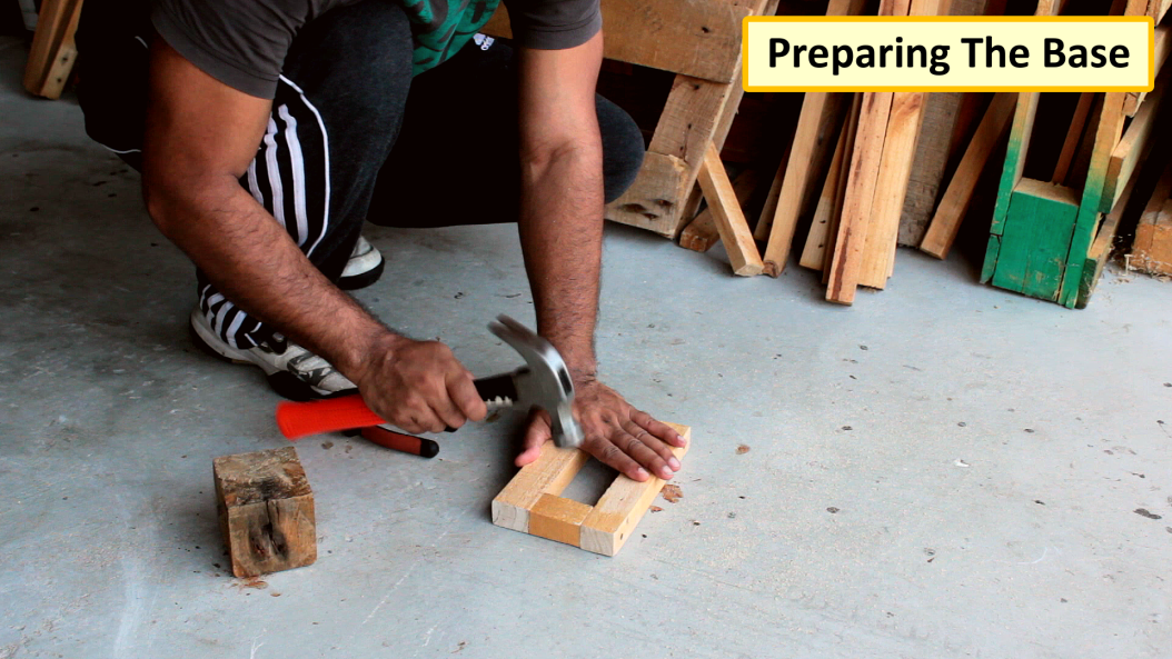

And using some of the leftover wooden blocks from my last project, I am preparing the base of the clock.
To fill in the gaps, I am adding a bit of PoP to the groves. However, as we all know two dis-similar materials like wood and plaster expand and contract at different rates. For any sort of permanence you need to isolate the movement of each relative to the other. This problem is commonly encountered when you paint the siding on a house. However, this clock is not going to move a lot and will not be placed outside the house so adding a bit of PoP would not really matter as long as I seal it properly.

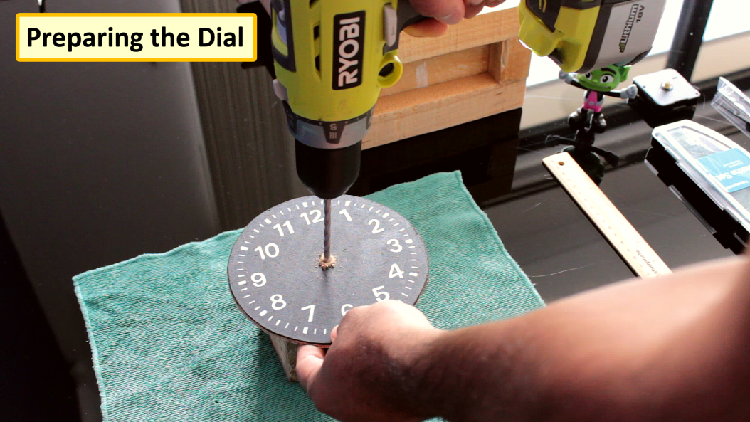

Preparing the Dial
I am preparing the dial of the clock using a board extracted from a broken chest's drawer.
My plan is to have a dark colored dial and a light colored housing for it. So, I am painting the dial black.
Now, for the numbering bit I am using a printed sheet as a stencil to transfer the numbers from the sheet over to the circular board.
Once all the numbers are transferred I am painting the graphite impressions with white color.
After giving the finishing touch, I am drilling a hole in the center of the circle and placing a $2 watch circuitry which I bought from Aliexpress.

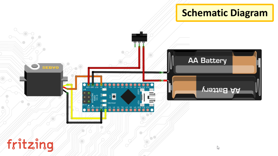

Circuit Diagram
This is how I have created the pendulums circuit.
Connect the servo to any one of the digital pins of the Arduino. Then connect the -ve to GND and +ve to the 5V output of Arduino.
Finally connect the -ve wire of the battery to GND and +ve to the VIN pin of Arduino placing the switch in the middle of the circuit.
This circuit diagram is for the pendulum only.

I will start by soldering the Arduino to the circuit plate.
Then, I am connecting the Servo to the digital Pin D2 and the -ve to GND and +ve to the 5V output of Arduino.
