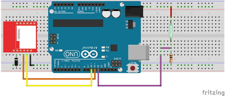

In several places, security systems are needed to protect rooms. For this, we need to install equipment that protects the place and, for example, generates an alert to notify that the room has been accessed by someone.
One way to solve this problem is to use the Arduino with the reed switch sensor. That is, when someone opens the door, a person will receive an alert via SMS on their cell phone.
This message will be sent through the SIM800L GSM Module. The circuit is presented in Figure 1.
Figure 1 - Circuit with SIM800L and Reed Switch to detect opened door.

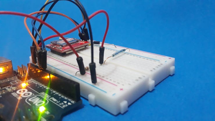

Firstly, we'll explain how works the project. You need to install your reed switch sensor and a magnet in your door. And hereafter, you'll connect the sensor in your Arduino System.
When the door is opened, the magnet will move away from the reed switch sensor and it will open. In this way, the system will detect that the door has been opened and will send a SMS through SIM800L for the user.
The circuit in the breadboard is presented below.
Figure 1 - Circuit to detect opened door in the Breadboard.
