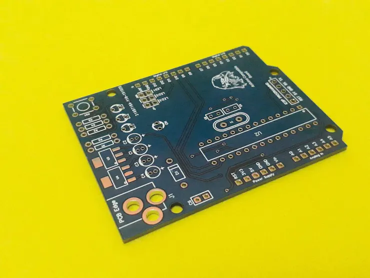

Print information on the Silkscreen layer of your PCB
The silkscreen layer is intended to print information and also your company logo. It is a layer that aims to print information on the bottom and top surfaces of your PCB design.
Thus, the silkscreen layer has some objectives such as:- Information of connections and elements of your board;- Assist in the manual assembly and maintenance process;- Aesthetics and design.
See, for example, the sign shown below.
Figure 7 - Example of silkscreen in PCB Design.
As you can see, there is a layer of texts, symbols, and images on the blue-colored region of this electronic board. All of these elements are printed on the silkscreen layer.
All of these texts will assist in the welding of components, as they all carry the name of the element (R1, R2, C1, U1) that must be welded in a certain position on your printed circuit board. In addition, it helps in the maintenance process, because in the future, a new user can access this information on the PCB and obtain the value of each component through the information of the silkscreen layer.
Therefore, always try to use the silkscreen layer. It will help you in the process of organizing your project information and in the assembly process.
