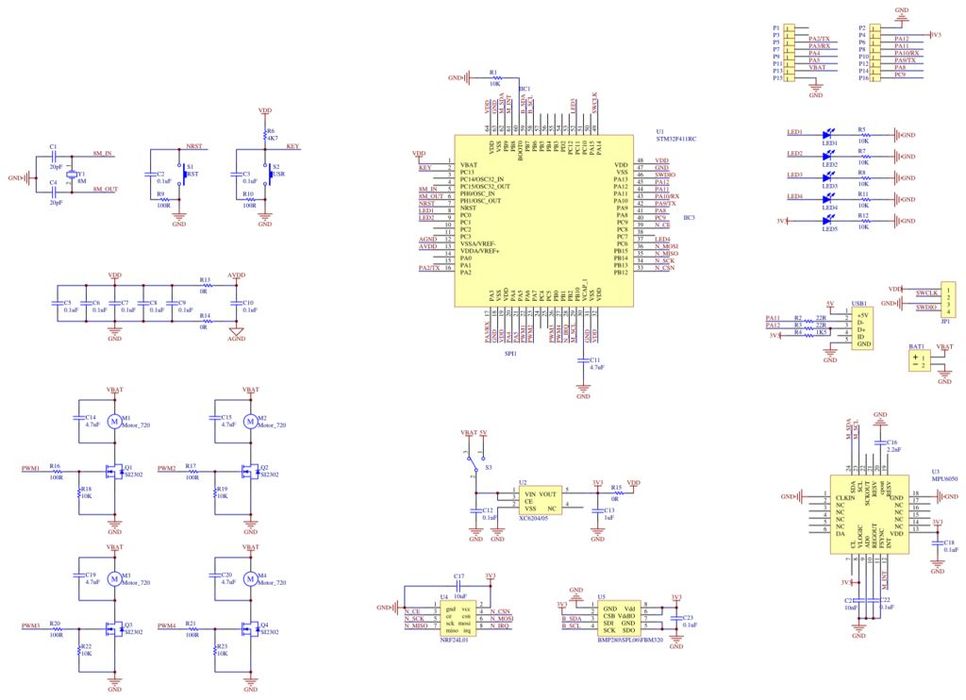

Step 2: Description
1. STM32F411RC as the main control, MPU6050, BMP280, and other sensors, nRF24L01 wireless communication mode of small four-axis aircraft.
2. The selected motor is 720 hollow cup motor, which supports 3.7v battery and USB power supply, leading to two rows of debugging pins.
3. NRF24L01 2.4g remote control, OLED real-time display of four-axis attitude, voltage return, secondary development
Step 3: Schematic Diagram
You can Re-edit it by EasyEDA which is quite simple and easy to use.
Step 4: PCB File
