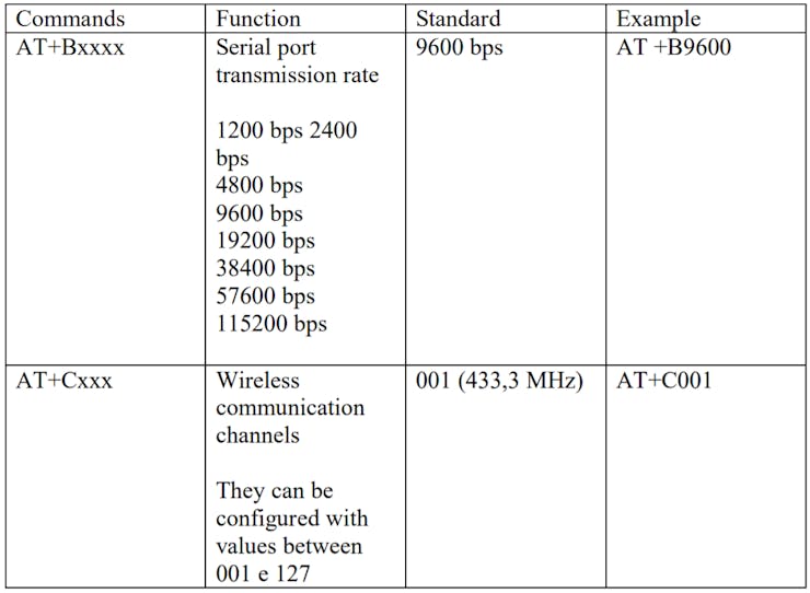

In order to carry out this process, we must adjust some parameters such as communication speed, communication channel, operating mode using AT commands.

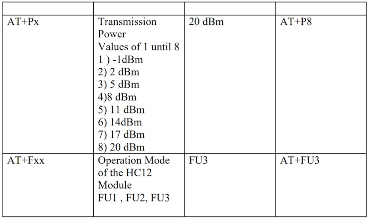

Table 1 shows the main commands used to configure the module using AT commands.
Table 1 - AT Commands to configure the HC12 Module.
The FU1 and FU2 modes have a lower power consumption than the FU3 mode, so the FU1 and FU2 modes are modes to be used in applications that use batteries.
The FU1 mode operates with electrical working current without transmitting 3.6 mA data.
The FU2 mode, on the other hand, operates with a working current of 80uA without transmitting data and supports only the speeds 1200 bps, 2400 bps, 4800 bps.
The operating modes are not compatible with each other, so the two modules must be configured in the same operating mode, whether FU1, FU2, FU3.
