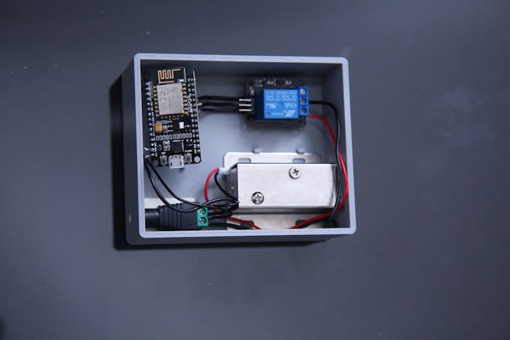

The NodeMCU
NodeMCU is an open source IoT platform. It includes firmware which runs on the ESP8266 Wi-Fi SoC from Espressif Systems, and hardware which is based on the ESP-12 module. In this project, NodeMCU forms the brain of the smart door lock. The NodeMCU retrieves data from the cloud database and makes the relay ON/OFF according to the data.
Or we can use an ESP8266 with the same code. Then use Arduino Uno to upload the code to ESP8266.
The Electric Lock Module
The electric door lock module operates at 12V which locks when the power is OFF and unlocks when the power is ON. It forms the physical part of the smart door lock.
The Relay
A relay is a switching device as it works to isolate or change the state of an electric circuit from one state to another. The 12V supply is given to the electric lock module using the Relay according to the data given by the NodeMCU.
Hardware Integration
Gather all the necessary components. Then solder them properly according to the given connection schema. I used a micro soldering station to control the temperature to avoid damage of NodeMCU while soldering. Be careful not to damage the MCU while soldering as high temperatures may damage the ICs.
The Enclosure
We have gathered all the components, connected them properly, and attached code with them. Now it's time to put them all together in an enclosure. The 3D design is made using Fusion 360 and printed at EazyFab. The design files are attached here.
Powering Up
We use the 12V 1A power supply to power up the NodeMCU as well the electric lock module. NodeMCU can't afford a direct 12V supply for a long time as it may damage the MCU. I used the 12V power supply just for a prototype. While building the product be sure to use a 5V power supply for the flawless working of the circuit.
