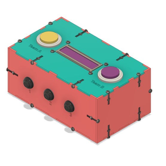

The figure below shows the structure of the fake bomb with Arduino.
Figure 1 - Arduino fake bomb for Airsoft and Paintball.
Below we will explain the complete structure of this pump. We will talk in detail about its operation and structure.

The fake bomb has a total of 5 buttons. We have 3 buttons to configure the operating mode and other parameters. These buttons are represented by buttons 1, 2, and 3, as shown below.
Figure 2 -

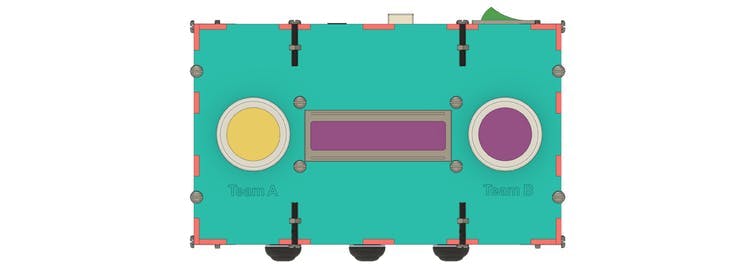

In addition to these buttons, we have the 2 buttons yellow and purple. These two buttons are used for the territory conquest mode. This modality will be discussed in this article.
Figure 3 -
The territory conquest modality has several devices scattered around the map and teams need to conquer and defend these territories.
The winning team is the one that occupied the largest number of territories in a given time programmed by the game judge.
For this modality, we use yellow and purple buttons.
Team A, for example, must press the yellow button for a programmed time. When that time passes, the territory is dominated.
This same process goes for the purple button of team B.
But make no mistake. This is not an easy task. In addition to conquering, they need to defend the territory.
That's when the adrenaline in Airsoft or Paintball starts. You need to fight and defend to dominate each territory in the game.
