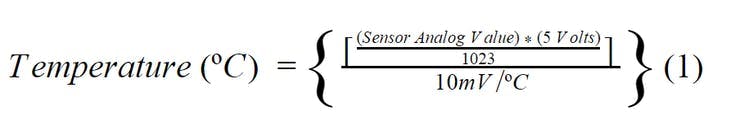

According to its datasheet, the sensor has a resolution of 10mV / ºC, that is, every 1 degree Celsius, it supplies 10 mV in its output. Equation 1 illustrates the conversion.
Equation 1 - Temperature Conversion on the LM35 Sensor. Source: Texas Instruments.
In this way, the Arduino captures the signal, so that it can be converted in a range from 0 to 1023 (analog value) into a signal from 0V to 5V (voltage signal).
After that, a linear interpolation is made between these values and it is possible to find the voltage value corresponding to the temperature captured by the sensor.
Finally, this value is divided by the resolution and thus the temperature value registered by the sensor is found. Figure 4 illustrates the LM35 temperature sensor.

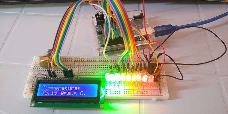

To set up the experiment, first, make sure that your Arduino is turned off by disconnecting it from the USB cable. Now, take the components and connect everything as shown in Figure 6 below.
Figure 3 - Wiring diagram for the proposed circuit.
The Led's circuit consists of 9 LEDs, 3 green, 3 yellow and 3 red, with their respective 220 Ω resistors. Each Led represents a variation of 5 degrees celsius, starting with the first green Led and ending with the last red Led.
Most LEDs were connected to digital pins so that the intensity of the pins would be maximum, however, 3 analog pins were used per quantity of LEDs, and for these, the value of 1023 representing the high logic level of the LEDs was used. digital pins.
As the LEDs are connected with the anode at 5Volts, all are activated with a low logic level on the connected pins.
The LCD display circuit will be the standard using the 4-bit connection (D4, D5, D6, and D7), together with the 10 kΩ potentiometers responsible for the contrast, and a 220 resist resistor connected to the anode pin.
The Arduino Uno will be responsible for processing the signal of the circuit as a whole and supply the power and reference for the protoboard bus, and thus supply the circuits of the developed project.

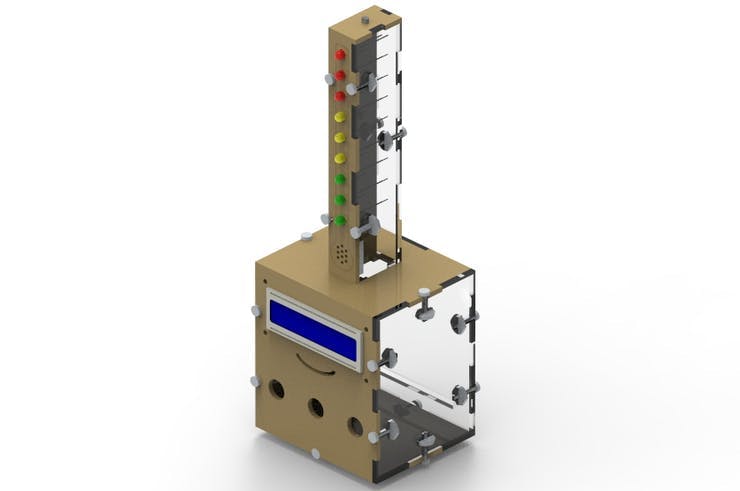

For this project, a proprietary case was developed, which will receive the LM35 temperature sensor, the LCD display, the Buzzer signal, the LEDs, leaving only the resistors and pins of the Arduino UNO remaining, so that it can be used in a didactic way, as shown in Figure 7.
Figure 4 - Mechanical Structure of the Termometer with Arduino.

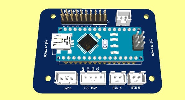

Developing the Printed Circuit Board
From the design of the thermometer with Arduino, a JLCPCB Printed Circuit Boardwas developed. The printed circuit board is shown in the figure below.
This board has an Arduino, 5 JST connectors, and a pin bar.
Three connectors are used to connect the structure buttons. In addition, we have JST connectors to connect the LCD Display and the LM35 temperature sensor.
Finally, we have a pin bar that allows us to connect the LED tower of the thermometer.
The printed circuit board circuit was developed from the electronic diagram below and you can download the files at the end of the article.
