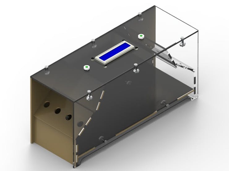

In the development of this didactic case it was using the Buzzer sound emitter, the LCD display, two indicative LEDs, and eight buttons, you will understand the structure developed.
The developed case was designed with the intention of supporting the Buzzer emitter, which will emit an audible signal according to the use of the keys by each player. In addition to the buzzer, we have an LCD display. He will be responsible for showing the score of the game. Finally, we have buttons that represent stone, paper, and scissors tools.
In this article, you will understand the assembly of the didactic case of the game, as well as know its mechanical structure, fixed by means of the nut bolt set, in its determined fittings.

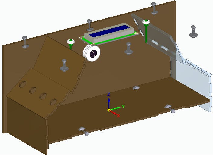

Figure 2 illustrates the internal region of the game case, as well as the screws responsible for fixing the lateral, front, rear, top, and bottom surfaces.
For the fixation of the structure, lateral supports were designed, with fittings dimensioned for M3 nuts and screws.
The support required for the LCD display uses 5 holes. Among them, 4 are used for the screws fixing the LCD itself and the last one will be necessary for your screen to be presented to users.
In addition to these holes, we have the holes for the buttons. They have a 12 mm diameter equally spaced, with 4 buttons for each participant.
Each button group will be at opposite ends of the designed case with a surface greater than the location of the buttons, thus ensuring that opponents do not see your opponent's option.
Figure 3 illustrates the holes for the participants' buttons.
Each participant will have 3 options, between stone, paper, or scissors, and the fourth button will be responsible for confirming the choice. Since the buttons are at opposite ends and covered by surfaces, each participant will not...
