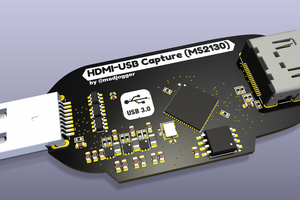

Hackaday.io Hackaday.io
Sign up Log in
nobotro os
Simple operating system with bootloader and mini kernel
mishamisha
Following Follow project
Liked Like project
Become a Hackaday.io member
Sign up with Github
Sign up with Twitter
OR
Forgot your password?
Just one more thing
Pick an awesome username
hackaday.io/
Pick a few interests
Choose more interests.
OK, I'm done! Skip
Join this project
255 views
3 comments
3 followers
1 likes
  • Description
  • Details
  • Files 0
  • Components 0
  • Logs 0
  • Instructions 0
  • Discussion 3
View Gallery
255
3
3
1
Team (2)
  • mishamisha
  • noahNoah
Join this project's team
  • nobotro os
completed project
Software
C os asm nobotro os
This project was created on 10/13/2020 and last updated 6 years ago.
Description
bootloader written in asm and mini kernel in c.it has protected mode ,gdt,simple video and keyboard driver,standart c librarys.
make all -to compile
make emu-to emulate in qemu
make flash-to write os in flash drive and check in real pc(!!!warning. use formated and empty usb drive.check usb drive path in make file before flash to avoid data los.in my case usb drive is in /dev/sdb )
Details
Log In/Sign up to comment
Become a Hackaday.io Member
Sign up with Github
Sign up with Twitter
OR
Noah wrote 10/15/2020 at 20:38 • point
i would love to be a contributor to this project! Got any room?
newblicious wrote 10/13/2020 at 20:20 • point
Very interesting. I love microkernels.
Have you shared your project on the OSdev forums?
misha wrote 10/14/2020 at 04:38 • point
No,didnot share to any forums
The chip is visible as a file on a USB flash drive
Project Owner Contributor
Raccoon Flash Explorer - STC8H8K64U spi-i2c prog
aaaaaaaaAaaaaaaa
Adding a internal USB hub and SDR to uConsole
Project Owner Contributor
The uConsole Implant
luis-rodriguezLuis Rodriguez
Mainline Linux kernel could live without MMU, and it has been ported to STM32 since kernel 4.2. Let's make an STM32 computer from scratch!
Project Owner Contributor
uc-PC, linux computer on stm32
hhuysqthhuysqt
Compact USB 3.0 HDMI capture module based on MacroSilicon MS2130. Implemented as a USB stick
Project Owner Contributor
MS2130: USB3.0 to HDMI
vitaly-kornilovVitaly Kornilov
Going up?
© 2026 Hackaday
Yes, delete it Cancel
You are about to report the project "nobotro os", please tell us the reason.
Send message
Remove Member
