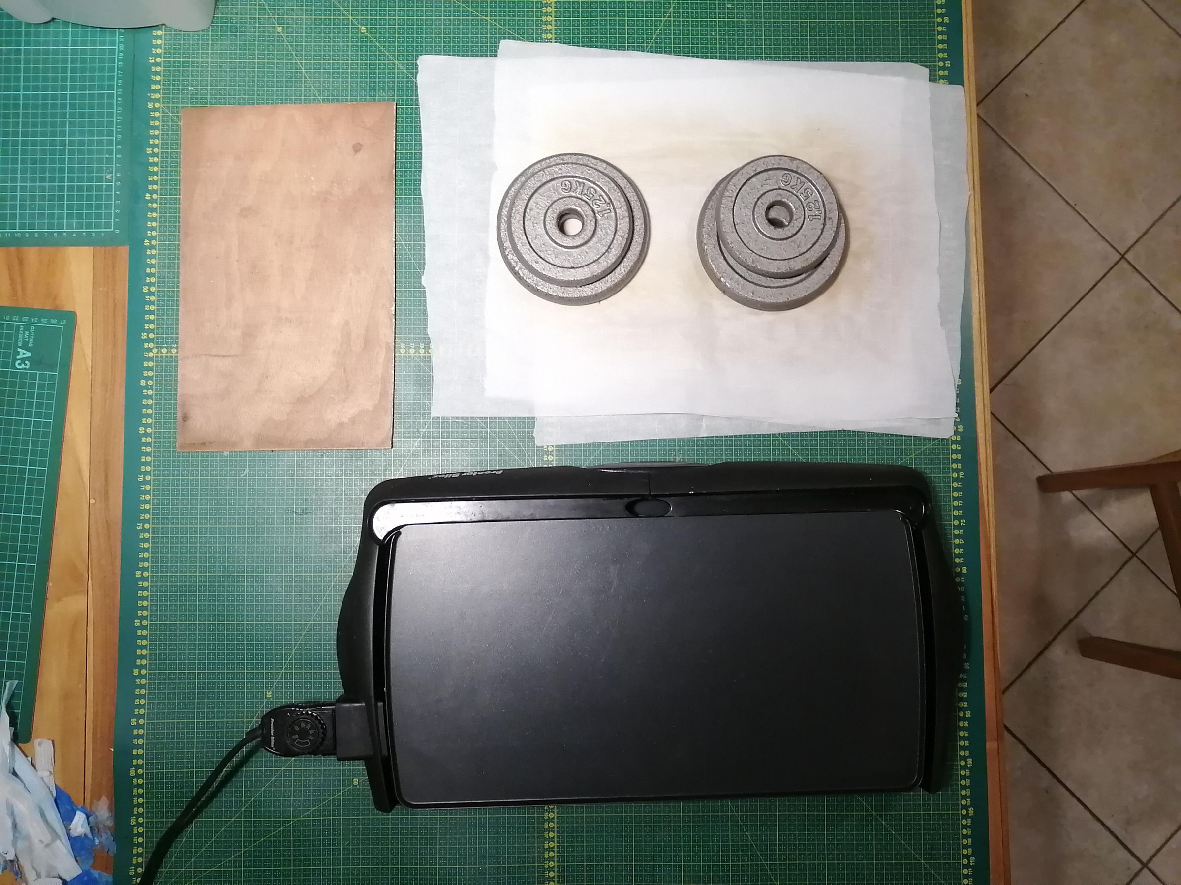

  • Better Heating through compression!
    blorgggg06/10/2022 at 18:29 0 comments
    Since we started this project, we have come across many better ways to consistently heat up the plastic. Now instead of just a hot plate,  we moved to a panini press, and then a t-shirt press. Each of these you can get for 100-200$ and the ability to squeeze your plastic more consistently does wonders!

    • Heat Source
      • I used an electric skillet
      • You could also use an oven or toaster oven

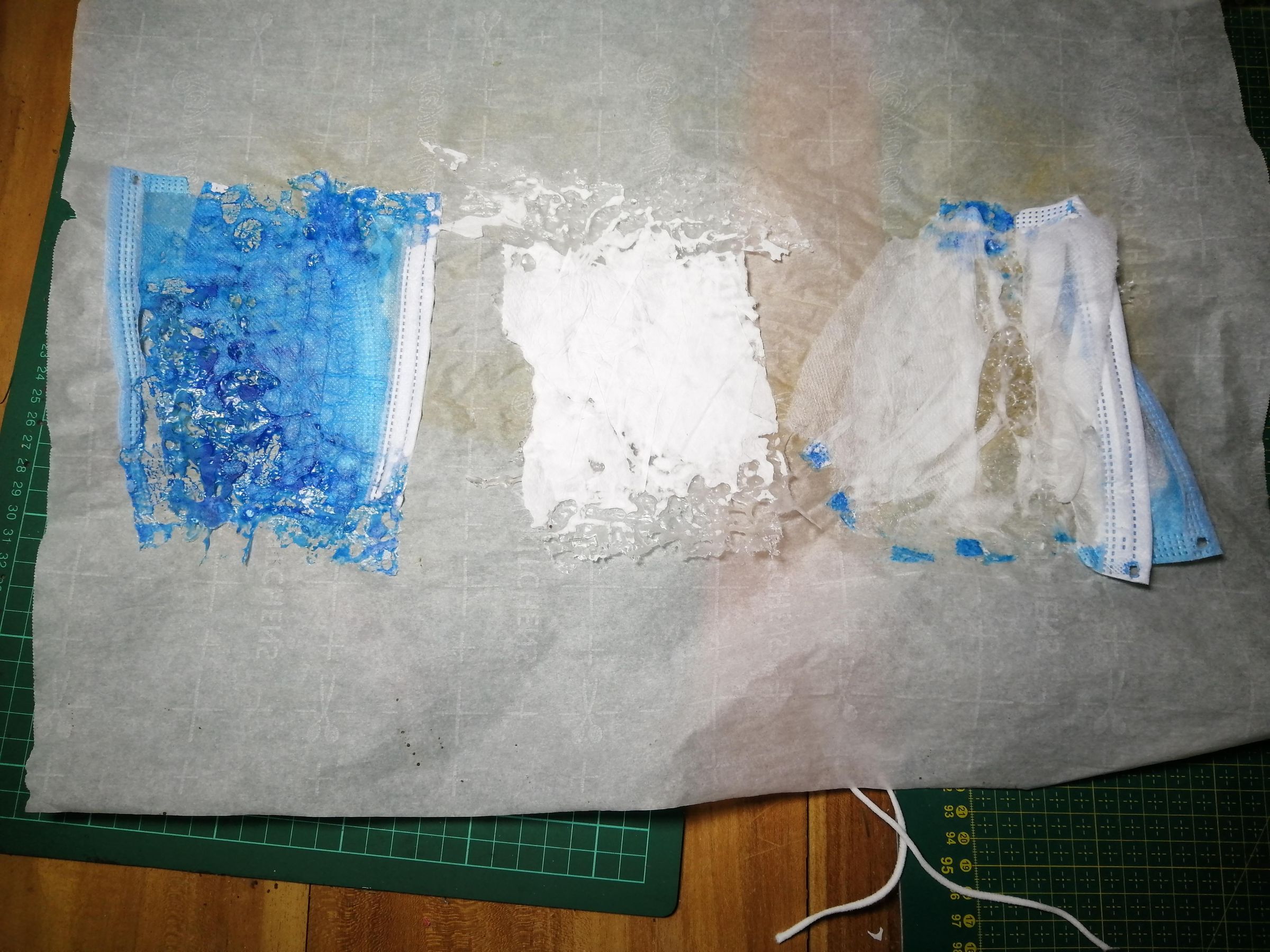

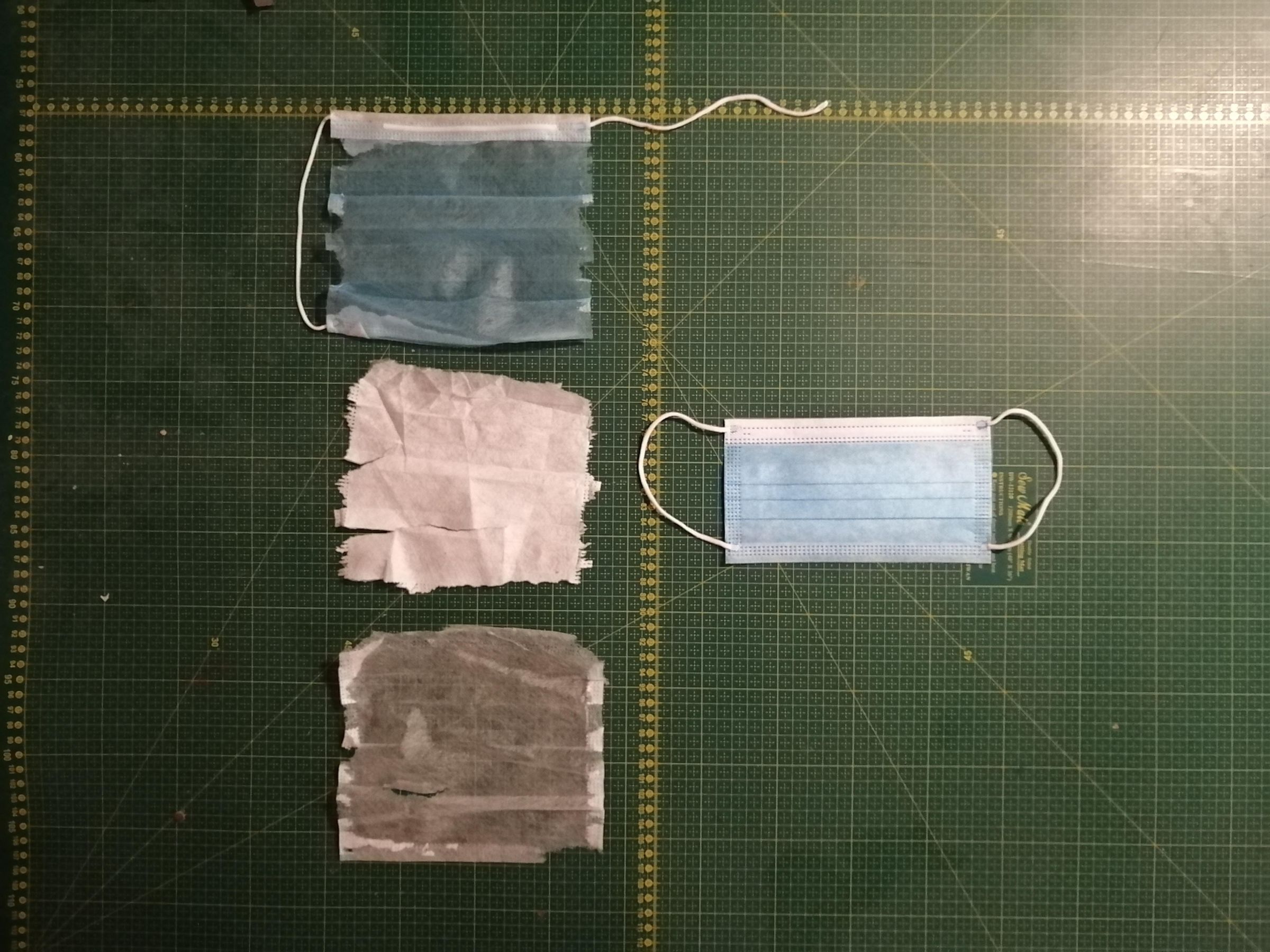

    Concept: Thermoplastics + 3 Layer Masks
    Most of the standard, blue masks you see have three layers. The pictures above show examples of melting down each of the three layers and how they come out.
    The two external layers are made from what they call "Melt Blown Polypropylene." This means in a factory somewhere, they have a bunch of polypropylene they heat up, and squeeze through a whole bunch of tiny holes while blowing air at them. This creates this nice random, static-y, fluffy material with VERY SMALL HOLES that is good at stopping particles and liquids.
    External Layers The mask factory takes sheets of this fluffy polypropylene and slice them up to make the two exterior layers of your normal blue mask. These layers are hydrophobic and the main goal seems to be to keep your fluids in with you, and keep others fluids out. A cool thing about polyproylene is that it is a THERMOPLASTIC. This means you can melt it, put it in a shape, re-melt, and re-shape, (almost) as much as you want! This is how things like 3D printing work! It's also how plastic recycling in general works (Like all the great projects with the fine folks at https://preciousplastic.com/ ): you chop up certain types of plastic, melt it down, and re-use to make other projects.
    Inside Layer (Problem Material!)
    The center sheet is some kind of other material. It's hydrophillic and made to absorb moisture. The concept seems to be that any wet stuff that makes it through the outer layers gets absorbed in this layer. This is also why this layer tends to get mold and gross if you keep re-using the mask. This center layer is also the one that gives us some problems. We can't just melt down all three layers of the mask together, or we end up with a weak, brittle plastic.
