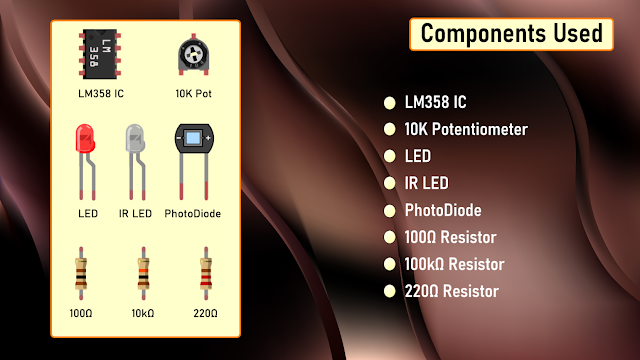

Components Used
For this project we need:
  • 1 x LM358 IC
  • 1 x 10K Potentiometer
  • 1 x LED
  • 1 x IR LED
  • 1 x PhotoDiode
  • 1 x 100Ω Resistor
  • 1 x 100kΩ Resistor
  • 1 x 220Ω Resistor

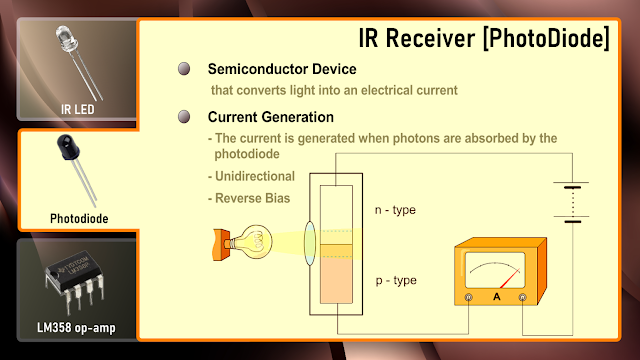

2. IR Receiver [PhotoDiode]
 A photodiode is a semiconductor device that converts light into an electrical current. The current is generated when photons are absorbed by the photodiode similar to a Light Dependent Resistor (LDR), means it has very High Resistance in absence of light and the Resistance become low when light falls on it. However, unlike the LDR which is analogue and bidirectional, Photodiode is a unidirectional semiconductor which has a P-N junction and operates in Reverse Bias (means it start conducting the current in reverse direction when Light falls on it). Photodiodes can only do two values: either on or off.
Photodiodes also looks like a LED, with a Black color coating on its outer surface. Different types of IR receivers exist based on the wavelength, voltage, package, etc. When used in an infrared transmitter – receiver combination, the wavelength of the receiver should match that of the transmitter.
