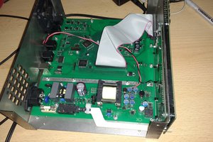

The driver of the show is the FPGA, it's a 10M08SAE144I7G from the Altera MAX10 Series. MAX10 devices are cool because they have a built-in configuration flash memory and some UFM (User Flash Memory) that can be written when the FPGA is programmed to store non-volatile data. This project uses the UFM to store code for the CPU.
The clock is provided by a 10Mhz TCXO oscillator, a potentiometer connected to the adj. pin is used to adjust the frequency.
First, the signal is generated digitally inside the FPGA, then it goes into a 12bit R2R DAC that converts it to an analog voltage. The signal then passes through an inverting op-amp where a DC offset is added. After that, there's a VGA to control the output level. The signal is then filtered by an active op-amp filter before entering the final amplifier.
