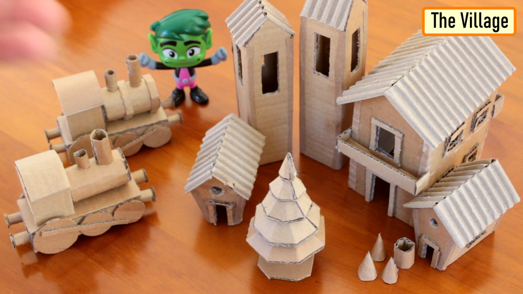

To create the cardboard village we need:
- Cardboard Sheets
- A4 Paper
- Permanent Marker or Pen
- Scissor and a Knife
- Hot Glue Gun or Wood Glue
Adding a bit color would have made my project even more attractive however I just left it all in white.
Paper Templates
I created 2 x PDF files with all the measurements in it. The links to the PDF files is in the description below. After printing the PDFs on A4 sheet, I extracted the shapes from it using a paper cutting scissor.

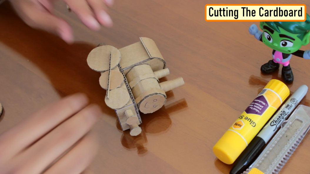

Cutting The Cardboard
Then I traced the paper-cutouts on pieces of cardboard and using both scissor and knife I extracted all the pieces of cardboard that I need for this project.
Using a hot-glue gun I joined all the cardboard cutouts.
Be very careful while using a hot-glue gun. Use gloves as much as possible to avoid the hot glue from burning your hand and fingers.
By using wood-glue instead of hot-glue you can get a cleaner and stronger finish, but hot glue is faster. Hot glue can also be more forgiving as you can re-heat and re-glue if you're unsatisfied with your seam.
Try applying the glue from the inner side as much as possible to leave the outer side neat and clean.

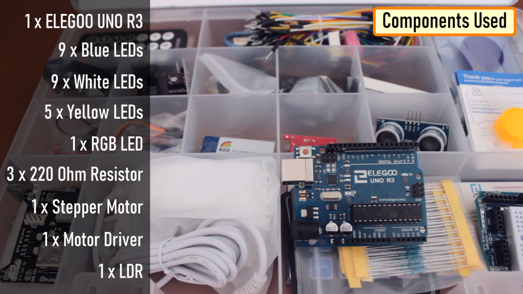

Components Used [Electronics]
Now for the Electronics bit we need the "The Most Complete Starter Kit from ELEGOO".
This kit has all the components that are required for this project.
- 1 x ELEGOO UNO R3
- 9 x Blue LEDs
- 9 x White LEDs
- 5 x Yellow LEDs
- 1 x RGB LED
- 3 x 220 Ohm Resistor
- 1 x Stepper Motor
- 1 x Stepper Motor Driver
- 1 x LDR

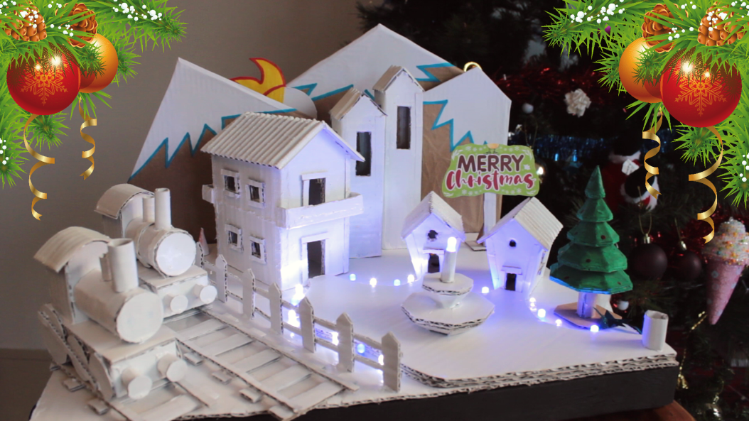

Adding LEDs
Using the soldering iron I made few holes around the pathway. These holes are for the Blue and White LEDs which will blink alternately. Adding RGB-LEDs would have definitely given this a better look and feel.
Next, I added a RGB-LED to the water-feature. Later, I will add a bit of cotton on top of this which may look like flowing water.

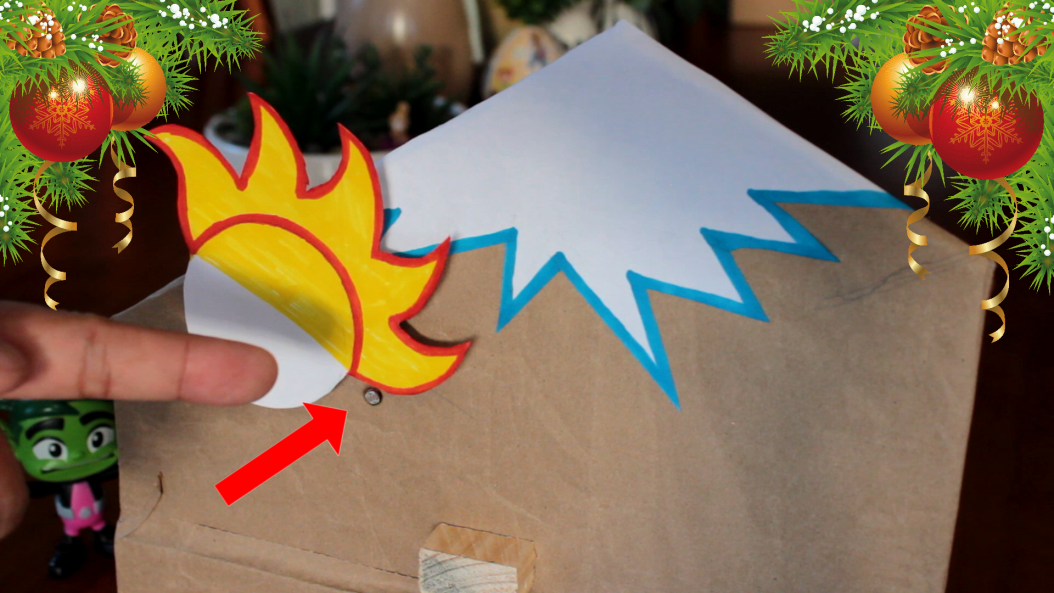

SUN & MOON
So, this is how the final setup looks like. I added some hills at the back for the rising and setting of the sun and the moon.
The logic is very simple.
A DC-Motor or Stepper-Motor rotates the Half Sun and Half Moon. A LDR is placed in a way that the Sun rays can cover it up.
When the moon side is up the sun rays cove the LDR and vice-versa. This LDR acts as a switch and turns on and off the blue and white flashing LEDs. With the same logic you can go even more...
