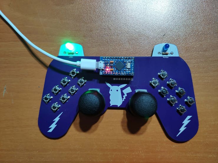

After completing my design on a breadboard and testing the code, I designed a controller-shaped PCB (Arduino-Based Mouse and Keyboard Controller) with an integrated 4x4 matrix keypad and two embedded joysticks, displaying Pikachu as its center logo :)

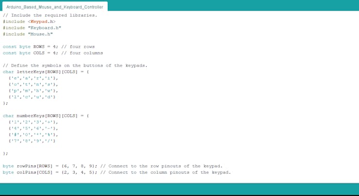

⭐ Include the required libraries.
Keypad | Library
Keyboard | Library
Mouse | Library
⭐ Define the symbols on the buttons of the dynamic keypad options - letter and number.

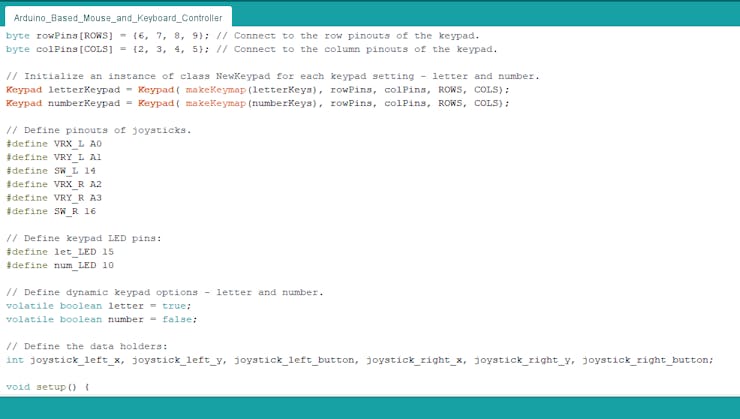

⭐ Initialize the dynamic keypads.
char letterKeys[ROWS][COLS] = { {'e','a','r','i'}, {'o','t','n','s'}, {'p','m','h','w'}, {'l','c','u','d'}};char numberKeys[ROWS][COLS] = { {'1','2','3','+'}, {'4','5','6','-'}, {'#','0','*','%'}, {'7','8','9','/'}};byte rowPins[ROWS] = {6, 7, 8, 9}; // Connect to the row pinouts of the keypad.byte colPins[COLS] = {2, 3, 4, 5}; // Connect to the column pinouts of the keypad.// Initialize an instance of class NewKeypad for each keypad setting - letter and number.Keypad letterKeypad = Keypad( makeKeymap(letterKeys), rowPins, colPins, ROWS, COLS);Keypad numberKeypad = Keypad( makeKeymap(numberKeys), rowPins, colPins, ROWS, COLS);

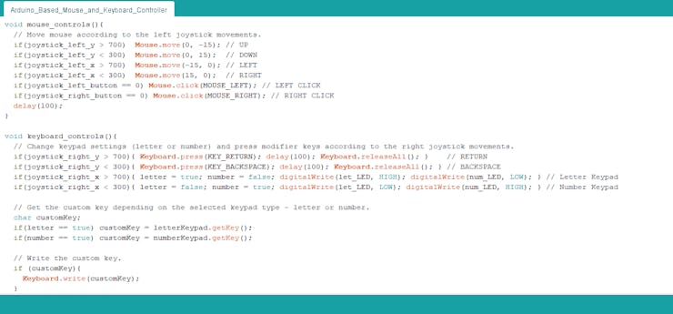

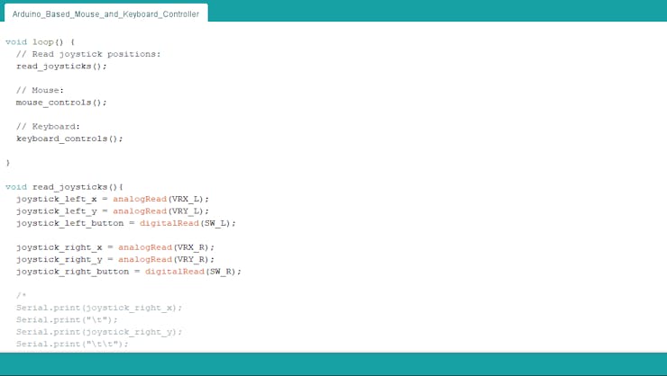

⭐ In the read_joysticks() function, collect the data generated by joysticks - J1 and J2.
void read_joysticks(){ joystick_left_x = analogRead(VRX_L); joystick_left_y = analogRead(VRY_L); joystick_left_button = digitalRead(SW_L); joystick_right_x = analogRead(VRX_R); joystick_right_y = analogRead(VRY_R); joystick_right_button = digitalRead(SW_R);}
⭐ In the mouse_controls() function, move the cursor according to the left joystick (J1) movements and click using the left (J1) and right (J2) joysticks.
void mouse_controls(){ // Move mouse according to the left joystick movements. if(joystick_left_y > 700) Mouse.move(0, -15); // UP if(joystick_left_y < 300) Mouse.move(0, 15); // DOWN if(joystick_left_x > 700) Mouse.move(-15, 0); // LEFT if(joystick_left_x < 300) Mouse.move(15, 0); // RIGHT if(joystick_left_button == 0) Mouse.click(MOUSE_LEFT); // LEFT CLICK if(joystick_right_button == 0) Mouse.click(MOUSE_RIGHT); // RIGHT CLICK delay(100);}
⭐ In the keyboard_controls() function, change dynamic keypad settings (letter or number) and press modifier keys (RETURN and BACKSPACE) according to the right joystick (J2) movements.
⭐ Get the custom key depending on the selected dynamic keypad option - letter or number - and write the custom key as a keyboard key.
void keyboard_controls(){ // Change keypad settings (letter or number) and press modifier keys according to the right joystick movements. if(joystick_right_y > 700){ Keyboard.press(KEY_RETURN); delay(100); Keyboard.releaseAll(); } // RETURN if(joystick_right_y < 300){ Keyboard.press(KEY_BACKSPACE); delay(100); Keyboard.releaseAll(); } // BACKSPACE if(joystick_right_x > 700){ letter = true; number = false; digitalWrite(let_LED, HIGH); digitalWrite(num_LED, LOW); } // Letter Keypad if(joystick_right_x < 300){ letter = false; number = true; digitalWrite(let_LED, LOW); digitalWrite(num_LED, HIGH); } // Number Keypad // Get the custom key depending on the selected keypad type - letter or number. char customKey; if(letter == true) customKey = letterKeypad.getKey(); if(number == true) customKey = numberKeypad.getKey(); // Write the custom key. if (customKey){ Keyboard.write(customKey); }}
Connections and Adjustments
// Connections// Arduino Pro Micro : // JoyStick (Left)// A0 --------------------------- VRX// A1 --------------------------- VRY// D14 --------------------------- SW// 5V --------------------------- 5V// GND --------------------------- GND// JoyStick (Right)// A2 --------------------------- VRX// A3 --------------------------- VRY// D16 --------------------------- SW// 5V --------------------------- 5V// GND --------------------------- GND// KeyPad// D2 --------------------------- C1// D3 --------------------------- C2// D4 --------------------------- C3// D5 --------------------------- C4// D6 --------------------------- R1// D7 --------------------------- R2// D8 --------------------------- R3// D9 --------------------------- R4// Letter Keypad LED// D15 --------------------------- +// Number Keypad LED// D10 --------------------------- +

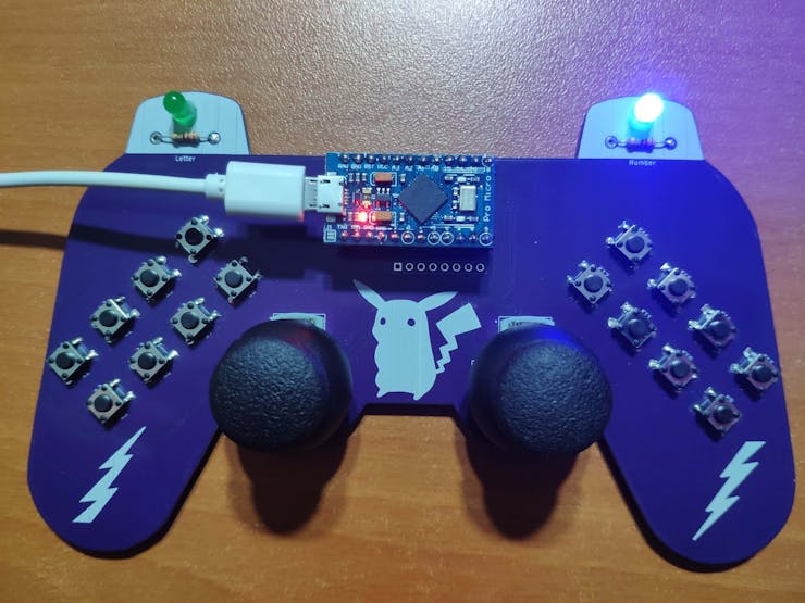

After finishing and uploading the code to the Arduino Pro Micro, I attached it to the PCB via headers.
Modes and Features
🎮 The controller lets the user move the cursor by the left joystick (J1) movements and click by pressing the left (J1) or right (J2) joystick buttons.
- J1 > Left > Cursor to Left
- J1 > Right > Cursor to Right
- J1 > Up > Cursor to Up
- J1 > Down > Cursor to Down
- J1 > Button > Mouse Left Click
- J2 > Button > Mouse Right Click
🎮 The controller allows the user to choose between the dynamic keypad options (letter and number) and send modifier keys by the right joystick (J2) movements.
- J2 > Left > Letter Keypad
- J2 > Right > Number Keypad
- J2 > Up > RETURN
- J2 > Down > BACKSPACE
🎮 The controller includes an integrated 4x4 matrix keypad. With the dynamic keypad options, the controller supports up to 32 keyboard keys.
