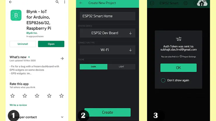

Configure the Blynk App for This ESP32 Project
1. Install the Blynk App from the Google play store or App store. Then create an account and tap on the New Project.
2. Give the name to the project, select ESP32 Dev Board, Connection type will be WiFi. Then tap on Create.
3. Blynk will send an authentication token to the registered email id. Tap on OK.

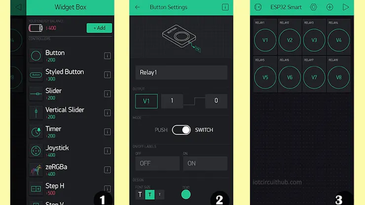

Add the Button Widgets in Blynk App
Then add 8 button widgets to control the 8 relays.
Here I have used virtual pins V1, V2, V3, V4, V5, V6, V7, V8 for 8 buttons. And mode will be Switch.

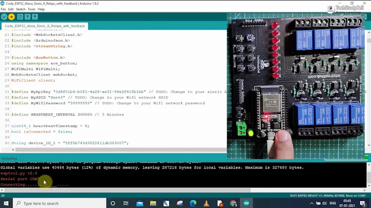

Program ESP32 Using Arduino IDE
Download the code.
First, you have to install the required libraries. I have shared all the links in the code.
- Bluetooth serial: https://github.com/espressif/arduino-esp32/tree/m...
- AceButton Library: https://github.com/bxparks/AceButton
- Blynk Library: https://github.com/blynkkk/blynk-library/releases...
Then enter the WiFi name, WiFi password & Blynk AuthToken in the code.
- #define AUTH "AUTH TOKEN" // You should get Auth Token in the Blynk App.
- #define WIFI_SSID "WiFi Name" //Enter Wifi Name
- #define WIFI_PASS "WiFi Password" //Enter wifi Password

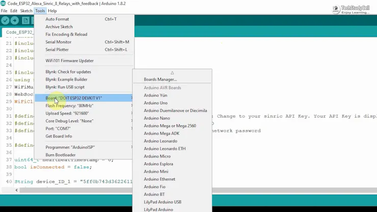

After that select the DOIT ESP32 DEVKIT V1 board and the PORT. Then click on the upload button.
While uploading if you see the "Connecting.....___" text, press the BOOT button of ESP32.

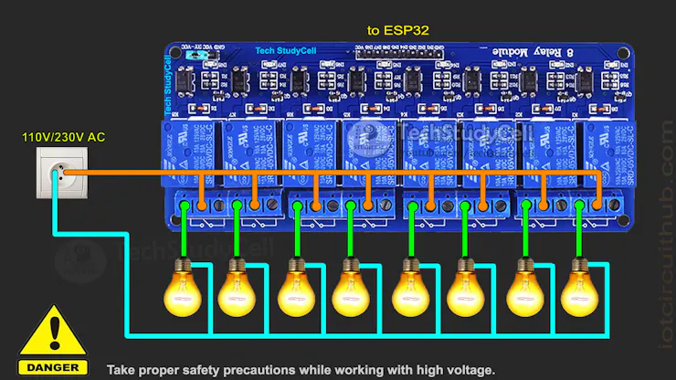

Connect the Home Appliances
Connect the 8 home appliances as per the circuit diagram. Please take proper safety precautions while working with high voltage.
