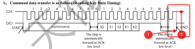

    As said earlier in the log, we can't "call" since it doesn't have one. And trying to distinguish "sending only command" and "sending command + data" could be a tedious work. What is tried is to separate these two using two separate state machines, but it ends up breaking the signal (the circled one showing the spurious pulses in the CLK line):
    To provide a temporary fix, it has to push both command + command and command + data pairs to the TM1637 using the PIO.

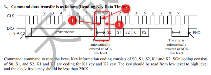

    This little display module is very common and being sold everywhere. Thousands of Arduino projects are possibly using these too.
    The very strange part is, despite this is using the 2-wire interface, it isn't any I2C! Connecting this and expecting it to work like I2C will not get you anywhere!
    Why? It's simple - this thing is a modified I2C interface. Its I2C address isn't there:
    Obviously, we got to bit-bang it. That's the first thing to do.

    Acknowledge bit:
    _ackCond:
       set pins, 0 side 0  ; (1)
       nop side 1          ; (2)
       nop side 0 [1]      ; (3)
    Again, this PIO code mimics how to perform that ACK bit.
