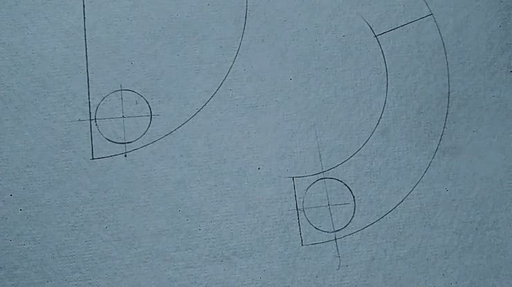

Download the attached PDF file for complete dimension of machine
Bring some cardboard pieces draft the model as per given dimension on cardboard sheet
carefully cut those pieces make sure are accurately cutted to avoid any malfunction during machine run.
Glue all the parts as shown in figure,
To make transparent feed tube i used empty cold drink bottle cut it and took a piece out of it
and fold that sheet in tube like shape and secure with transparent, keep the diameter of tube according to the size of candy so they can pass through it easily at same time not also very loose..

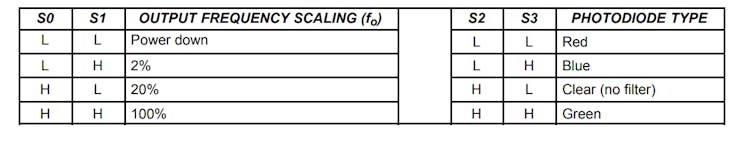

The TCS230 programmable color light-to-frequency converter combines configurable silicon photodiodes and
a current-to-frequency converter on single monolithic CMOS integrated circuit. The output is a square wave (50% duty cycle) with frequency directly proportional to light intensity (irradiance). The full-scale output frequency can be scaled by one of three preset values via two control input pins. Digital inputs and digital output allow direct interface to a microcontroller or other logic circuitry. Output enable (OE) places the output in the high-impedance state for multiple-unit sharing of a microcontroller input line. The light-to-frequency converter reads an 8 x 8 array of photodiodes. Sixteen photodiodes have blue filters, 16 photodiodes have green filters, 16 photodiodes have red filters, and 16 photodiodes are clear with no filters. The four types (colors) of photodiodes are interdigitated to minimize the effect of non-uniformity of incident irradiance. All 16 photodiodes of the same color are connected in parallel and which type of photodiode the device uses during operation is pin-selectable. Photodiodes are 120 µm x 120 µm in size and are on 144-µm centers.
