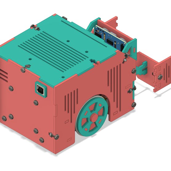

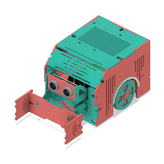

The ARGUS Robot Structure
The ARGUS robot can work autonomously or remotely controlled via commands sent via Bluetooth.
Autonomous operation
In its autonomous mode, ARGUS is used to avoid obstacles through the use of the ultrasonic sensor. He is able to navigate in any environment.

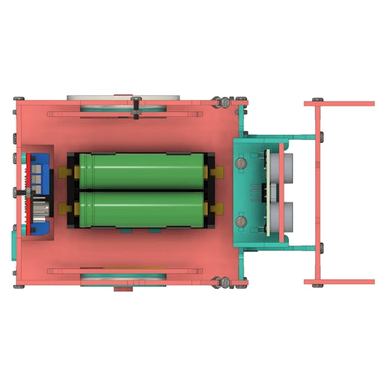

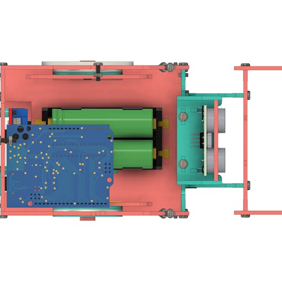

ARGUS uses an Arduino UNO as the control board for your entire system.

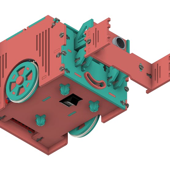

The Argus is a robot designed to have the characteristic of a toy. Most of the toys have a system to turn on and off with a button on the bottom of the robot floor.
This structure was implemented and added to the body of ARGUS. See the figure below and observe the structure of the aforementioned button.
The ARGUS is powered by a 7.5V / 2.6Ah battery. This battery energizes the entire system and allows the ARGUS to run for 3 hours and 30 minutes.
This time is sufficient for him to participate in any competition.
The battery is responsible for powering the Arduino and the wheel motors. The Arduino is responsible for all navigation control of the robot.
It reads the ultrasonic sensor, receives user commands, and activates the robot's motors. The motors are the most used elements that need the most energy consumption in the project. For this reason, we created a space for the installation of 2 LiPo 18650 batteries.
See the circuit presented below with Arduino Board and Battery.

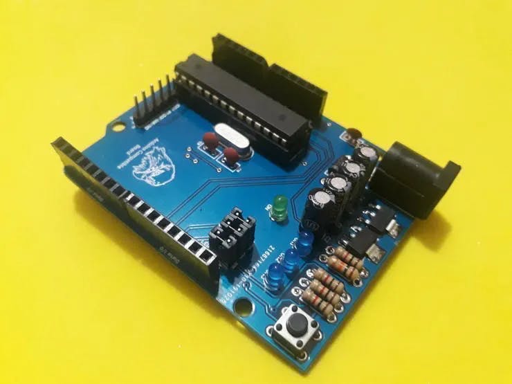

In addition to the Arduino UNO, we provide an Arduino for you to download and assemble your project. You just won this Arduino!
Use the JLCPCB Arduino Compatible printed circuit board presented below.
You can obtain the Arduino JLCPCB compatible PCB for your projects for $2 in your first order with the link: Earn my PCBs Arduino Compatible.
Use the JLC-RECE coupon,earn a $2 off discount, and earn FREE5 PCBs.
Access the link and download the Gerber files of the JLCPCB Arduino Compatible Printed Circuit Board.
ARGUS has access to the Arduino UNO's USB port. This allows the programming of the robot without the need to remove the Arduino Board from the inside of the robot.
