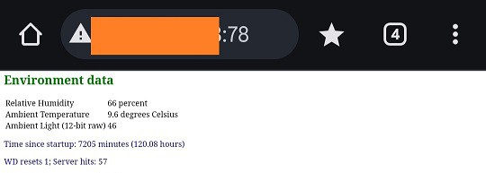

Prototypes are also used for relative humidity readings with HIH 4020 sensor (only as IoT version essentially). Parts of the already created algorithm had to be enhanced and modified for this obviously (see links to my github repo).
A basic output in a web browser (as to the ambient light sensor, see project log):
Note:  for the IoT-server there are a few ad-hoc robustness measures in place, such as activating the HW watchdog and not using standard http port 80. Security is not implemented (SSL/TLS), so I would advice against making such a device accessible to the wider world.
