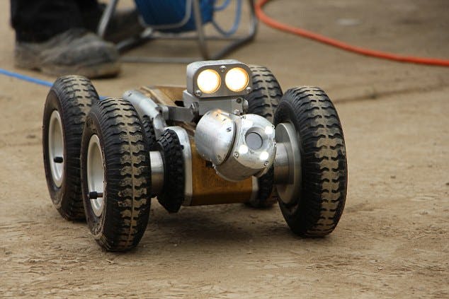

Your robot with wheels will not work on some terrains! Read on to understand this problem and how to resolve it. Most mobile robots are built with wheels.
See the robot with wheels presented below.
They are great for navigation on flat terrain and with few irregularities, but present great difficulties for operations on terrain with high irregularity.
Why does this defect happen with robot with wheels, and what are its consequences?
This is because the wheels lock or slide on the surface of the terrain. This prevents the robot from moving and arriving at its destination.
In addition, the wheels cannot overcome large obstacles on the ground. For this, the robot with wheels would need to be twice the size of the obstacle and this would make the wheel structure unfeasible to be built.

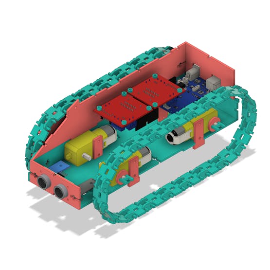

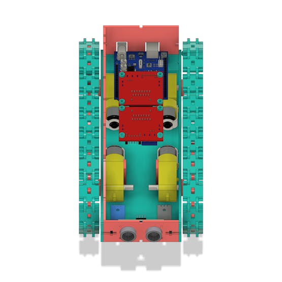

The project was built in the shape of a tank and its internal structure has all the electronic components that will process the signal and perform the displacement of the robot.
Figure 2 illustrates the robot's internal region.
In its lower internal structure, it is possible to observe the 4 motors (each with two lateral supports) and their respective sprockets, as well as the two line-following sensors.

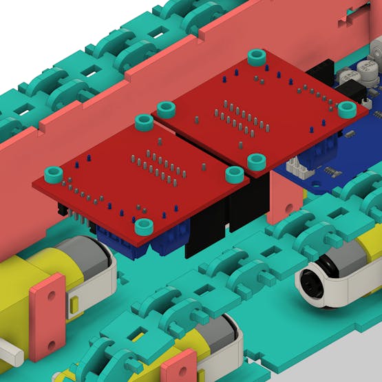

The DC motors and driver
The robot consists of 4 motors and two drive drivers. See the figure below.
The drivers are responsible for receiving the command signals from the Arduino and activating / deactivating the motors. For each pair of engines we will use an L293D driver.
This driver can control from the speed of the robot's sprockets through the PWM pins of the Arduino, to the direction of rotation, being able to control up to two DC motors.
The drivers were installed on the inner ceiling surface, next to the Arduino Uno.

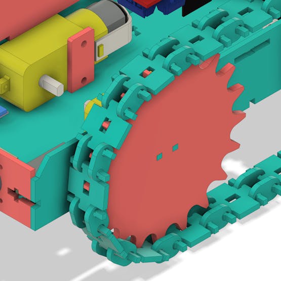

The motors are coupled to a sprocket. It is responsible for transmitting the movement to the conveyor, which is attached to its structure.

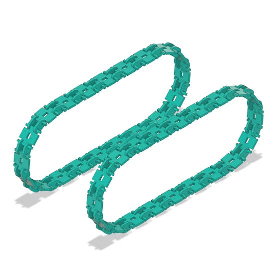

The structure of the track is shown below. It was built from the coupling of several parts.
This structure is basically divided into two categories: the link and the wheel connection. The connection is responsible for connecting the cogwheel, and they unite them.
Figure 5 illustrates the mechanism of the links, connections, and sprocket. The connections are responsible for engaging the teeth of the wheels, thus allowing the engine, when turning the wheel, to displace this mechanism.
The links are responsible for joining each connection to others, allowing the displacement of the system to be possible.
Each link and connection was modeled in order to fit “justly” in order to ensure the maximum stability of the mechanism. Along with the links and connections, the sprockets are the means used by the tank for its displacement.

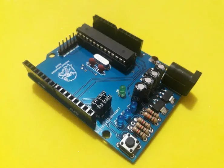

The control board of the track robot
The control board is shown below and has the Arduino UNO format. All sensors and drive drivers will be connected in their structure.
The control board is responsible for receiving control commands via Bluetooth or sensors. Based on the information received, it will activate the drivers so that the motors can move the robot in a certain direction.
Did you win the files on that board? Follow this process and get 5 free units. It is easy to assemble!
You must follow all of these steps below.
- Download the robot control board file
- Enter in this website and make your account.
- Add the control board files to the website
- Add the JLC-REBE discount coupon to the payment section
- Ready, you won 5 free PCB units.

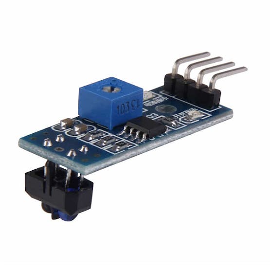

The track robot has 2 types of sensors in its structure. It has a reflective sensor and an ultrasonic sensor. See the figure presented below.
1 / 2
The robot has 2 TCRT5000 sensors and one ultrasonic sensor.
The TCRT5000 sensor is used to detect holes in the ground, follow lines and detect when the robot is on the ground working.
The ultrasonic sensor is used to allow the robot to avoid obstacles. The Arduino fires the sensor and waits for the received signal. From that time between firing and receiving it is possible to determine the distance between the Arduino and the target.

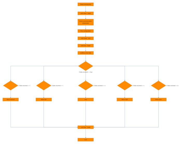

Programming logic for the operation of the robot
The robot structure can be used with different programming logic. The robot has internal space to install other modules and be controlled autonomously or remotely by commands via bluetooth, or wifi.
Use the programming logic below to control your track robot remotely with bluetooth commands.

Use the JLCPCB Arduino Compatible printed circuit board presented below.
You can obtain the Arduino JLCPCB compatible PCB for your projects in your first order with the link: Earn my PCBs Arduino Compatible.
Use the JLC-RECE coupon, earn a $2 off discount, and earn FREE5 PCBs.
