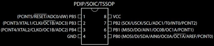

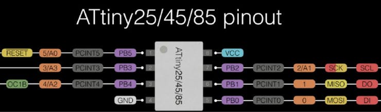

ATTiny85 Arduino Pinout
Datasheet Pinout of ATtiny85

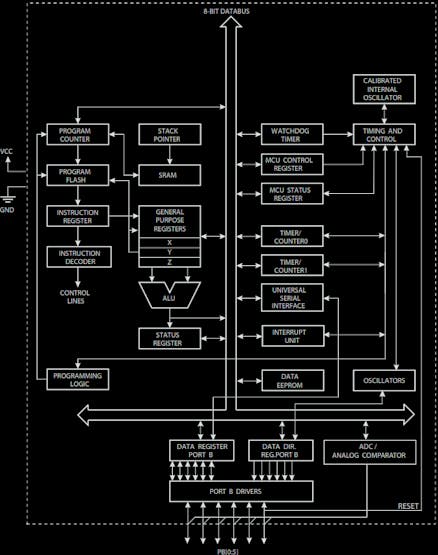

ATtiny85 block diagram
