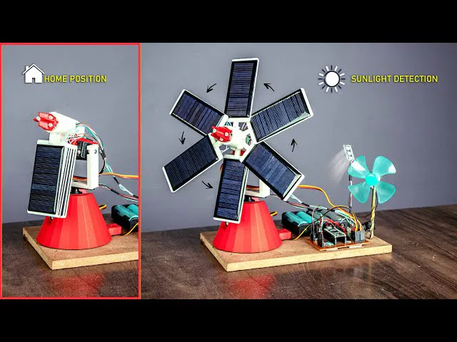

The project is based on LDR sensor, I made the rotatable Solar system which has the home position during night time but when the light is available in day time the solar system automatically waking up through sensing the light presence and all the solar panels rotate counter clockwise and open like a sunflower and follow the sun rotation, after the sun fallen down all the solar panels are automatically rotate clockwise and go to the home position for next day sun light.

You can see the fifth resistor is placed on the middle position of the solar top, when the light is minimum ,the micro controller Arduino read the resistance value and the the threshold value is sated in the coding section, when the light is available and the threshold level breaks,
the Arduino rotate the n20 servo gear motor anti clockwise through the L293D motor Driver till the limit switch level high, when anticlockwise limit switch pressed the panel stop rotating and panel is fully opened position
when the button is pressed, now the main work is going to progress, according
the sun rotation other 4 LDRs sense the light and send data to the Arduino, and Arduino process the data then rotate the servo motors according the sun rotation, the rotation position of the servo is max 170 degrees, when the sun goes down the fifth LDR sense data again and this time the process is reverse condition,
the LDR data goes down blow the threshold level and Arduino Rotate the N20 motor clockwise till the 2nd limit switch press and run the servo in home position, when light is available in next day the same process goes on again.

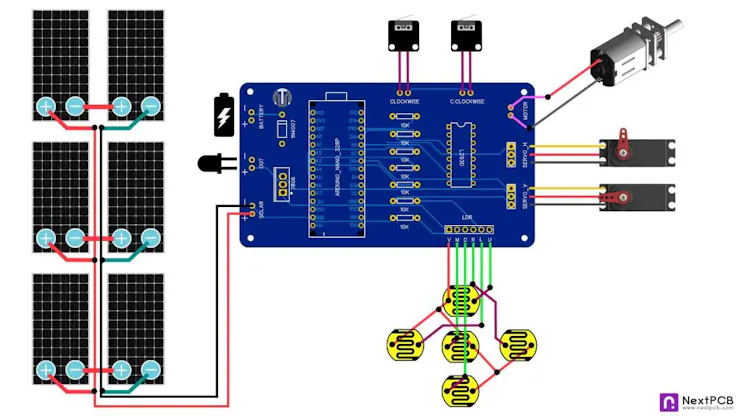

We are going to use 6 pieces of solar panel and each has 6V 70mAh power output, We will wire the one pair of panels in series and 3 pairs in parallel, then the voltage output will be 6+6=12v, So basically when the panels are fully opened the voltage output is 12V and when the panel goes on in home position the voltage output will be 1-3 volts

Step 6: Schematic & Circuit
The custom Designed PCB is suitable for this work, this pcbs are not that complicated for project work and the short-circuit free also.
Download Gerber (click here)
Download the Gerber file and Order it from NEXTPCB.
After got the PCB, Now you can follow this Circuit to make your project happen.
