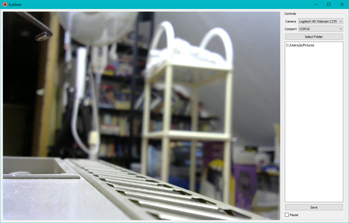

Once upon a time, I wanted to make photos of things as I was soldering them together. To do that, I needed a camera that I could aim and operate while my hands were full and my eyes were busy.
Thus were born EyeGore and the Box o' Buttons.

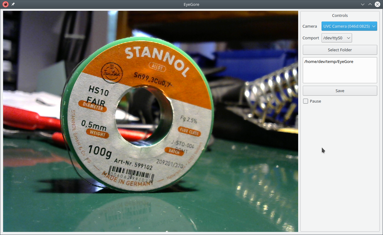

EyeGore consists of a webcam mounted on an old pair of sunglass frames and a Python/PyQt5 program to make snapshots.
The Box o' Buttons is a wooden box with a couple of large pushbuttons and an Arduino Nano.
Together, they all look like this:
The camera program has normal onscreen buttons to make snapshots, but it also "takes commands" from the Box o' Buttons.
The EyeGore program automatically names and numbers the photos as they are made.
Aim, stomp on a button on the floor, keep right on working while EyeGore puts away the photo.
