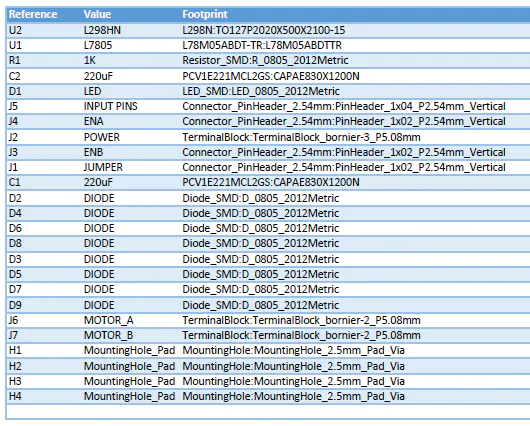

BOM (Bill Of Materials)

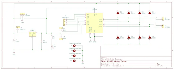

Schematics

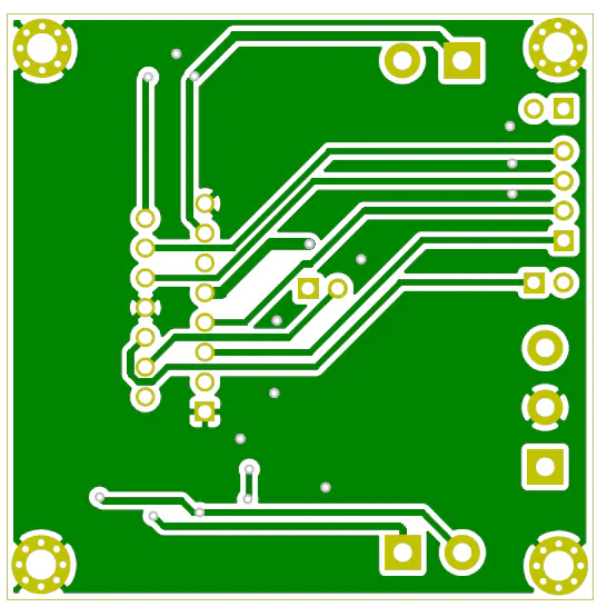

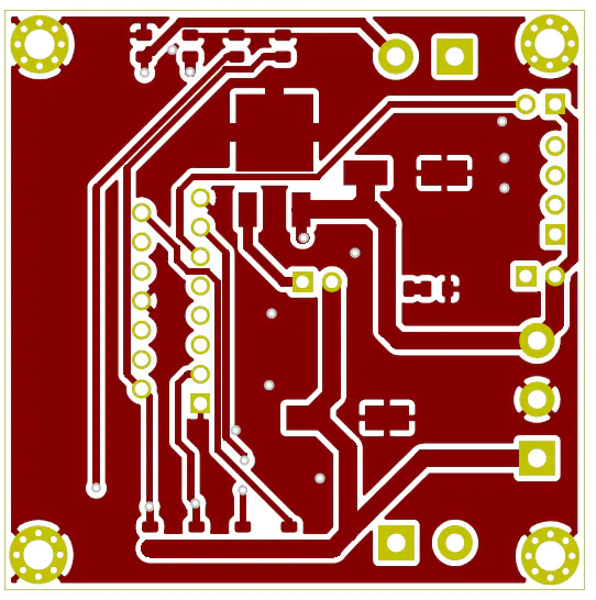

Top Layer
Bottom Layer
