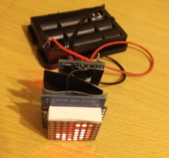

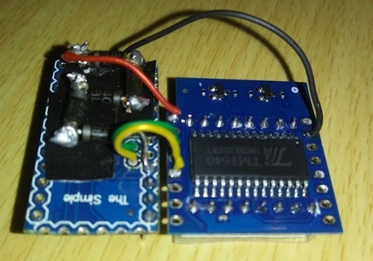

We need 4 wires between WEMOS D1 Mini Matrix LED Shield and Arduino Pro Mini as follow:
WEMOS D1 Mini Matrix LED Shield - Color - Arduino Pro Mini
3V3 - Red - 3.3V
D7 - Green - A4
D5 - Yellow - A5
GND - Black - GND

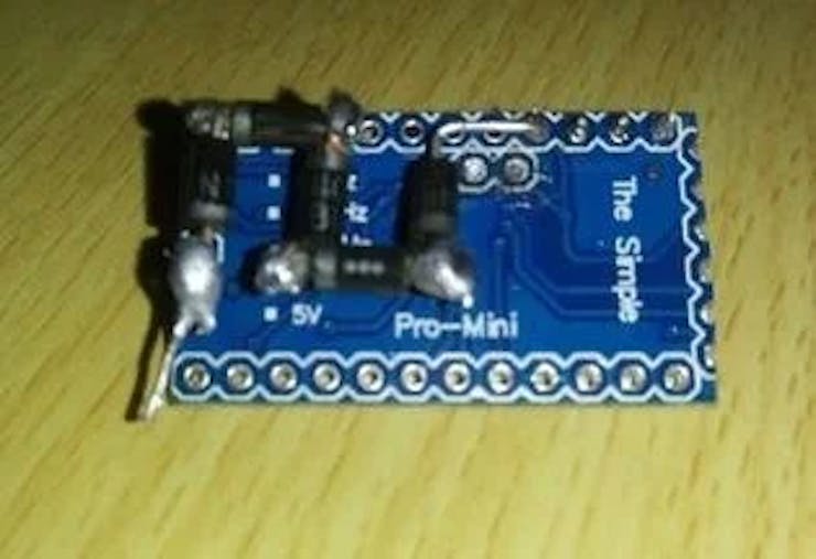

Note that we are using Arduino Pro Mini 5 volt version so we had to step down the voltage using 5 diodes.
Check your Arduino operating voltage before connecting to WEMOS D1 Mini Matrix LED Shield. No voltage stepping down is needed if using Arduino Pro Mini 3.3V version.

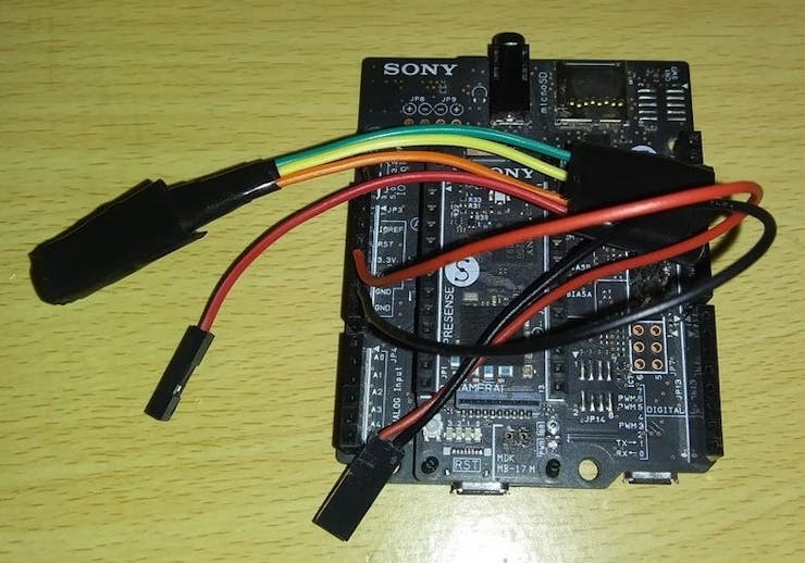

We need 6 Arduino male to female jumper wires plugged in the programming Arduino as follow:
Sony Spresense - Color
10 - Red (RST)
11 - Orange
12 - Yellow
13 - Green
5V - Red (Power)
GND - Black

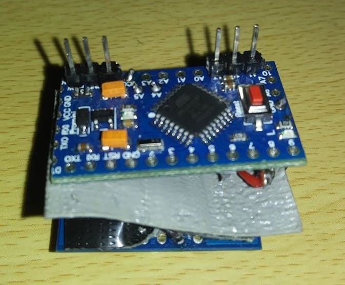

We need 6 pins soldered on Arduino Pro Mini to connect the female side of the programming Arduino jumper wires as follow:
Arduino Pro Mini - Color
RST - Red (RST)
11 - Orange
12 - Yellow
13 - Green
RAW - Red (Power)
GND - Black

Open Arduino IDE then File > Examples > 11.ArduinoISP > ArduinoISP. With Sony Spresense board, it is necessary to uncomment the following line:
// #define USE_OLD_STYLE_WIRING
Once that's done, press Ctrl+U to upload code into Sony Spresense or the programming Arduino you are using.

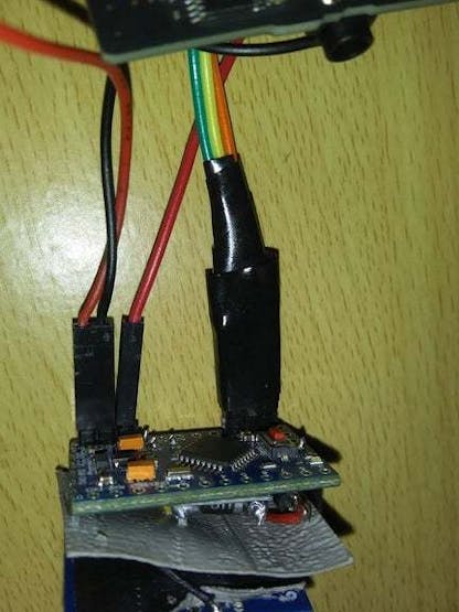

Last thing we need to do is upload the code to target Arduino. Download the code from Github, but do not press Ctrl+U in Arduino IDE because that will result in overwriting the code you already uploaded into Spresense which is needed to use it as a programmer. Instead, press Ctrl+Shift+U to upload using the programmer.
At this point you'll only need two wires to power Arduino Pro Mini.
