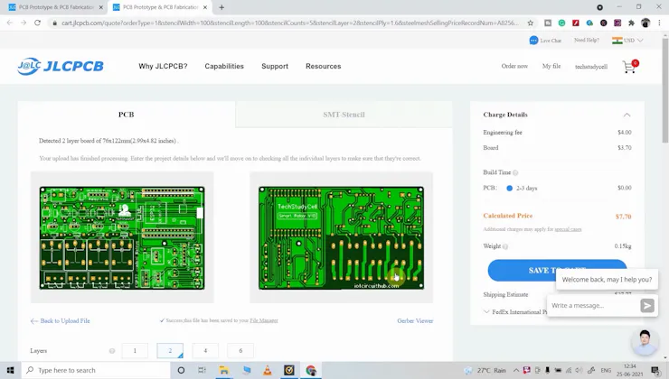

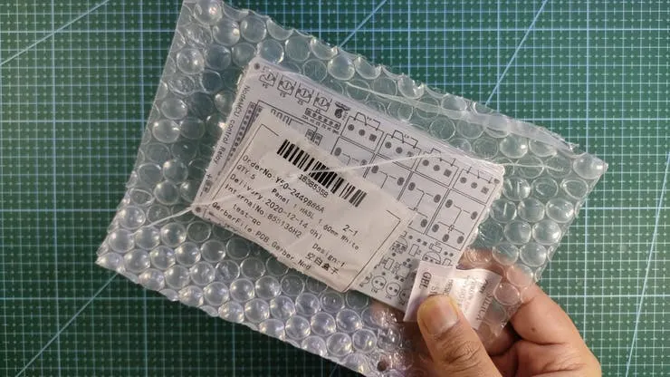

Design the PCB for This Smart Home System:
To make the circuit compact and give a professional look, I have designed the PCB after testing all the features of the smart relay module.
You can download the PCB Gerber file of this home automation project from the following link:

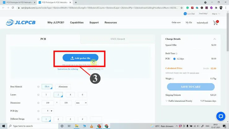

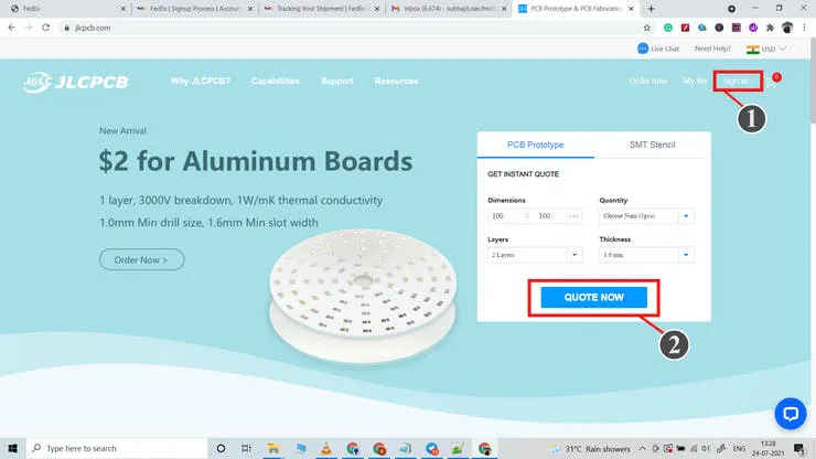

Order the PCB from JLCPCB:
After downloading the Garber file you can easily order the PCB
1. Visit https://jlcpcb.com and Sign in / Sign up
2. Click on the QUOTE NOW button.
3. Click on the "Add gerber file" button. Then browse and select the Gerber file you have downloaded.

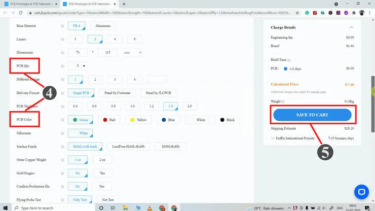

Uploading the Gerber File and Set the Parameters:
4. Set the required parameter like Quantity, PCB masking color, etc.
5. After selecting all the Parameters for PCB click on SAVE TO CART button.

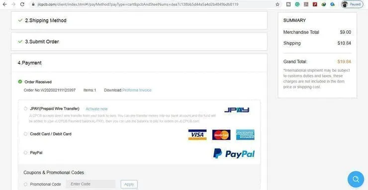

Select Shipping Address and Payment Mode:
6. Type the Shipping Address.
7. Select the Shipping Method suitable for you.
8. Submit the order and proceed with the payment.
You can also track your order from the JLCPCB.com
My PCBs took 2 days to get manufactured and arrived within a week using the DHL delivery option.
PCBs were well packed and the quality was really good at this affordable price.

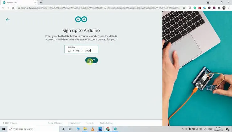

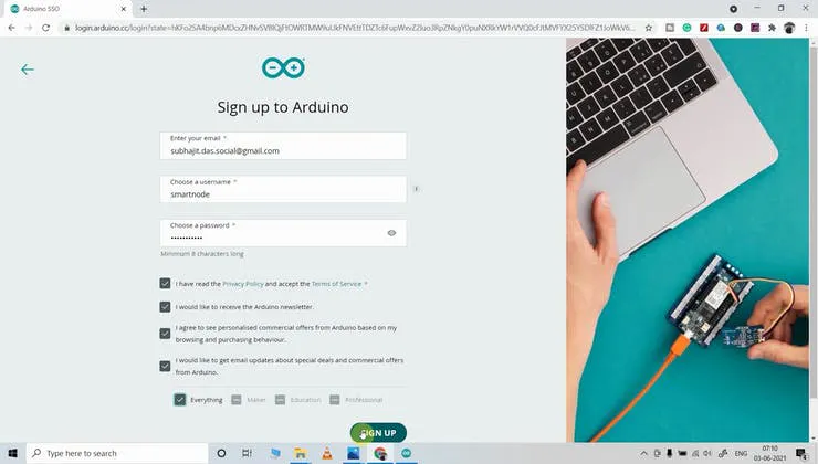

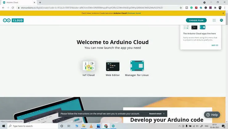

Create Arduino IoT Cloud FREE Account:
For this smart house project, I have used the Arduino Cloud Free plan.
Click on the following link to create an Arduino IoT Cloud account.
https://store.arduino.cc/digital/create
- Click on "Create one".
- Enter your birthday, then click on "Next".
- Enter the email ID, user name, set password. Then click on "Sign Up".

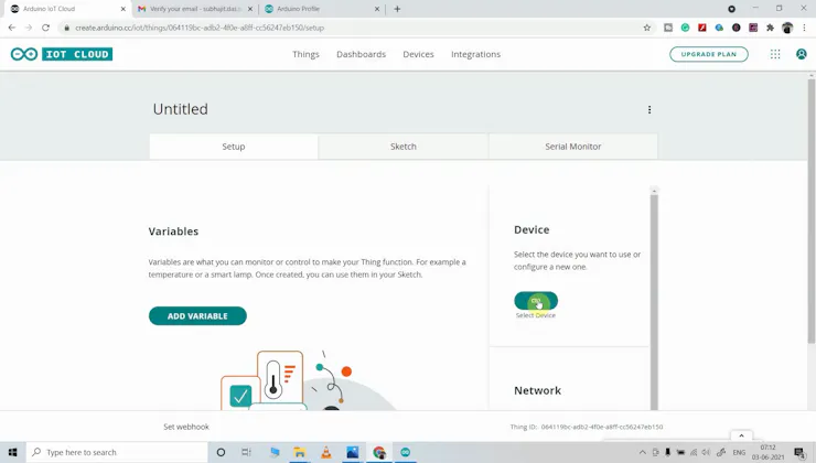

- Now click on "IoT Cloud".

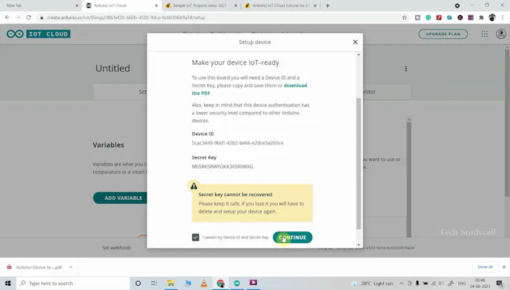

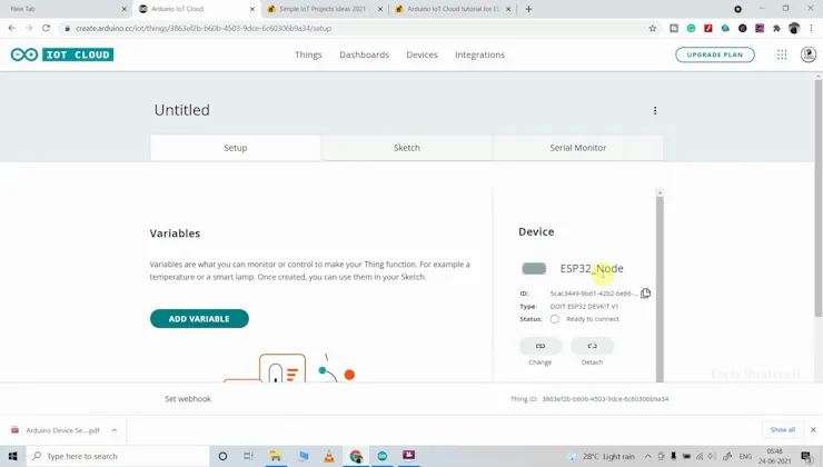

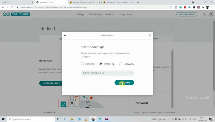

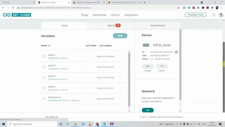

Add ESP32 Device in the Arduino IoT Cloud:
- Click on the Select Device on the right.
- Select "Set up a third Party device", then select device type as ESP32 and device model as DOIT ESP32 DEVKIT V1.
- You will get a Device ID and Secret Key which will be required in the code.
- Click on "Continue", You will find the device added.

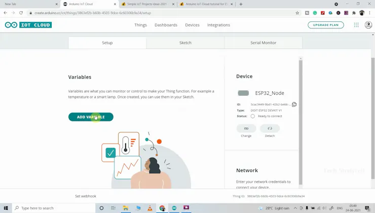

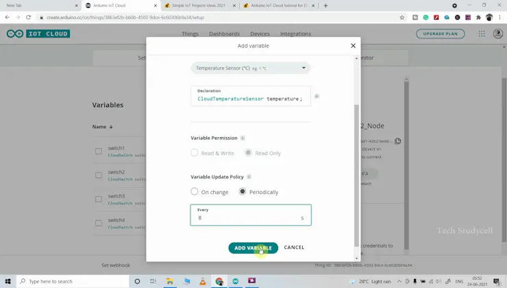

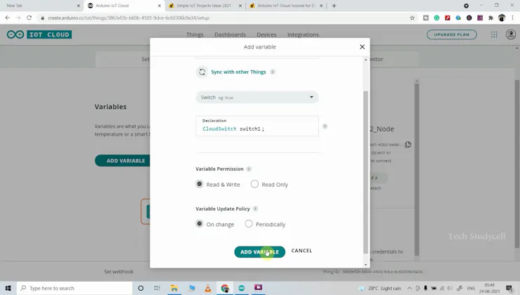

Add Variable in Arduino IoT Cloud:
Now to control 4 relays, and get reading from the DHT11 sensor, you have to add 5 variables.
Click on the "ADD VARIABLE" button.
Enter name, then select Alexa compatible switch type. Variable Permission will be "Read & Write" and Variable Update Policy will be "On Change".
In a similar way, you have to add the next 3 variables.
For the room temperature, reading select Alexa compatible Temperature Sensor. Variable Update Policy will be "Periodically", and mention the interval time.

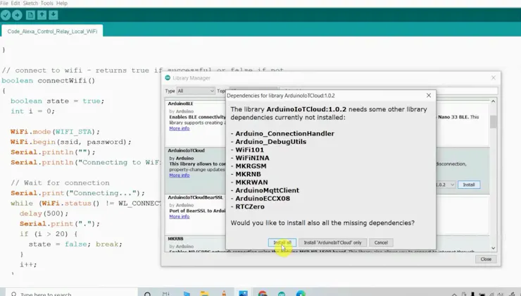

Program the ESP32 With Arduino IDE:
To program the ESP32, I have used Arduino IDE.
Download the code for this project.
First, you have to install the ArduinoIoTCloud library. During installation, it may ask to install other dependencies. Then click on Install All.
In the code, enter the following details.

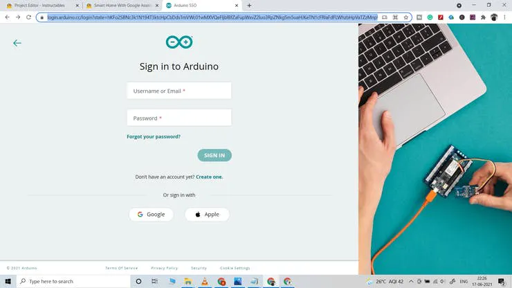

Connecting Arduino Cloud Devices With Alexa:
Log in with the Arduino Cloud credentials.
- Tap on CLOSE.
- Tap on "DISCOVER DEVICES". It will take a minute to add devices. During this time the NodeMCU should be connected with the WiFi.
- Tap on "Devices", and tap on "Switches" to see all the devices.
Thus, all the devices from Arduino IoT Cloud will be added to Amazon Alexa App.
