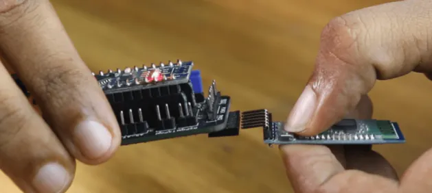

Actually, this PCB will serve as a shield for the nano-based Arduino. The Bluetooth module can be attached to the shield. Almost all of the digital and analog pins have headers, so you can use this board for your projects as is.
All you have to do to switch it from configuration mode to wireless programming mode is move the Jumper.Battery, adapter or USB data cable, and power bank are all options for powering this board.

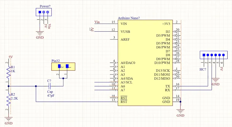

Step 5 – The Circuit
The schematic is shown here. Remove the headers from RXSet and TXSet and connect them to RXPGM, TXPGM, and RESET if you are using the Shield.Verify the COM Ports in the Arduino IDE.

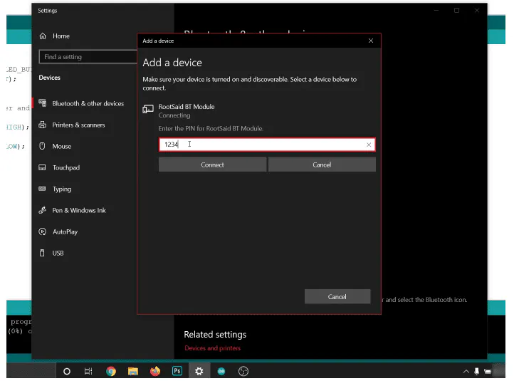

Step 6 – Pairing with the Bluetooth Module
Your laptop’s Bluetooth settings are now accessible, allowing you to scan for nearby devices.
It should show you the Bluetooth module in the list of available modules. Set up a connection, enter a PIN, and pair the device.
