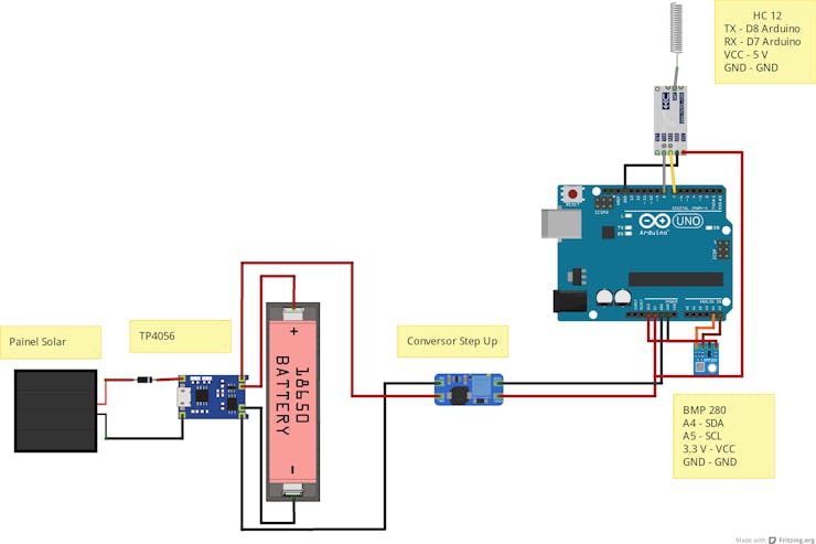

The figure below shows the electronic scheme of the project. How does the circuit work?
The solar panel is responsible for receiving sunlight and transmitting energy to the TP4056 charger. Use a Shottky diode between the solar panel and the TP4056 module.
It is used to protect the solar panel against polarity reversal in the battery charger.
Figure 1 – Schematic circuit with the connections of the solar panel and TP4056 charger and Step Up converter.
The battery must be connected to terminals B+ and B- of the TP4056 module. This module has the IC DW01 that protects the battery against overload.
Never use an inappropriate module to charge the battery, as it may explode, be careful.
The Out + and Out – outputs are connected to the Vin + and Vin – terminals of the Step-Up converter. Figure 2 shows the model of Step-Up converters used. This model features a USB output.

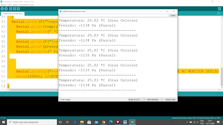

In the figure below we have the temperature and pressure values displayed on the Arduino IDE Serial monitor.
Figure 4 - Serial monitor displaying measured values of temperature and pressure.
This data will be received by the HC-12 receiver module.
