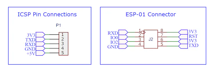

The ESP-01 is connected in socket 2x4 presented in our ESP-01 shield programmer.

After that, we have the circuit to set the ESP8266 ESP-01 to programming and reset mode. This circuit is a big differential on this shield board.
Figure 7 - Circuit to program ESP8266 ESP-01 and reset the board.

Use the Arduino IDE orother IDE to create your control logic and transfer it to the ESP8266 ESP-01.
How to program the ESP8266 ESP-01?
To do this, you must perform the following steps:
Ready! Your ESP01 is configured to receive a new code. Now, carry out the process of transferring your code through the Arduino IDE.
Figure 9 - Circuit to connect the USB-TTL Converter and ESP8266 ESP01 socket to connect ESP-01 Board.

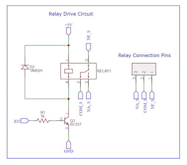

After transferring the code, you are free to create any programming to control the relay. In the figure below, we have the relay activation circuit.
Figure 10 - Circuit to control the relay.

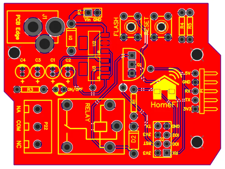

Finally, the design of the layout of the printed circuit board was carried out...
Printed Circuit Board Layout Development
Below we have the layout developed from the project's electronic schematic.
Figure 11 - Layout of our printed circuit board.

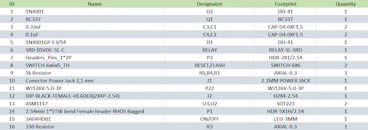

Below, we have the bill of materials needed for you to assemble your printed circuit board and develop various automation projects.
Figure 12 - Bill of materials.
This item list can be purchased directly from LCSC Components in the ordering process for your printed circuit board.
