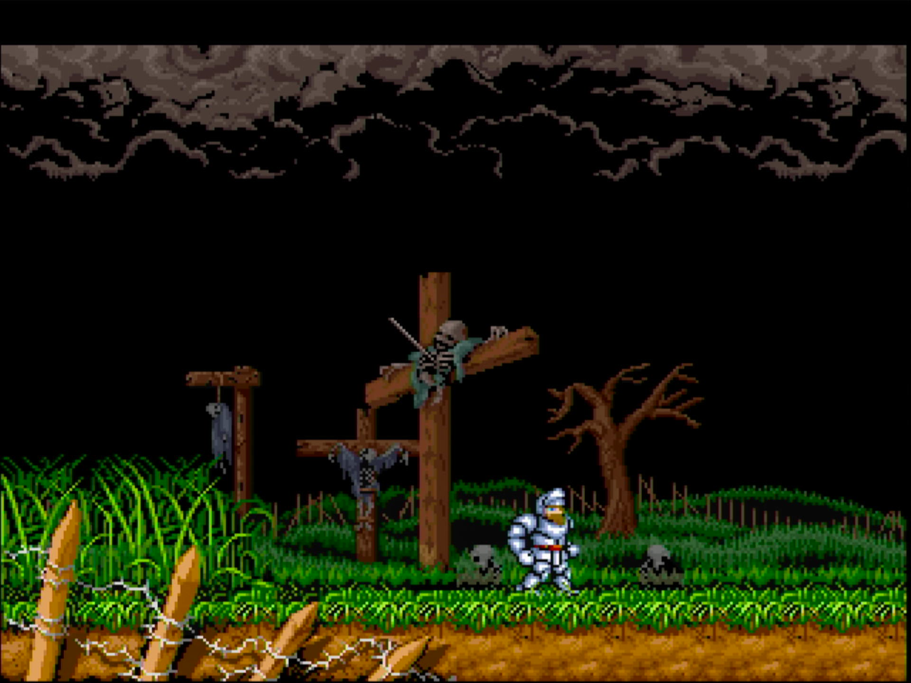

Initial output and timing issues
After a few false starts and bug fixing, I managed to get something that was starting to look like a tiled image.
I eventually arrive at a nice stable image, not perfect but starting to look more like the output that I’m expecting.
The main issue in this image is that the first tile row is actually starting around a third of the way into the image and the last row is repeated at the top of the screen. Other than that, the image looks like a good starting point and giving a sense of optimism that the code is moving in the right direction.

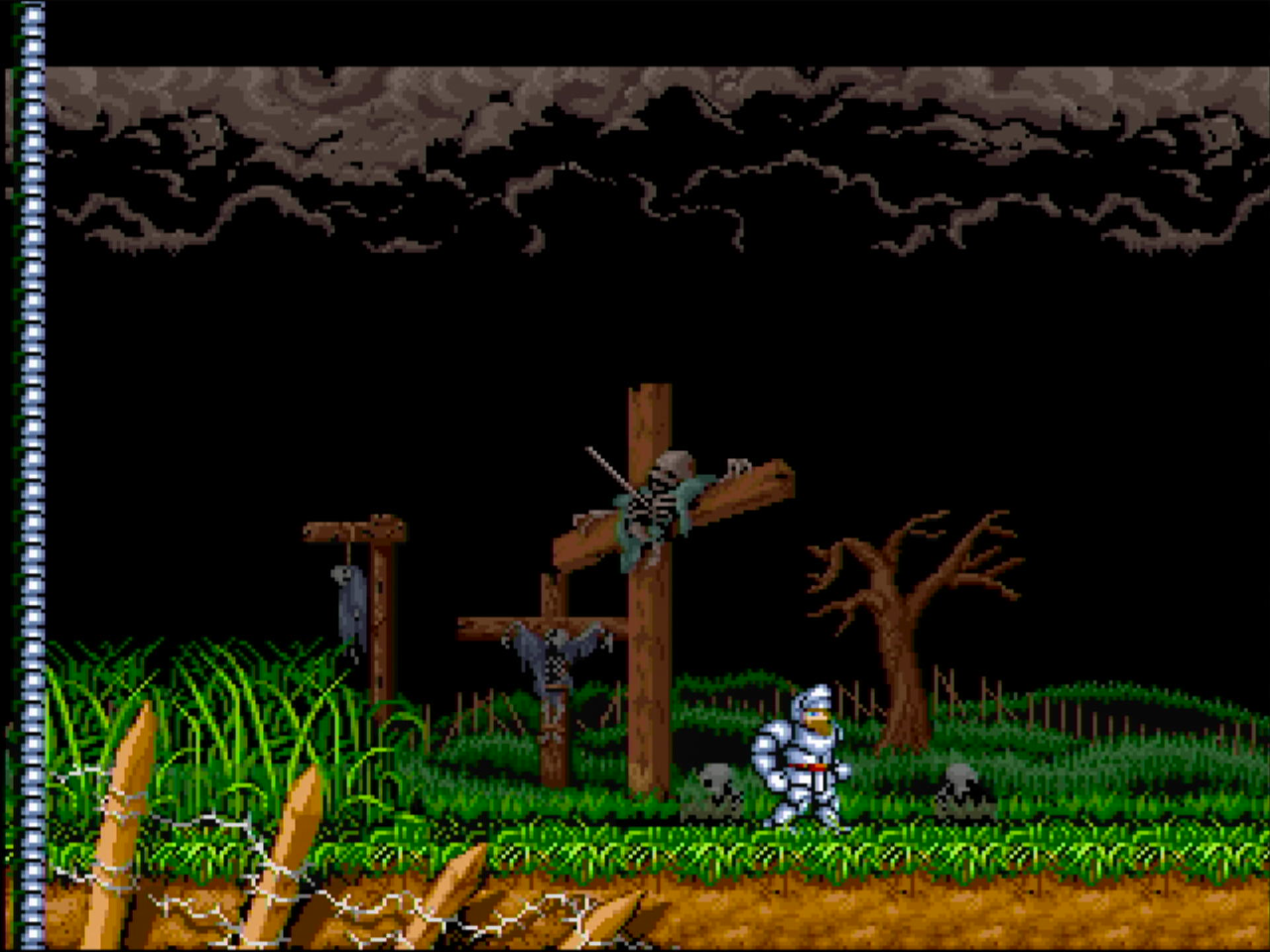

Initial thoughts on fixing the image was that the FIFO wasn’t starting at the correct point, with some work on the timings, I managed to get something that looked a bit more reasonable but still with issues. The image still looked as if it was starting drawing the row too late. Convinced this was an issue with the FIFO, I changed the FIFO to use a line buffer for the row, this has two benefits to it. It allows deterministic positions in that reading pixel 0, should always be the correct position, and having a full line buffer means that it no longer needs to fetch the data twice for duplicating the vertical row.
Unfortunately, this didn’t resolve the problem that start of the image is still showing the wrong tile data at the start of the image.
This is where the for lack of a better term “interesting” debugging process started. The tile at index 0 was wrong, but there was a few moving parts to the puzzle here, was the CPU side writing the correct data? To rule that out I initialised the tile map ram with known data. Them in simulation I initialise the SRAM with known data. With this, running in simulation looks good but on real hardware the problem still occurs. After a lot of tests writing test data to the ram and tile maps and many other debugging steps, as a test, I force the map index for the first tile in the row to a known value and it shows the up as expected
Simulation vs real hardware
This is where real hardware on the FPGA can make a diference. I was making the assumption that the Dual port RAM in the FPGA BRAM latency works on a single clock cycle, and when looking at simulation it looks as if it was doing exactly what was expected. When fetching the tile map index, was setting the address for the tile location and reading it back in the next clock cycle. Adding an extra state wait into fetching the tilemap index fixed the problem.
Now the tiles are showing in the correct position. This was the first (of many) issue where I had to add an additional wait state to fix an off by 1 clock issue. There was still the issue of a few pixels at the start of the line but those turned out to be a similar issue where I had to insert an additional wait state, this time in the SRAM controller. This is a situation where real hardware does something different to the simulated version.
