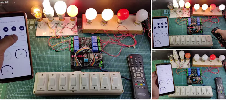

Before designing the PCB, I have made the complete circuit using ESP32, an 8-channel relay module, sensors, and manual switches.
As you can see, the relays can be controlled from the Blynk IoT app, IR remote, and manual switches.
If the WiFi is not connected with ESP32, still you can control the appliances from manual switches and IR remote.
Control Relays With Blynk IoT App:
If the ESP32 is connected with WiFi, then you can control the home appliances from Blynk IoT App.
You also use multiple smartphones to control the appliances with Blynk App. For that, you have to log in same Blynk account from all the smartphones.
In this way, all smartphones will be sink to the Blynk server. You can control, monitor the real-time status of the relays, room temperature & humidity from anywhere in the world in the Blynk IoT App.
If the ESP32 is not connected with WiFi, still you can control the appliances with IR remote and Manual Switch without internet.
ESP32 Control Relay With IR Remote:
You can always control the relays from the IR remote. For this project, you can use any IR remote.
You can monitor the real-time feedback in the Blynk IoT App.
I have explained how to get the IR codes (HEX codes) from any remote in the following steps.
Control Relays Manually With Switches:
You can also control the relays from the switches or pushbuttons.

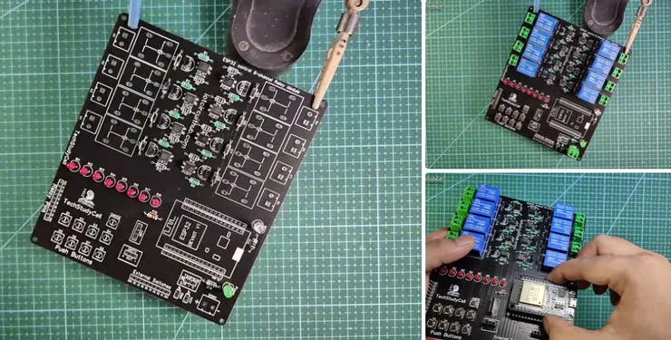

Designing the PCB for ESP32 IoT Projects:
To make the circuit compact and give a professional look, I have designed the PCB after testing all the features of the smart relay module on the breadboard.
You can download the PCB Gerber file of this home automation project from the following link:

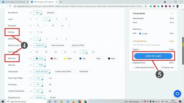

Order the PCB from JLCPCB:
After downloading the Garber file you can easily order the PCB
1. Visit https://jlcpcb.com and Sign in / Sign up
2. Click on the QUOTE NOW button.
3. Click on the "Add gerber file" button. Then browse and select the Gerber file you have downloaded.
Uploading the Gerber File and Set the Parameters:
4. Set the required parameter like Quantity, PCB masking color, etc.
5. After selecting all the Parameters for PCB click on SAVE TO CART button.

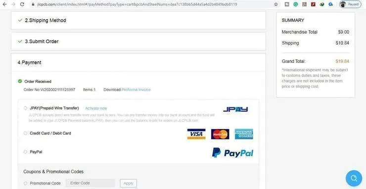

Select Shipping Address and Payment Mode:
6. Type the Shipping Address.
7. Select the Shipping Method suitable for you.
8. Submit the order and proceed with the payment.

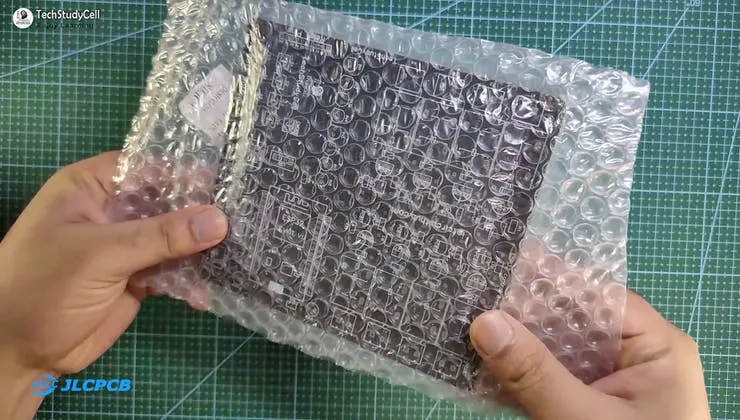

You can also track your order from the JLCPCB.com
My PCBs took 2 days to get manufactured and arrived within a week using the DHL delivery option.
PCBs were well packed and the quality was really good at this affordable price.
Solder All the Components on PCB:
After that, I have soldered all the components as per the circuit diagram.
Then connect the ESP32 board, DHT11 sensor, LDR, and 1838 IR receiver with PCB.

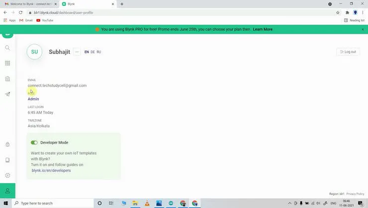

Create FREE Blynk Cloud Account:
For this smart house project, I have used the Blynk IoT Cloud Free plan.
Click on the following link to create a Blynk Cloud account.
https://blynk.cloud/dashboard/register
- Enter email ID, then click on "Sign Up". You will receive a verification email.
- Click on Create Password in the email, Then set the password, click on Next.
- Enter your first name, click on Done.
After that Blynk cloud dashboard will open.

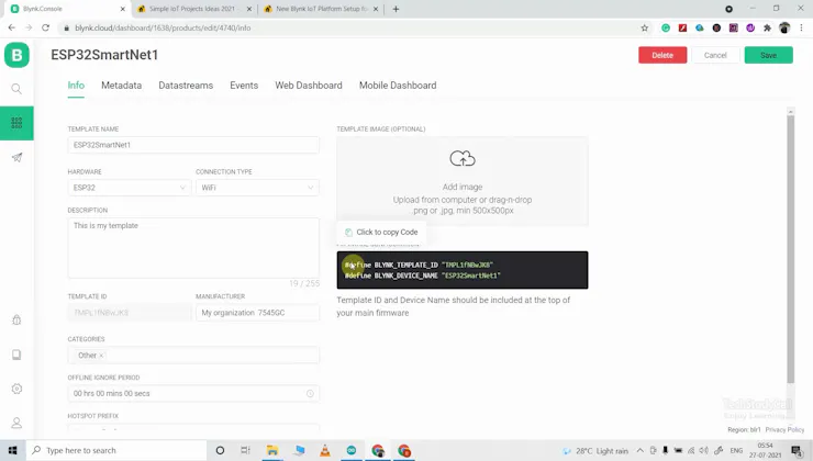

Create a New Template in Blynk Cloud:
First, you have to create a template in the Blynk cloud.
- Click on New Template.
- Enter a template name, select the hardware as ESP32, and the connection type will WiFi.
- Then click on DONE.
You will get the BLYNK_TEMPLATE_ID and BLYNK_DEVICE_NAME after creating the temple.
The BLYNK_TEMPLATE_ID and BLYNK_DEVICE_NAME will be required while programming the ESP32.

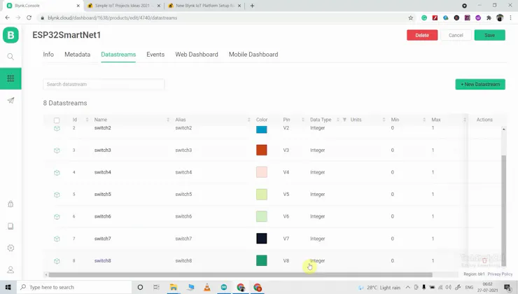

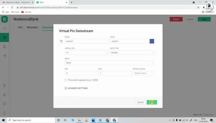

Create a Datastream in Blynk Cloud:
After that, you have to create Datastreams. Here I will control 8 relays, so I have to create 8 Datastreams for relays and 2 Datastreams for sensors.
- Go to the Datastreams tab.
- Click on New Datastream and select Virtual Pin.
- Enter a name, select the virtual pin V1, and the datatype will be Integer.
- Then click on Create.
In a similar way, create 8 datastreams with virtual pin V1 to V8.
And for the Temperature, humidity, and LDR I have used V10, V11, & V12.

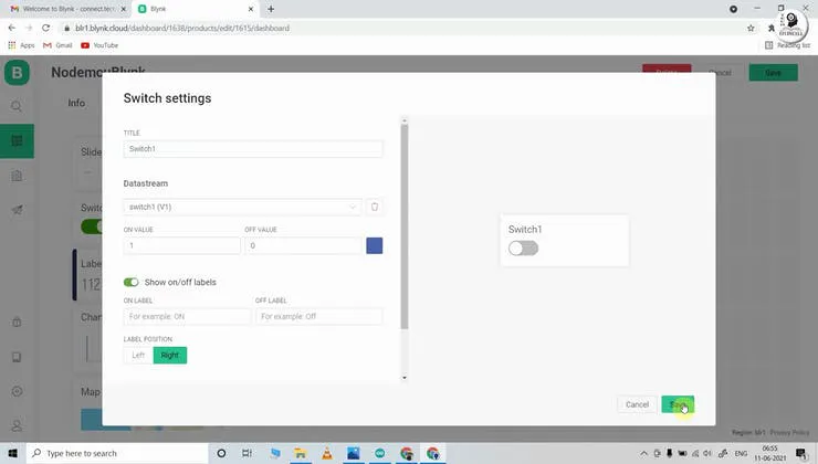

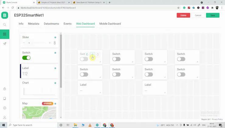

Set Up Blynk Cloud Web Dashboard:
Now go to the web dashboard tab.
Drag and drop 8 Switch widgets and 2 Level widgets.
Go to the settings of each widget, and select a Datastream.
Please refer to the tutorial video for more details.

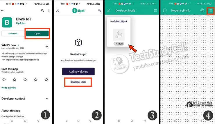

Install Blynk IoT App to Configure Mobile Dashboard:
- Install the Blynk IoT app from Google Play Store or App Store. Then log in.
- Go to Developer Mode.
- Tap on the template that you have already made.
- Now go to the Widget box (on the right) to add widgets.
Add Widgets in Blynk IoT App:
- Add 8 Button widgets from Widget Box.
- Go to Button widget settings.
- Enter the name, select Datastream, Mode will be Switch. Then exit.
- After setting all the Buttons tap on exit.

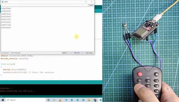

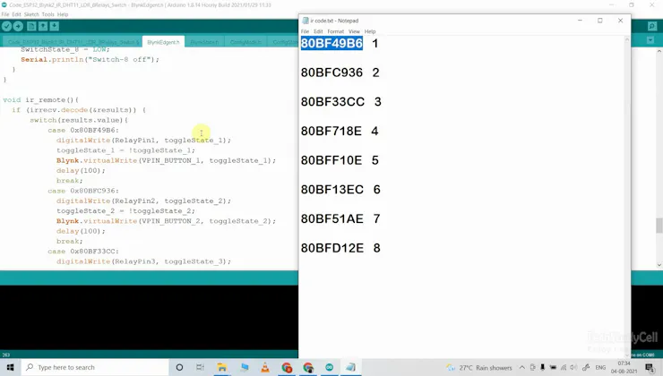

Get the IR Codes (HEX Code) From Remote:
Now, to get the HEX codes from the remote, first, we have to connect the IR receiver output pin with GPIO D35.
And give the 5V across the VCC and GND. The IR receiver must have a metallic casing, otherwise, you may face issues.
Download the code for getting the HEX codes
https://drive.google.com/file/d/1MLJ96CQN3wOuu6iWArsMq9rKsKR5Z3Xi/view?usp=sharing
Then follow the following steps to get the HEX codes
- Install the IRremote library in Arduino IDE
- Download the attached code, and upload it to ESP32.
- Open Serial Monitor with Baud rate 9600.
- Now, press the IR remote button.
- The respective HEX code will populate in the serial monitor.
Save all the HEX codes in a text file.

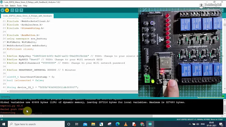

Program the ESP32 for This Blynk Project
Download and install the following libraries in Arduino IDE
- Blynk 1.0.1 Library: https://github.com/blynkkk/blynk-library
- IRremote Library (3.3.0): https://github.com/Arduino-IRremote/Arduino-IRremote
- DHT Library (1.4.2): https://github.com/adafruit/DHT-sensor-library
You have to keep all the 9 files in the same folder.
- Open the.ino file in Arduino IDE.
- In the code, you have to update the BLYNK_TEMPLATE_ID and BLYNK_DEVICE_NAME.
- Then update the HEX code in the ir_remote() function as shown in the tutorial video.
- After that, select the DOIT ESP32 DEVKIT V1 board and proper PORT.
- Then upload the code to ESP32 Board.
While uploading the code to ESP32, if you see the "Connecting....___" text, then press the BOOT button of the ESP32.
