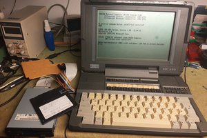

The first part of the project is getting the Gotek to work as the drive B first. Then trying to swap the logical drive letters to make Gotek drive A.
The first problem to be solved is connecting the Gotek to the Atari ST. It has a standard 34-pin, 2-row, 100mil pitch pin interface. The Atari ST has a 14-pin circular DIN which is not possible to find a cable for anymore. So I made an adapter PCB that just takes in a 34-pin header and will plug straight in to the back of the Atari ST.
Next I need to provide power to the Gotek, and it's a standard floppy power input, but the drive only needs 5V power and not 12V power. It's possible to just use USB to provide power to it, and so I made a tiny adapter from the 4-pin, 100mil pitch floppy interface to a mini-USB connector. I also threw a switch in there in case you want to turn the drive off when the computer is off.
