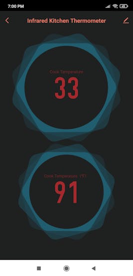

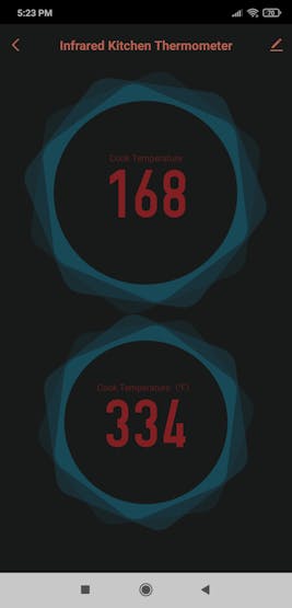

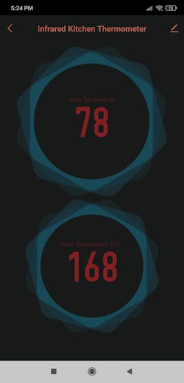

On the thermometer's mobile application interface supported by the Tuya Cloud, the user can monitor two different data points regarding the surface temperature:
- Cook_Temperature - Unit: °C
- Cook_Temperature_F - Unit: °F

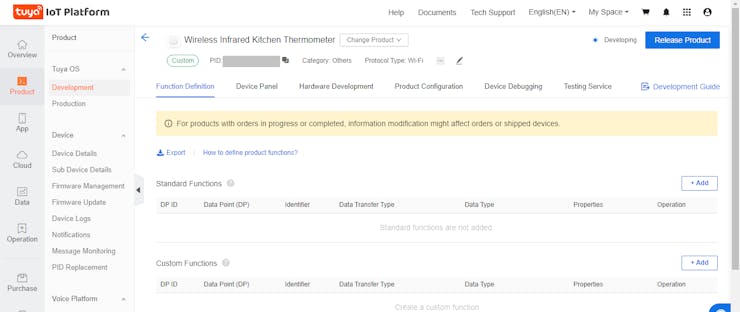

⭐ Then, go to the Tuya IoT Platform and click:
Create ➡ Can't find the category?
⭐ Enter the required product information:
- Protocol ➡ Wi-Fi
- Power Type ➡ Standard Power Consumption
⭐ After creating the product, select the features you want to add to your product from Standard functions or create new ones (Custom) if not supported by Standard functions.
Standard functions indicate the functions provided by Tuya for their product categories. Since there are lots of built-in products, it is easy to find the functions you need. Also, you can create your specialized functions named Custom functions, depending on your project.
The data point (DP) is the abstract representation of a function, and each function has an ID and data type.
Data Point ID (DP ID): indicates the code of a data point (function). Tuya Cloud sends or receives data through data point IDs.
Data Types: Boolean, Value (Integer), Enum, Fault, Char, and RAW.

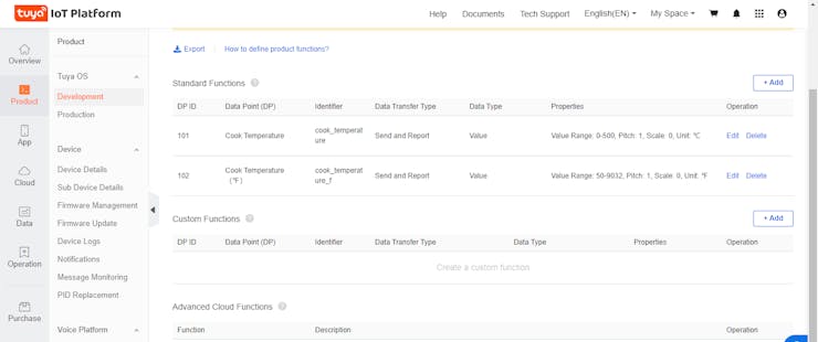

Since there are built-in functions (Standard) provided by Tuya for cooking thermometers, I did not have to create custom functions for my product:
- Cook_Temperature - 101 - Value
- Cook_Temperature_F - 102 - Value
⭐ Then, go to the Hardware Development and select the TYWE3S Wi-Fi Module under the Tuya Standard Module SDK. It has an indistinguishable pinout to the ESP-12E (ESP8266) module.

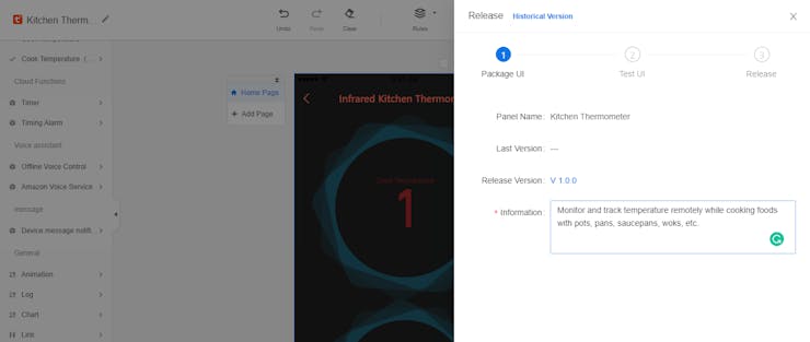

⭐ After creating the product successfully, go to the Device Panel. Then, click the Create Blank Panel under the Visualized DIY Panel.
⭐ Now, design the panel (mobile application interface) with the drag-and-drop components. It is similar to the MIT App Inventor.
⭐ After designing the panel, click the Release button and enter the required information.

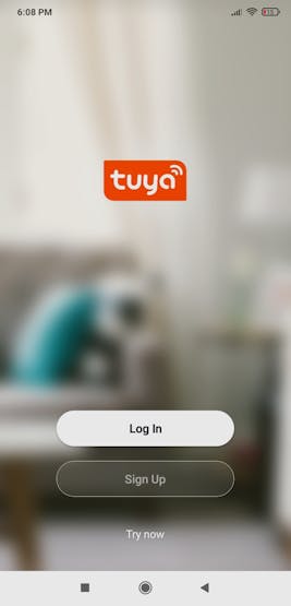

⭐ Finally, download the Tuya Smart app on Android or iOS and sign up.
I will show you how to use the Tuya Smart app to connect to the authorized product (ESP8266) in the following steps.

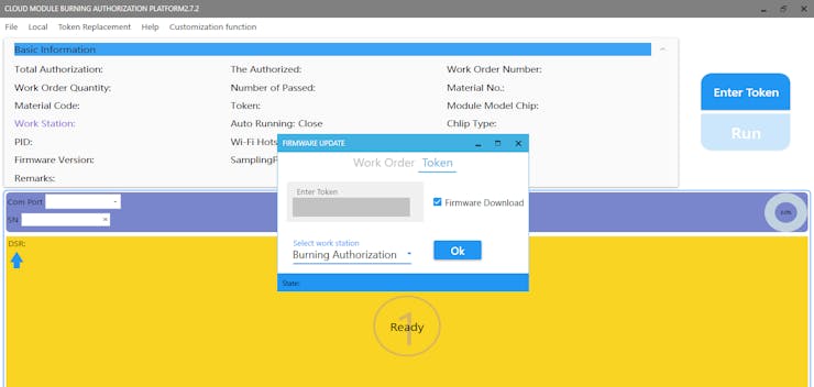

⭐ Then, go to Production Manage ➡ Work Order Management ➡ Activation Code Verification. To activate the production certificate for the product, enter the Token ID. When the Token ID is confirmed, the ESP8266 is ready to be flashed and authorized.

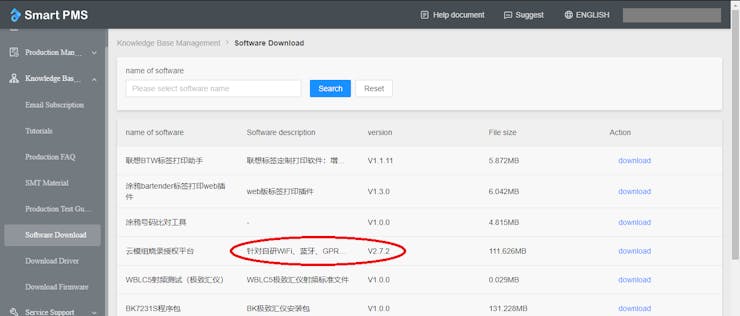

⭐ After confirmation, download the latest version of the Cloud Module Test Platform from Knowledge Base Management ➡ Software Download. You can find a copy in the Downloads.
⭐ After downloading the Cloud Module, open it and log in. Then, go to File ➡ Set Up and enter the required settings as shown below:
- Burning Baud ➡ 921600
- Test Baud ➡ 9600
⭐ Click Enter Token ➡ Token and paste the Token ID under the Burning Authorization. Do not forget to select Firmware Download.
⭐ Now, connect the NodeMCU V3 LoLin ESP8266 to the computer via a USB cable and select its port number, such as COM5. If you did not use it with the Arduino IDE or other compilers before, you may need to install its driver.
⭐ Finally, click Run to flash and authorize the ESP8266 as a Tuya product.

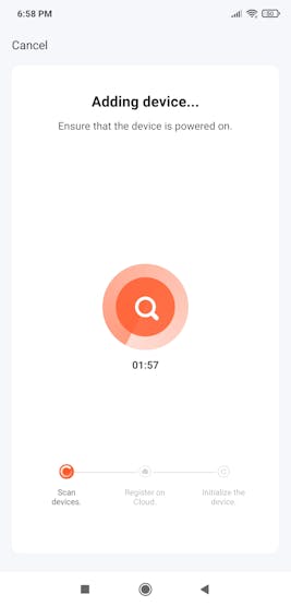

⭐ First of all, press the network connection button on the device until the RGB LED blinks green.

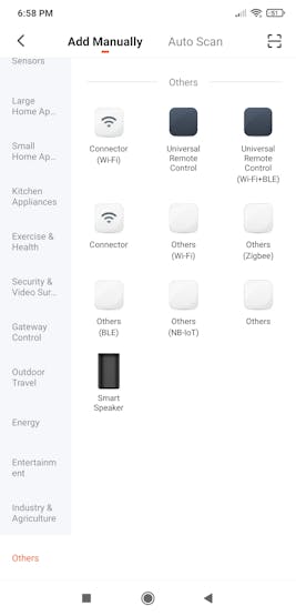

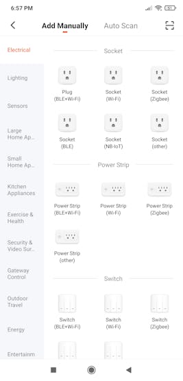

⭐ Then, open the Tuya Smart app and log in.

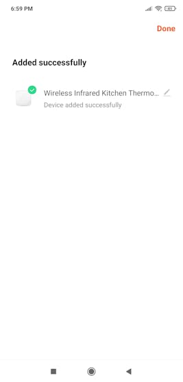

⭐ Go to Add Device ➡ Add Manually ➡ Others ➡ Others (Wi-Fi).
⭐ Connect to a Wi-Fi Network (2.4 GHz).

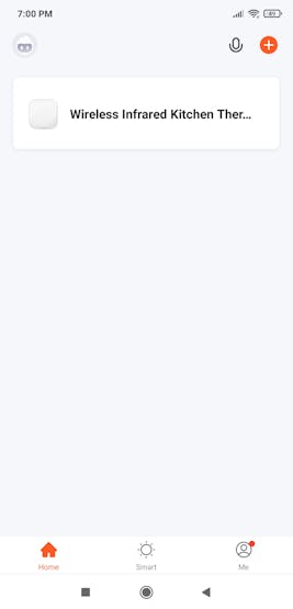

⭐ When the Tuya Smart app finds a product on the network with the given settings, the app adds that product and connects it to the Tuya Cloud automatically.

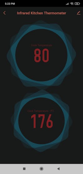

⭐ Once connected, open the mobile application interface (device panel) to monitor temperature measurements produced by the infrared kitchen thermometer via the TS01 IR temperature sensor.

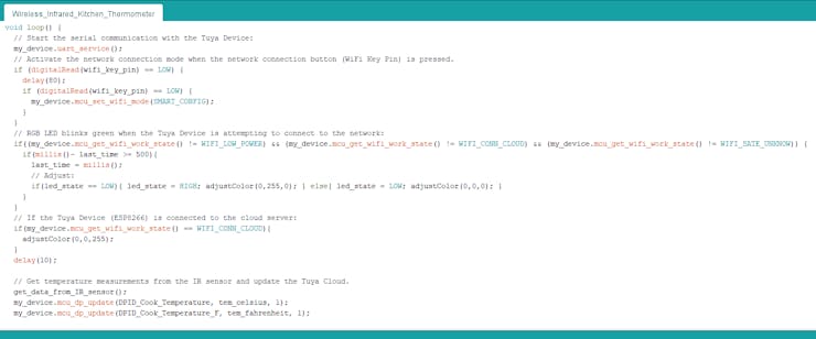

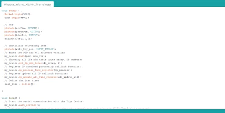

⭐ Initialize networking keys and set the required functions for the Tuya Device.
// Initialize networking keys. pinMode(wifi_key_pin, INPUT_PULLUP); // Enter the PID and MCU software version: my_device.init(pid, mcu_ver); // Incoming all DPs and their types array, DP numbers: my_device.set_dp_cmd_total(dp_array, 2); // Register DP download processing callback function: my_device.dp_process_func_register(dp_process); // Register upload all DP callback function: my_device.dp_update_all_func_register(dp_update_all); // Define the last time: last_time = millis();
⭐ Start the serial communication (software serial) with the Tuya Device.
⭐ Activate the network connection mode when the network connection button (Wi-Fi Key Pin) is pressed.
⭐ RGB LED blinks green while the Tuya Device is attempting to connect to the Wi-Fi network.
⭐ If the Tuya Device (ESP8266) is connected successfully to the cloud server (Tuya Cloud), RGB LED turns blue.
// Start the serial communication with the Tuya Device: my_device.uart_service(); // Activate the network connection mode when the network connection button (WiFi Key Pin) is pressed. if (digitalRead(wifi_key_pin) == LOW) { delay(80); if (digitalRead(wifi_key_pin) == LOW) { my_device.mcu_set_wifi_mode(SMART_CONFIG); } } // RGB LED blinks green when the Tuya Device is attempting to connect to the network: if((my_device.mcu_get_wifi_work_state() != WIFI_LOW_POWER) && (my_device.mcu_get_wifi_work_state() != WIFI_CONN_CLOUD) && (my_device.mcu_get_wifi_work_state() != WIFI_SATE_UNKNOW)) { if(millis()- last_time >= 500){ last_time = millis(); // Adjust: if(led_state == LOW){ led_state = HIGH; adjustColor(0,255,0); } else{ led_state = LOW; adjustColor(0,0,0); } } } // If the Tuya Device (ESP8266) is connected to the cloud server: if(my_device.mcu_get_wifi_work_state() == WIFI_CONN_CLOUD){ adjustColor(0,0,255); } delay(10);
⭐ Elicit temperature measurements generated by the TS01 IR sensor.
⭐ Then, update Cook_Temperature (°C) and Cook_Temperature_F (°F) data points of the Tuya Device.
// Get temperature measurements from the IR sensor and update the Tuya Cloud. get_data_from_IR_sensor(); my_device.mcu_dp_update(DPID_Cook_Temperature, tem_celsius, 1); my_device.mcu_dp_update(DPID_Cook_Temperature_F, tem_fahrenheit, 1);

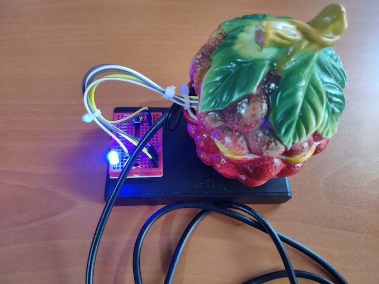

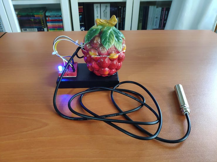

First of all, I connected all components to the Arduino Nano by using jumper wires and two mini breadboards, including the NodeMCU V3 LoLin ESP8266 (Tuya Device). I utilized a 12V external battery to supply the device (infrared kitchen thermometer).
Then, I placed the Arduino Nano and the ESP8266 in a raspberry-shaped ceramic sugar bowl to hide abundant wirings.
Finally, I fastened all parts with a hot glue gun.

🥘🍳 If the NodeMCU V3 LoLin ESP8266 (Tuya Device) connects to the Tuya Cloud via the Tuya Smart app successfully, the device turns the RGB LED to blue.

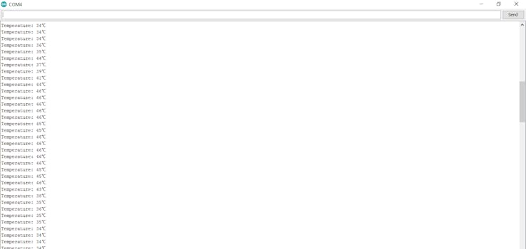

🥘🍳 Once initiated, the device updates the data points in the Tuya Cloud automatically. Then, the Tuya Smart app allows the user to observe the temperature measurements in Celsius and Fahrenheit on the mobile application interface (Device Panel):
🥘🍳 Also, the device displays the temperature measurements (°C) on the serial monitor.
