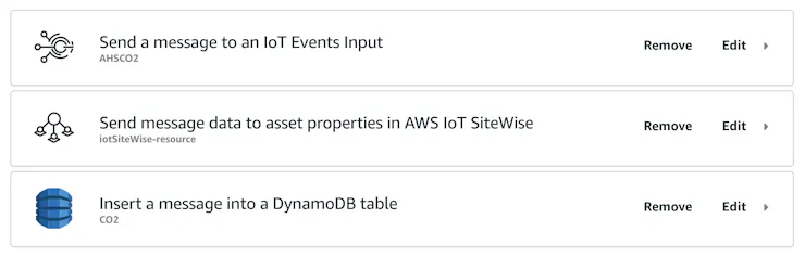

AWS IoT Core
Set up a total of 4 Rules for 4 CO2 monitors to send measured CO2 levels to
- AWS IoT Events
- AWS IoT SiteWise
- Amazon DynamoDB
Refer to the rule.json for the detail.
You can use the AWS CLI and the JSON file to recreate rules. Make sure you change the topic name, the input name, the property aliases, the asset name, and the table name, as needed.

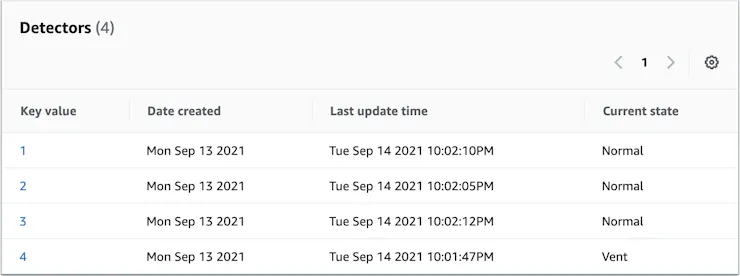

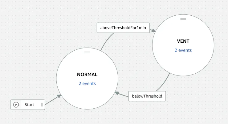

AWS IoT Events
I used AWS IoT Events for the following three reasons.
- Sensors in nature give you transient, abnormally high, false values.
- The fan should not be turned on/off so frequently.
- The system needs to know the states of individual CO2 monitors.
Set up a detector model that has the NORMAL and the VENT states and sends turn-on/turn-off signals to the ventilation fan.
If any of the 4 CO2 monitors continues to output CO2 levels above the threshold (600ppm) for more than 1 min, a detector should shift from NORMAL to VENT and send a turn-on-the-fan message like
"vent": 1,
"id": 1
Once CO2 levels are below the threshold, the detector should shift from VENT to NORMAL and send a turn-off-the-fan message like
"vent": 0,
"id": 1
When you set up a detector model, you can either create a detector for each unique key value or a single detector. I chose the former option because there are 4 CO2 monitors and I need to tell which CO2 monitor is at which state. Make sure each CO2 monitor publishes a message with its unique identifier (1, 2, 3, and 4).
When writing a code for the fan controller, don't forget that there are 4 detectors. Otherwise, the system fails when one CO2 monitor shifts from VENT to NORMAL while another is still in the VENT state. Make sure the fan remains on if one of the detectors is in the VENT state.
By the way, when you cook and need to turn on the fan, send {"vent": 1, "id": 0} from AWS IoT Core. To turn it off, send {"vent": 0 "id": 0}.
Refer to input.json and detector-model.json for the detail.
You can use the AWS CLI and the JSON file to recreate the detector model.
