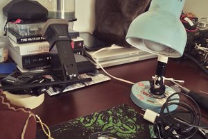

3. Prepare network connection
We need connect the camera to a POE switch,and power on the OpenNCC WE camera.
###span class="_2PHJq public-DraftStyleDefault-ltr"
>span class="_2PHJq public-DraftStyleDefault-ltr"###
