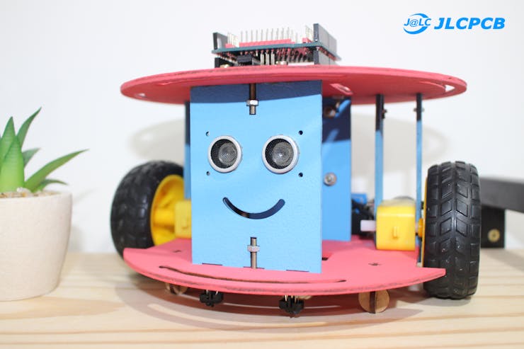

- Figure 3A shows the complete chassis structure of the 2-wheel mobile robot.
- Figure 3B shows the structure of the 2-wheel mobile robot chassis with all peripheral devices installed.

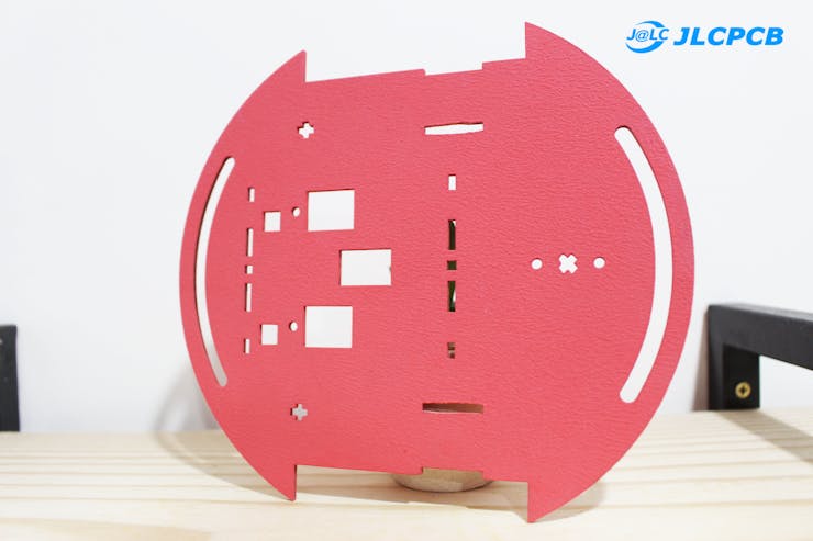

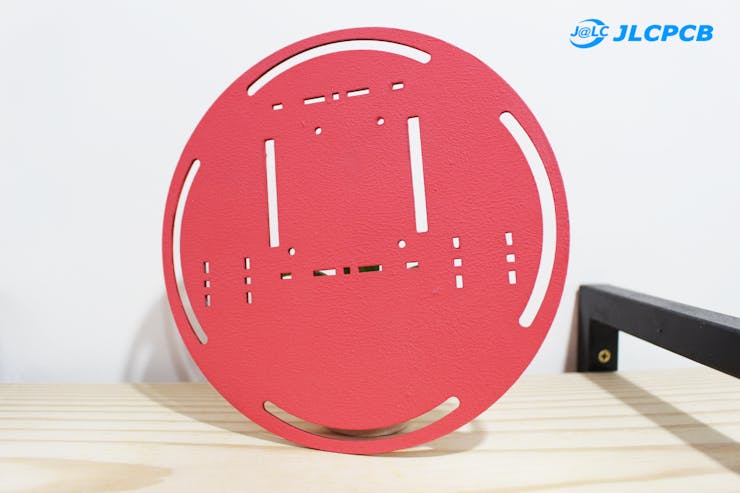

- Figure 3C is the base piece of the mobile robot. It is used for fixing various elements. These elements will be presented in the next topics.
- Figure 3D is the top cover piece of the mobile robot. The Arduino UNO will be installed in it.

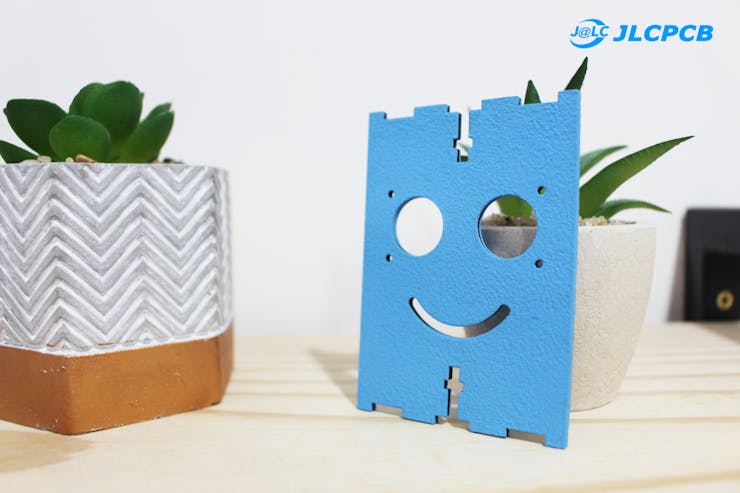

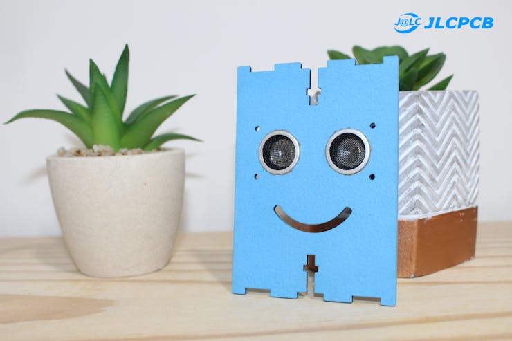

- Figure 3E is the piece for fixing the ultrasonic sensor for detecting obstacles during mobile robot navigation.

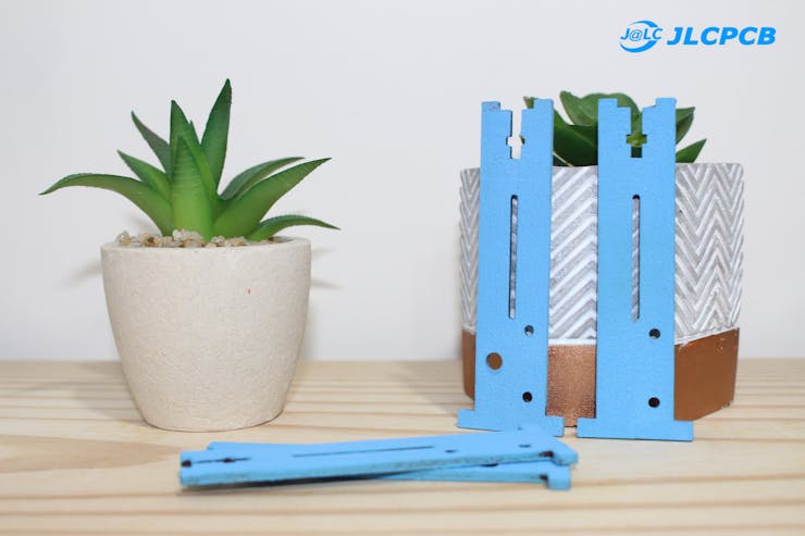

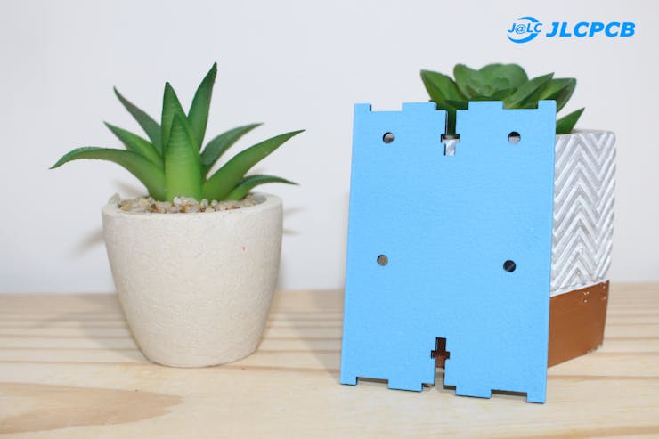

- Figure 3G are the structures that act as spacers for the base and top cover pieces. In addition, they are used for fixing robot motors.

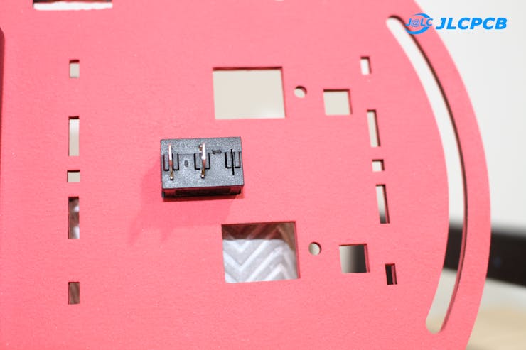

Button to turn the robot on and off
Most mobile robot chassis do not have a structure for attaching a button. We fixed the button in the base region. Through this button, we can turn our robot on and off.
In the figure above, it is possible to observe the button fixed at the place where the piece was cut.

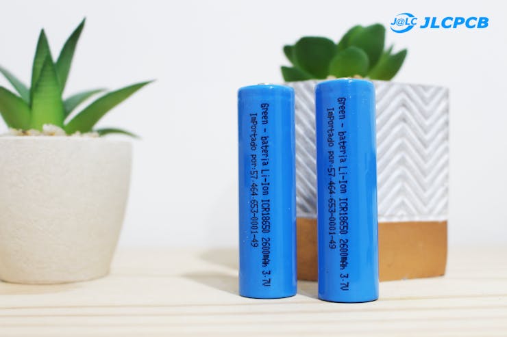

Battery system for powering the 2-Wheel Mobile Robot
The mobile robot's power supply system consists of 2 18650 batteries. They were used to ensure greater autonomy in the robot's operation.
The mobile robot draws a current of an approximate value of 560 mA.
Our batteries have a capacity of 2600 mAh. Therefore, the robot is capable of operating for about 4 hours and 30 minutes.
This result is obtained through the equation: time = capacity/consumption
So we have:
time = (2600 mAh/560);
time = 4h 30 min

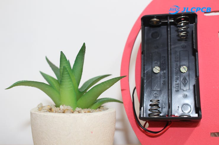

The batteries are shown below and connected in series to provide a voltage of 7.4V.
We use a connector installed on the rear of the mobile robot. This socket allows the installation of 2 batteries.
Figure 6 - Socket of 18650 Battery.
The 2 wires (positive and negative) will be used to power the auxiliary control board and power the entire system.

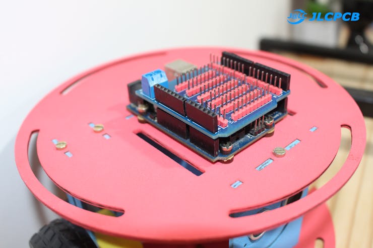

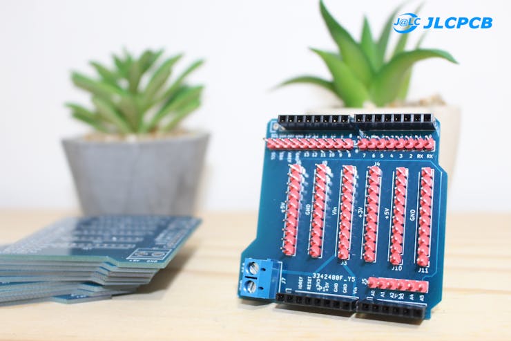

Connection auxiliary board and Arduino UNO
For this project, we developed an auxiliary board for connecting all devices. It was created to solve a big problem and can be useful for you. Pay attention to it!
In many projects we need, for example, to connect all GND terminals through the use of soldering. This makes connecting cables more difficult and makes the circuit more complex.
This also happens for connections of other voltage levels.
To avoid this problem, we developed the shield in the figure below. This shield has multiple GND rails, +3.3V, +5V, Vin, and Arduino pin terminals.
Figure 7 - Arduino Shield Board.
Save your time in assembling projects and use this shield. We provide 5 free samples for you to earn and use in your projects.

In the figure below we have the shield connected to Arduino UNO.
Figure 8 - Shield connected in Arduino.
After connecting all the devices, Arduino will be responsible for reading the sensors, processing the data, and activating the motors to control the movement of the 2-wheel mobile robot.

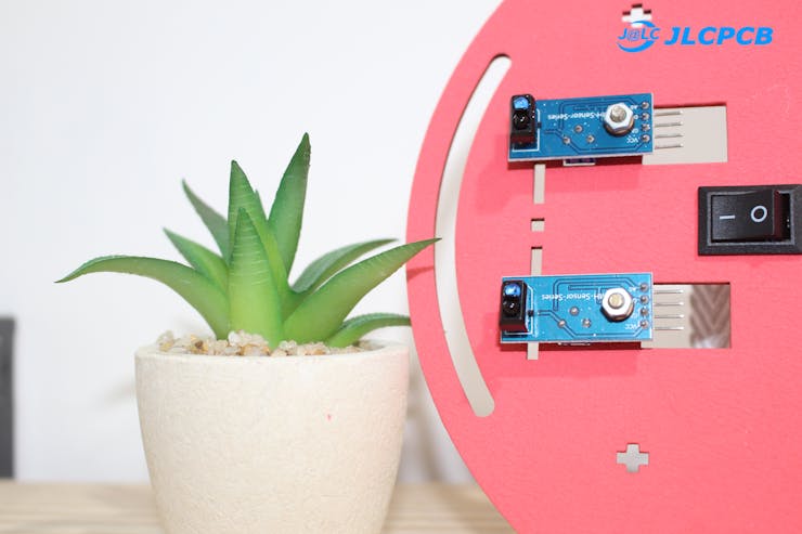

Finally, we have the TCRT5000 sensors for the line follower function. Two sensors were fixed in the lower region of the base piece of the mobile robot. See the figure below.
The 2 sensors are responsible for detecting the ground and the line. They must be installed with a distance less than 8mm to the ground. Above that they will not be able to detect the line.

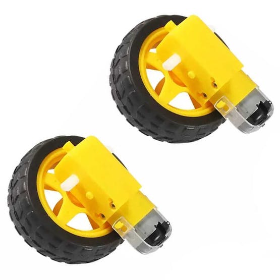

The mobile robot moves through the use of 2 direct current motors. See the engines in the figure below.

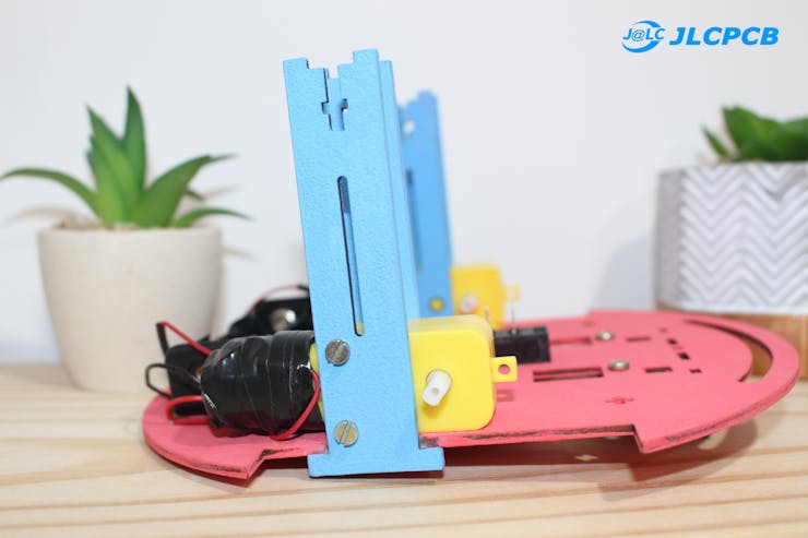

For fixing the motors, two rods were created. In addition to fixing, the rods have the function of creating a space between the lower and upper base of the 2-wheel mobile robot. The rods are shown in the figure below.
Fixing parts are connected and fixed to the base of the mobile robot. Motors are fixed using M3x30 screws. See the figure below.
Note one very important thing in the picture above! We solder the wires to the terminals of each motor. We then apply electrical tape. It is very important to use it.
The insulating tape immobilizes the movement of the wires in the region of the terminals and prevents movements in the wires from weakening and breaking the motor terminals.
In this way, you protect and extend the life of the DC motor.

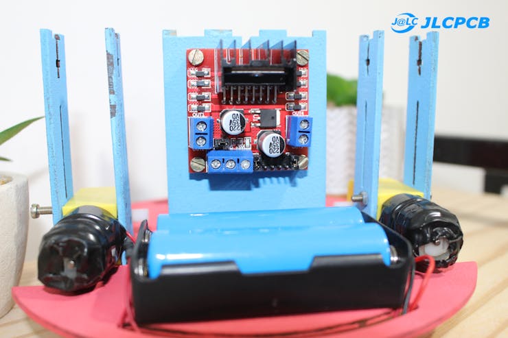

Each motor must be connected to the L293D driver control terminals. See the figure below.
The L293D driver is responsible for carrying out the drive, direction and speed control of the mobile robot motors.
Command signals are sent via 4 digital pins of the Arduino UNO.

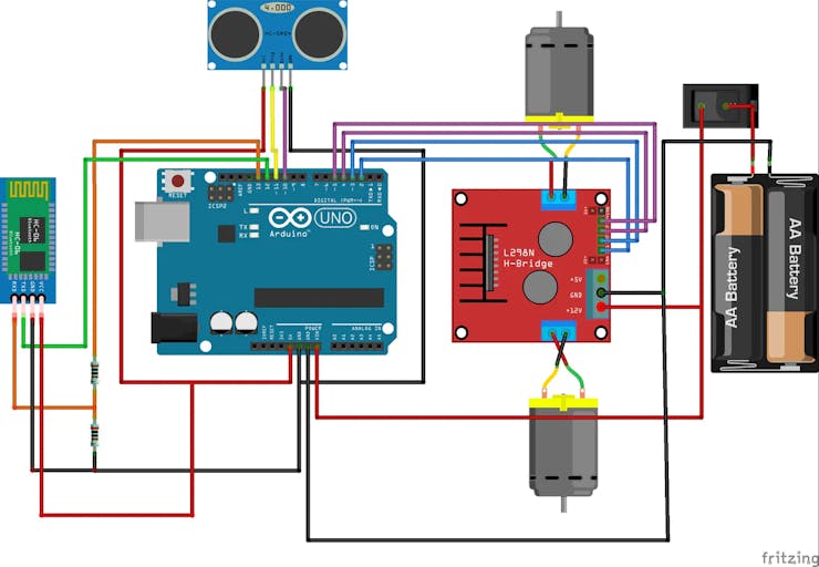

2-Wheel Mobile Robot Electronic Circuit
Below we have the developed circuit. We have the power circuit, which is made up of the two batteries and the button.
After pressing the button, the system energizes the entire circuit of the 2-wheel mobile robot.
All peripherals (bluetooth module, ultrasonic sensor and L293D driver).
Figure 15 - Electronic Schematic of the Mobile Robot with 2 wheels.
The 2 motors are connected to the L293D driver terminals.
The GND and +5V terminals that connect to each other must be connected to the +5V and GND pin bar of the shield board. This process facilitates and reduces the complexity of circuit connections.
