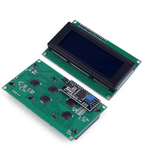

This structure was developed to facilitate elevator control. It consists of a 20x4 LCD and 4 buttons.
Buttons are used to request the elevator to the desired position.
The LCD is intended to allow the exchange of data between the system and the user. Through it, we will be able to present various information:
The LCD used has a SERIAL-I2C converter in order to reduce the number of wires and the complexity of electrical connections with the shield plate.
