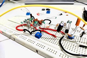

The driver for this coil works by first extracting a crude feedback signal from an antenna near the coil and passes it by a two-diode array. As Power Max demonstrated to me over a Zoom call, these two diodes essentially lock the positive and negative voltage peaks of the AC signal to a set value, preventing dangerously high voltages from entering the sensitive driver circuit.
Next, the signal passes through a resistor, capacitor, and 74HC14 Schmitt trigger, which converts the somewhat sloppy signal into a more functional squarewave that matches the resonant frequency. The new squarewave signal is then pumped into the UCC27425 gate driver IC, where it is amplified. Conveniently, our gate driver chip has something called an enable pin, which is basically like its on-and-off switch. If we feed the interrupter’s signal to the enable pins, we can control the Tesla coil’s pulse duration and frequency, and therefore the spark appearance.
The resulting interrupted signal from our driver circuit is finally sent to a small device known as a gate drive transformer, or GDT. Once properly assembled, the GDT converts the single 12V signal from our driver into two 18 volts signals, which are optimal for switching our transistors. If we phase the GDT correctly, it will cause the transistors to switch the DC voltage from our power supply across the primary coil at the resonant frequency. And since the resonant frequency is detected by the drive circuit, we can stick basically any secondary coil in the primary coil’s field and it will resonate almost perfectly, producing an extremely powerful electrical discharge.
