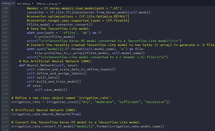

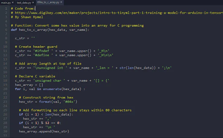

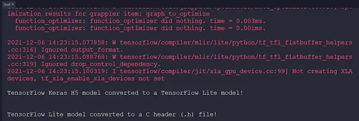

After training and testing my neural network model, I converted it from a TensorFlow Keras H5 model to a C array (.h file) to execute the model on the Wio Terminal. Since the thermal imaging camera is directly connected to the Wio Terminal, the device is capable of detecting irrigation levels (classes) in the field effortlessly.

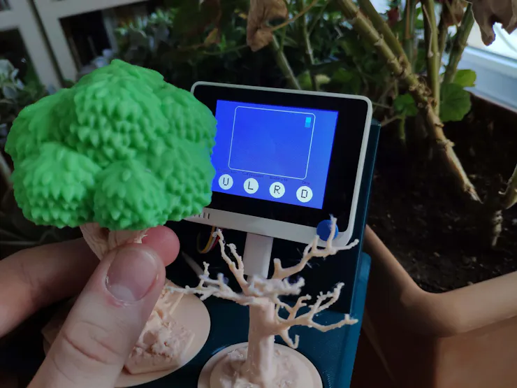

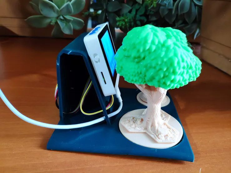

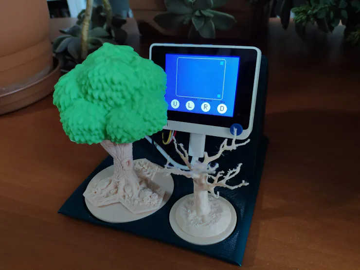

Lastly, to make the device as compact and robust as possible, I designed a forest-themed case (3D printable).

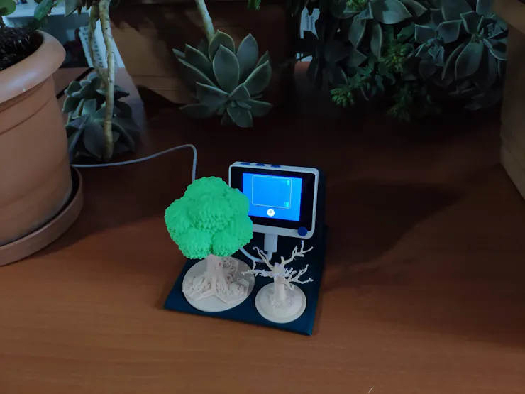

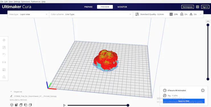

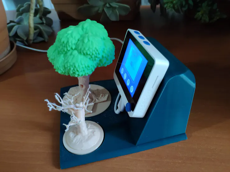

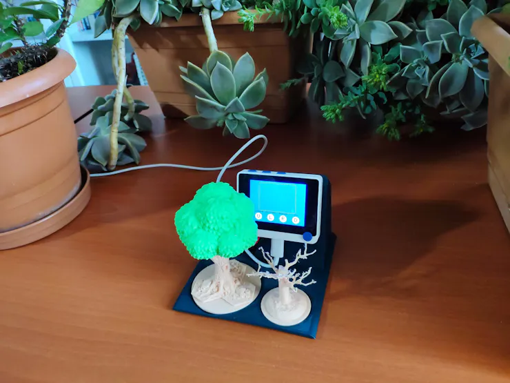

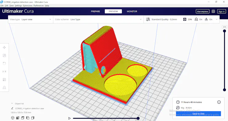

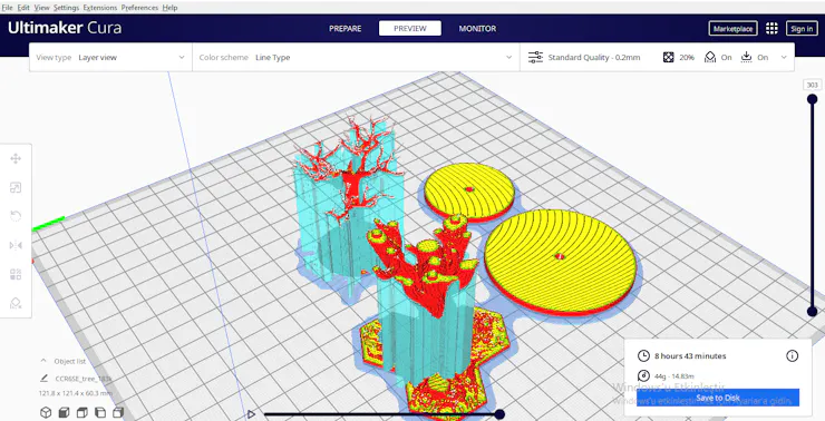

Step 1: Designing and printing a forest-themed case
As a novice in 3D model designing and printing, I decided to design a forest-themed case for this project to create a more compact and robust device operating flawlessly in the field.
I designed the main case and tree bases in Autodesk Fusion 360. You can download their STL files below.
For trees mounted on the main case, I utilized these models from Thingiverse:

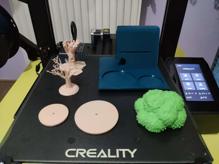

Since I wanted to apply a stylish forest theme to the device, I utilized three PLA filaments with different colors:
- Green
- Beige
- Peak Green
I sliced 3D models (STL files) for each color above in Ultimaker Cura.
Finally, I printed all parts (models) with my Creality CR-6 SE 3D Printer. Although I am a beginner in 3D printing and it is my first 3D printer, I got incredible results effortlessly with the CR-6 SE :)

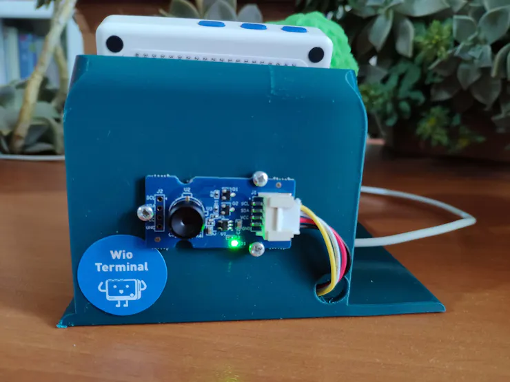

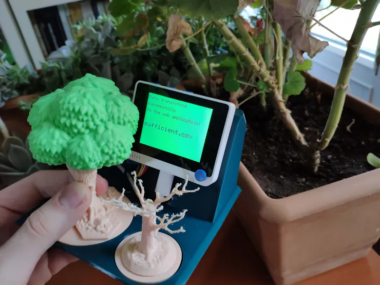

Step 1.1: Assembling the case and its components
After printing all parts (models) successfully, I fastened them together and attached the Wio Terminal and the MLX90641 thermal imaging camera to the case. I used a Grove connection cable (4 Pin) to connect the Wio Terminal to the MLX90641 thermal imaging camera.

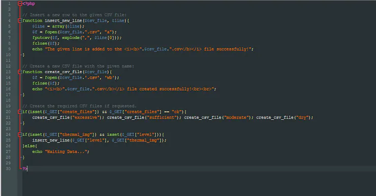

Step 2: Developing a web application in PHP to collate data on irrigation levels by thermal imaging
Before collecting thermal imaging data with the Wio Terminal, I decided to develop a web application in PHP, named irrigation level data logger, so as to save and analyze data easily on my server hosted on Raspberry Pi.
As shown below, the web application consists of one file and has three parameters to create the required CSV files and collect data successfully:
- index.php
Parameters:
- create_files
- thermal_img
- level
⭐ In the insert_new_line function, insert a new row to the given CSV file by using the fputcsv function. To avoid syntax errors in the CSV files, use the explode function to save the given data (array) successfully.
function insert_new_line($csv_file, $line){ $line = array($line); $f = fopen($csv_file.".csv", "a"); fputcsv($f, explode(",", $line[0])); fclose($f); echo "The given line is added to the <i><b>".$csv_file.".csv</b></i> file successfully!";}
⭐ In the create_csv_file function, create a new CSV file with the given file name.
function create_csv_file($csv_file){ $f = fopen($csv_file.'.csv', 'wb'); fclose($f); echo "<i><b>".$csv_file.".csv</b></i> file created successfully!<br><br>";}
⭐ If the create_files parameter is received and equals ok, then create the required CSV files to save and collect thermal imaging data. Each file name represents an irrigation class:
- dry.csv
- moderate.csv
- sufficient.csv
- excessive.csv
if(isset($_GET["create_files"]) && $_GET["create_files"] == "ok"){ create_csv_file("excessive"); create_csv_file("sufficient"); create_csv_file("moderate"); create_csv_file("dry"); }
⭐ If the thermal_img and level parameters are received, then save the given thermal imaging data (array) to the given CSV file (one from above).
if(isset($_GET["thermal_img"]) && isset($_GET["level"])){ insert_new_line($_GET["level"], $_GET["thermal_img"]);}else{ echo "Waiting Data...";}

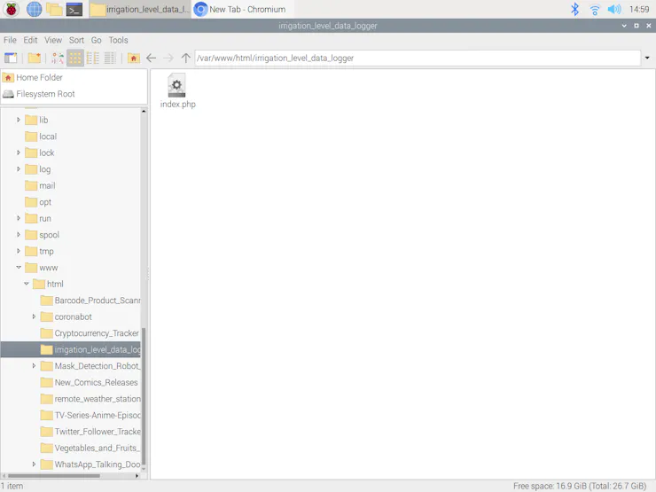

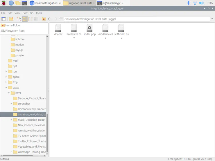

Step 2.1: Setting up the web application on Raspberry Pi
After creating the PHP web application, as mentioned above, I run the application on my server hosted on Raspberry Pi, but you can run it on any server as long as it is a PHP server.
If you want to use Raspberry Pi to run the application, as did I, but you do not know how to set up a LAMP web server on Raspberry Pi, you can inspect my previous tutorial.

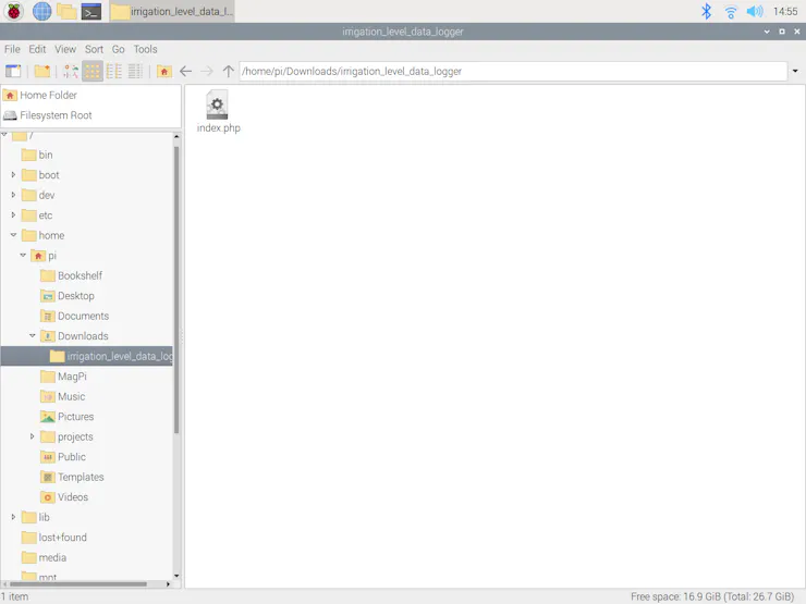

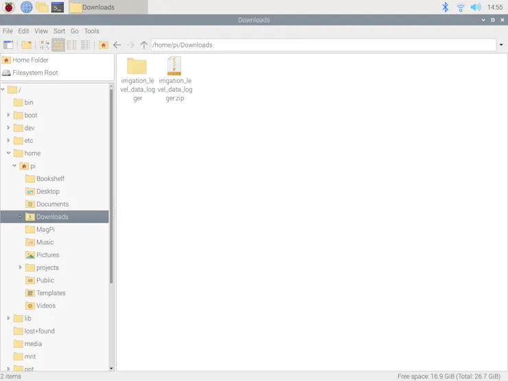

⭐ First of all, install and extract the irrigation_level_data_logger.zip folder.
⭐ Then, move the application folder (irrigation_level_data_logger) to the Apache server (/var/www/html) by using the terminal since the Apache server is a protected location.
sudo mv /home/pi/Downloads/irrigation_level_data_logger /var/www/html/
Step 2.2: Running and testing the web application on Raspberry Pi
⭐ If the parameters are not set, the web application prints: Waiting Data...
http://localhost/irrigation_level_data_logger/
⭐ Since the Apache server is a protected location, it throws an error while attempting to modify the files and folders in it. Therefore, before utilizing the web application to create the required CSV files to save and collect thermal imaging data, change the web application's folder permission by using the terminal:
sudo chmod -R 777 /var/www/html/irrigation_level_data_logger

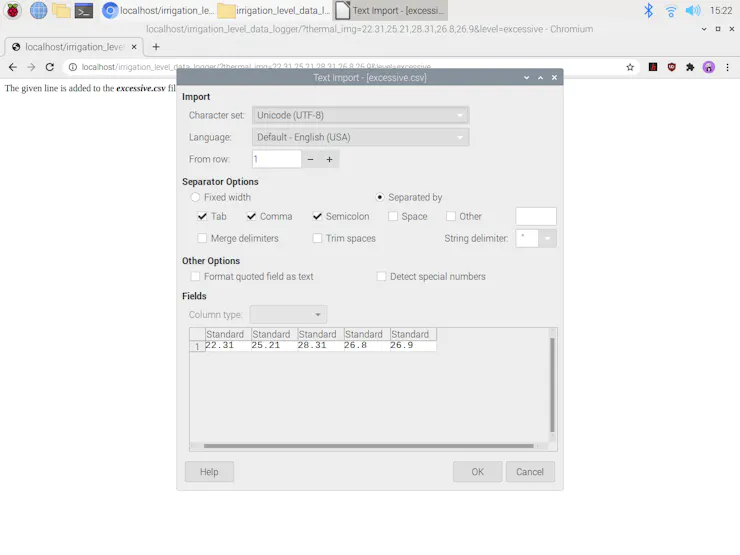

⭐ If the create_files parameter is received and equals ok, the web application creates the required CSV files (shown above) and prints recently created file names.
http://localhost/irrigation_level_data_logger/?create_files=ok
⭐ If the thermal_img (thermal imaging data) and level (CSV file name) parameters are received, the web application processes the given thermal imaging data as an array and inserts it into the given CSV file as a new row.
http://localhost/irrigation_level_data_logger/?thermal_img=<_data_>&level=<_file_name_>
⭐ Then, if the given thermal imaging data is inserted successfully, the application prints:
The given line is added to the <_file_name_>.csv file successfully!

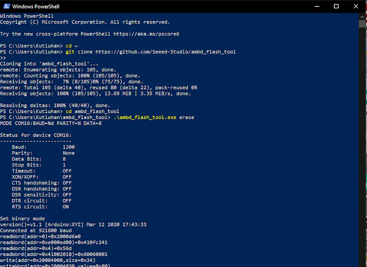

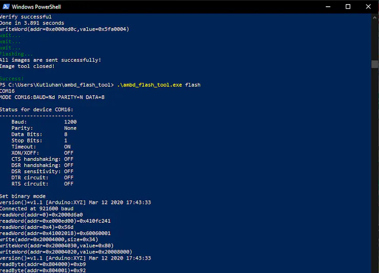

Step 3: Updating and setting up Wio Terminal
Since the Wio Terminal provides Wi-Fi connectivity via the built-in Wireless Core Realtek RTL8720, I employed the Wio Terminal to display and transfer the thermal imaging data generated by the MLX90641 thermal imaging camera. However, before proceeding with the following steps, I needed to update the Wireless Core Firmware to the latest version to enable wireless connectivity since Seeed moved the Wi-Fi software to the new eRPC structure. Fortunately, Seeed provides a tool named ambd_flash_tool to erase the existing firmware on the RTL8720 and also flash the latest firmware.
I updated the Wireless Core Firmware on Windows. You can get more information from here for Mac/ Linux.
#️⃣ Open Windows PowerShell and execute the commands below to download the flashing tool.
cd ~
git clone https://github.com/Seeed-Studio/ambd_flash_tool
#️⃣ Navigate to the ambd_flash_tool directory:
cd ambd_flash_tool
#️⃣ Connect the Wio Terminal to the PC and turn it on.
#️⃣ Execute the following command to erase the initial firmware:
.\ambd_flash_tool.exe erase
#️⃣ After erasing the initial firmware, inside the ambd_flash_tool directory, execute the following command to flash the latest firmware to the RTL8720:
.\ambd_flash_tool.exe flash
After updating the Wireless Core Firmware successfully, I installed the Seeed SAMD Arduino Core on the Arduino IDE and downloaded the required libraries for this project.

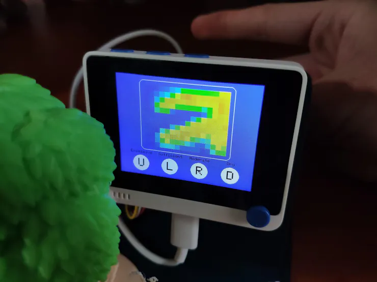

Step 4: Collecting and transferring irrigation level data by thermal imaging w/ Wio Terminal
After setting up the Wio Terminal and enabling Wi-Fi connectivity, I programmed the Wio Terminal to send the thermal imaging data generated by the MLX90641 thermal imaging camera to the web application.
Since I needed to assign irrigation classes (labels) empirically for each thermal imaging array (input) to create a data set, I utilized the 5-way switch integrated into the Wio Terminal to choose among irrigation classes. After selecting an irrigation class, the Wio Terminal sends thermal imaging data (array) to the web application, and the web application saves the transferred data to the chosen class' CSV file:
- Up ➡ Excessive
- Left ➡ Sufficient
- Right ➡ Moderate
- Down ➡ Dry

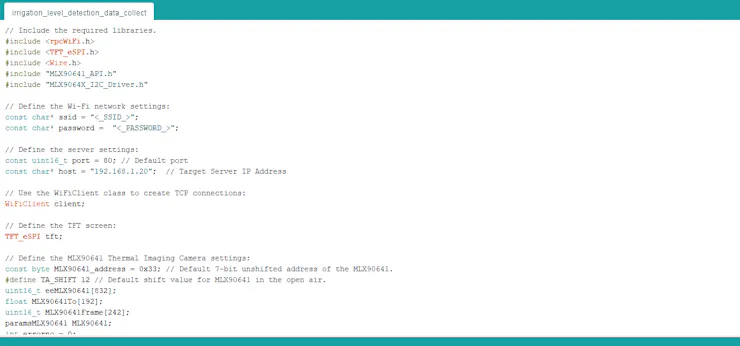

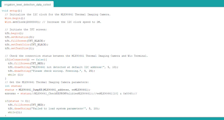

You can download the irrigation_level_detection_data_collect.ino file to try and inspect the code for thermal imaging data collecting with Wio Terminal.
⭐ Include the required libraries.
#include <rpcWiFi.h>#include <TFT_eSPI.h>#include <Wire.h>#include "MLX90641_API.h"#include "MLX9064X_I2C_Driver.h"
⭐ Define the Wi-Fi network settings and use the WiFiClient class to create TCP connections.
const char* ssid = "<_SSID_>";const char* password = "<_PASSWORD_>";// Define the server settings:const uint16_t port = 80; // Default portconst char* host = "192.168.1.20"; // Target Server IP Address// Use the WiFiClient class to create TCP connections:WiFiClient client;
⭐ Define the MLX90641 thermal imaging camera settings.
⭐ Define the maximum and minimum temperature values.
const byte MLX90641_address = 0x33; // Default 7-bit unshifted address of the MLX90641.#define TA_SHIFT 12 // Default shift value for MLX90641 in the open air.uint16_t eeMLX90641[832];float MLX90641To[192];uint16_t MLX90641Frame[242];paramsMLX90641 MLX90641;int errorno = 0;// Define the maximum and minimum temperature values:uint16_t MinTemp = 21;uint16_t MaxTemp = 45;
⭐ Initialize the I2C clock for the MLX90641 thermal imaging camera.
Wire.begin(); Wire.setClock(2000000); // Increase the I2C clock speed to 2M.
⭐ Initiate the TFT screen.
tft.begin(); tft.setRotation(3); tft.fillScreen(TFT_BLACK); tft.setTextColor(TFT_BLACK); tft.setTextSize(1);
⭐ Check the connection status between the MLX90641 thermal imaging camera and the Wio Terminal.
if(isConnected() == false){ tft.fillScreen(TFT_RED); tft.drawString("MLX90641 not detected at default I2C address!", 5, 10); tft.drawString("Please check wiring. Freezing.", 5, 25); while (1); }
⭐ Get the MLX90641 thermal imaging camera parameters. Once params are extracted, release the eeMLX90641 array.
MLX90641_SetRefreshRate(MLX90641_address, 0x05); // Set rate to 16Hz.

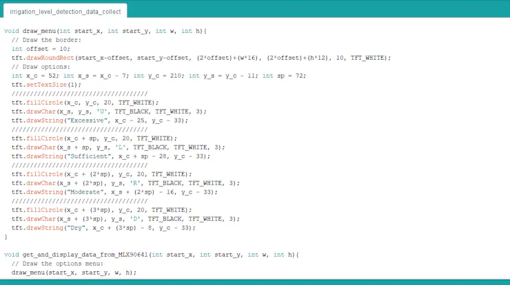

⭐ In the draw_menu function, draw the irrigation class options (Up, Left, Right, Down) and the border of the simple image generated from the thermal imaging array (16x12).
void draw_menu(int start_x, int start_y, int w, int h){ // Draw the border: int offset = 10; tft.drawRoundRect(start_x-offset, start_y-offset, (2*offset)+(w*16), (2*offset)+(h*12), 10, TFT_WHITE); // Draw options: int x_c = 52; int x_s = x_c - 7; int y_c = 210; int y_s = y_c - 11; int sp = 72; tft.setTextSize(1); ///////////////////////////////////// tft.fillCircle(x_c, y_c, 20, TFT_WHITE); tft.drawChar(x_s, y_s, 'U', TFT_BLACK, TFT_WHITE, 3); tft.drawString("Excessive", x_c - 25, y_c - 33); ///////////////////////////////////// tft.fillCircle(x_c + sp, y_c, 20, TFT_WHITE); tft.drawChar(x_s + sp, y_s, 'L', TFT_BLACK, TFT_WHITE, 3); tft.drawString("Sufficient", x_c + sp - 28, y_c - 33); ///////////////////////////////////// tft.fillCircle(x_c + (2*sp), y_c, 20, TFT_WHITE); tft.drawChar(x_s + (2*sp), y_s, 'R', TFT_BLACK, TFT_WHITE, 3); tft.drawString("Moderate", x_s + (2*sp) - 16, y_c - 33); ///////////////////////////////////// tft.fillCircle(x_c + (3*sp), y_c, 20, TFT_WHITE); tft.drawChar(x_s + (3*sp), y_s, 'D', TFT_BLACK, TFT_WHITE, 3); tft.drawString("Dry", x_c + (3*sp) - 8, y_c - 33);}

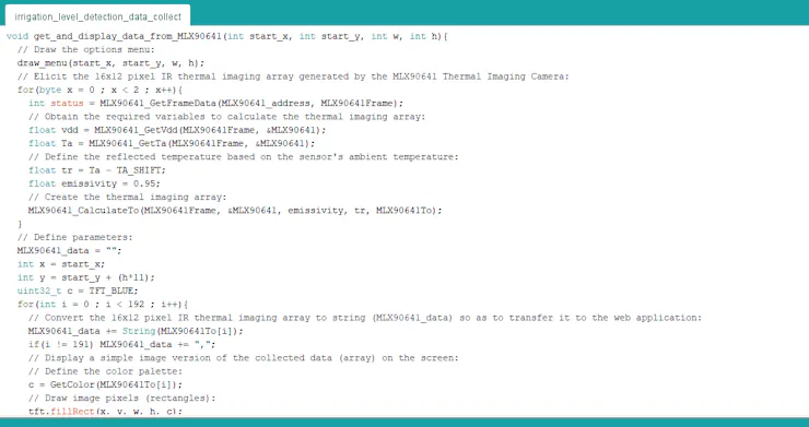

⭐ In the get_and_display_data_from_MLX90641 function, after executing the draw_menu function, elicit the 16x12 pixel IR thermal imaging array generated by the MLX90641 thermal imaging camera:
⭐ Obtain the required variables to calculate the thermal imaging array.
⭐ Define the reflected temperature based on the sensor's ambient temperature.
⭐ Create the thermal imaging array.
⭐ Then, convert the 16x12 pixel IR thermal imaging array to string (MLX90641_data) so as to transfer it to the web application.
⭐ To display a simple image version of the recently generated thermal imaging array (16x12) on the screen, assign colors for each element (pixel) in the array by using the GetColor function.
⭐ Finally, draw each pixel (rectangle) to create a simple image version of the given thermal imaging array.
void get_and_display_data_from_MLX90641(int start_x, int start_y, int w, int h){ // Draw the options menu: draw_menu(start_x, start_y, w, h); // Elicit the 16x12 pixel IR thermal imaging array generated by the MLX90641 Thermal Imaging Camera: for(byte x = 0 ; x < 2 ; x++){ int status = MLX90641_GetFrameData(MLX90641_address, MLX90641Frame); // Obtain the required variables to calculate the thermal imaging array: float vdd = MLX90641_GetVdd(MLX90641Frame, &MLX90641); float Ta = MLX90641_GetTa(MLX90641Frame, &MLX90641); // Define the reflected temperature based on the sensor's ambient temperature: float tr = Ta - TA_SHIFT; float emissivity = 0.95; // Create the thermal imaging array: MLX90641_CalculateTo(MLX90641Frame, &MLX90641, emissivity, tr, MLX90641To); } // Define parameters: MLX90641_data = ""; int x = start_x; int y = start_y + (h*11); uint32_t c = TFT_BLUE; for(int i = 0 ; i < 192 ; i++){ // Convert the 16x12 pixel IR thermal imaging array to string (MLX90641_data) so as to transfer it to the web application: MLX90641_data += String(MLX90641To[i]); if(i != 191) MLX90641_data += ","; // Display a simple image version of the collected data (array) on the screen: // Define the color palette: c = GetColor(MLX90641To[i]); // Draw image pixels (rectangles): tft.fillRect(x, y, w, h, c); x = x + w; // Start a new row: int l = i + 1; if (l%16 == 0) { x = start_x; y = y - h; } }}

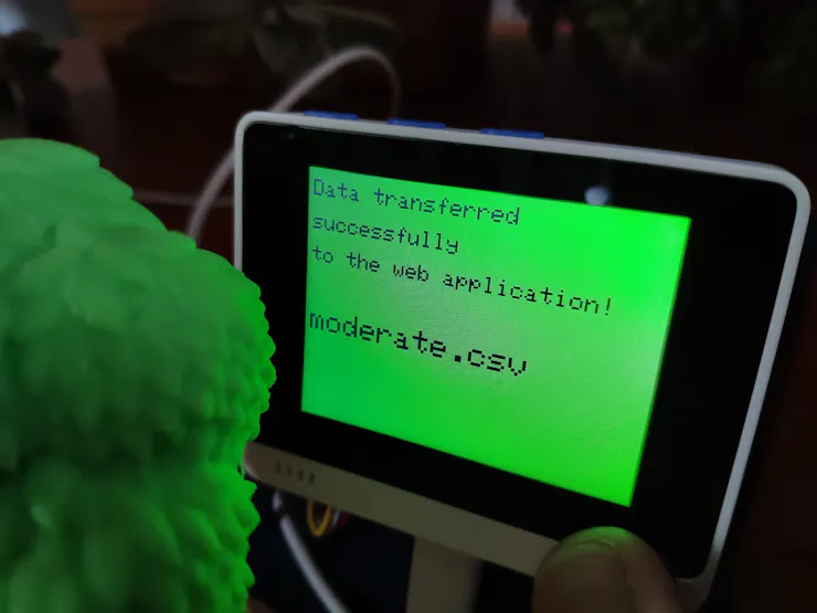

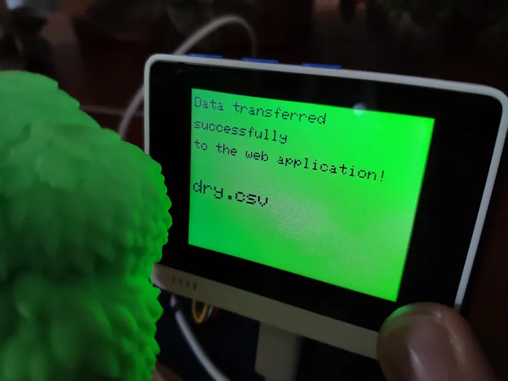

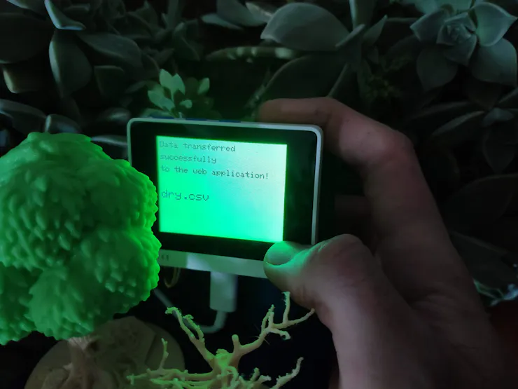

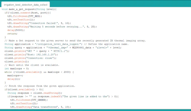

⭐ In the make_a_get_request function, make a Get request to the given server to send the recently generated IR thermal imaging array to the given web application (irrigation_level_data_logger).
⭐ Wait until the client is available, then fetch the response from the given application.
⭐ If the web application saves the transferred thermal imaging data (array) to the chosen irrigation class' CSV file, then print the message below, including the CSV file name:
Data transferred successfully to the web application!
<file_name>.csv
void make_a_get_request(String level){ if(!client.connect(host, port)){ tft.fillScreen(TFT_RED); tft.setTextSize(1); tft.drawString("Connection failed!", 5, 10); tft.drawString("Waiting 5 seconds before retrying...", 5, 25); delay(5000); return; } // Make a Get request to the given server to send the recently generated IR thermal imaging array. String application = "/irrigation_level_data_logger/"; // Define the application name. String query = application + "?thermal_img=" + MLX90641_data + "&level=" + level; client.println("GET " + query + " HTTP/1.1"); client.println("Host: 192.168.1.20"); client.println("Connection: close"); client.println(); // Wait until the client is available. int maxloops = 0; while (!client.available() && maxloops < 2000) { maxloops++; delay(1); } // Fetch the response from the given application. if(client.available() > 0){ String response = client.readString(); if(response != "" && response.indexOf("The given line is added to the") > 0){ tft.fillScreen(TFT_GREEN); tft.setTextSize(2); tft.drawString("Data transferred", 5, 10); tft.drawString("successfully", 5, 40); tft.drawString("to the web application! ", 5, 70); tft.setTextSize(3); tft.drawString(level + ".csv", 5, 130); } }else{ tft.fillScreen(TFT_RED); tft.setTextSize(2); tft.drawString("Client Timeout!", 5, 10); } // Stop the client: client.stop(); delay(3000); tft.fillScreen(TFT_BLUE);}

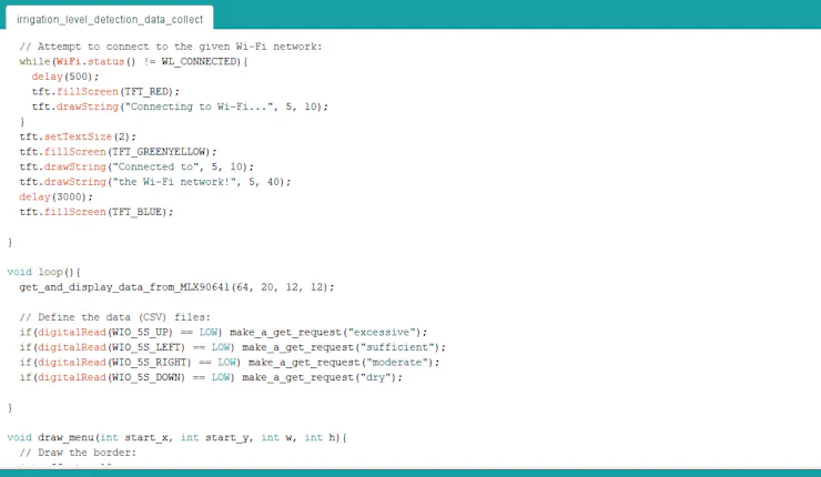

⭐ According to the movement of the 5-way switch (Up, Left, Right, Down), send the recently generated thermal imaging array with the chosen irrigation class name to the web application.
get_and_display_data_from_MLX90641(64, 20, 12, 12); // Define the data (CSV) files: if(digitalRead(WIO_5S_UP) == LOW) make_a_get_request("excessive"); if(digitalRead(WIO_5S_LEFT) == LOW) make_a_get_request("sufficient"); if(digitalRead(WIO_5S_RIGHT) == LOW) make_a_get_request("moderate"); if(digitalRead(WIO_5S_DOWN) == LOW) make_a_get_request("dry");

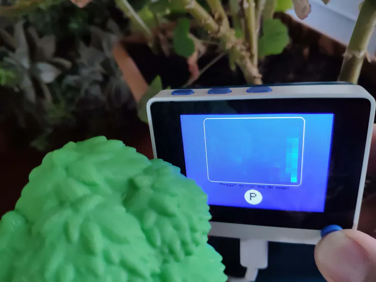

Step 4.1: Creating the irrigation level data set by thermal imaging

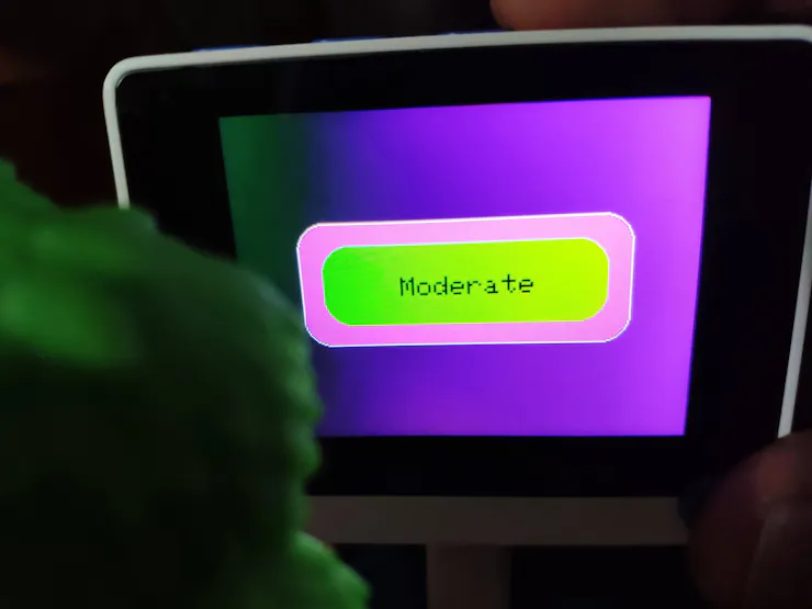

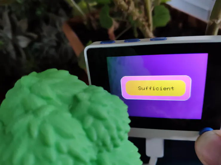

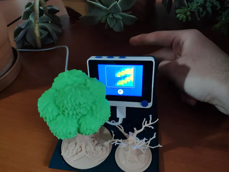

After uploading and running the code for thermal imaging data collecting on the Wio Terminal:

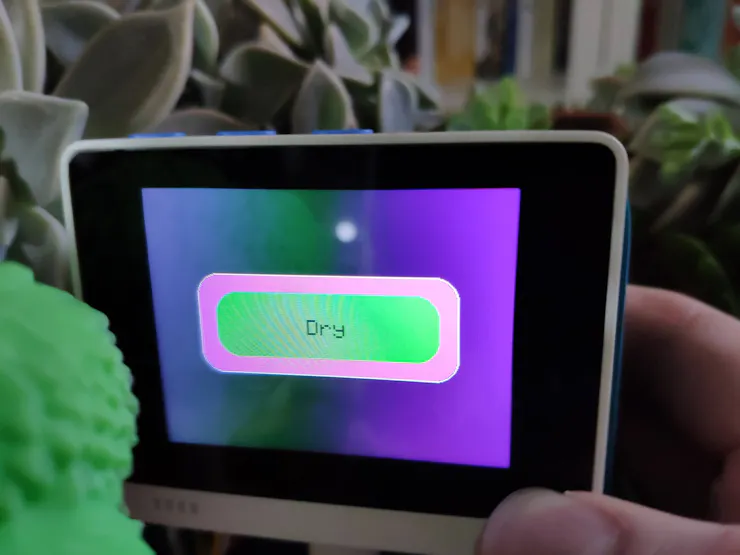

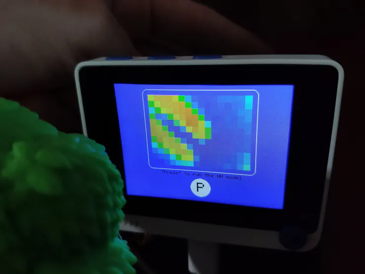

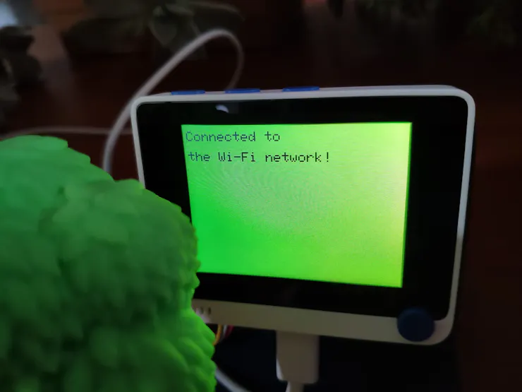

🌿💧 The device displays thermal imaging arrays as a real-time video stream on the screen.
🌿💧 When the Wi-Fi module is connected to the given Wi-Fi network successfully, the device prints: Connected to the Wi-Fi network!
🌿💧 If the 5-way switch is positioned to the Up, the device sends the recently generated thermal imaging array to the web application with the excessive irrigation class. Then, if the web application saves the given thermal imaging data successfully to the excessive.csv file, the device shows:
🌿💧 If the 5-way switch is positioned to the Left, the device sends the recently generated thermal imaging array to the web application with the sufficient irrigation class. Then, if the web application saves the given thermal imaging data successfully to the sufficient.csv file, the device shows:
🌿💧 If the 5-way switch is positioned to the Right, the device sends the recently generated thermal imaging array to the web application with the moderate irrigation class. Then, if the web application saves the given thermal imaging data successfully to the moderate.csv file, the device shows:
🌿💧 If the 5-way switch is positioned to the Down, the device sends the recently generated thermal imaging array to the web application with the dry irrigation class. Then, if the web application saves the given thermal imaging data successfully to the dry.csv file, the device shows:

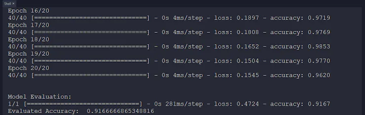

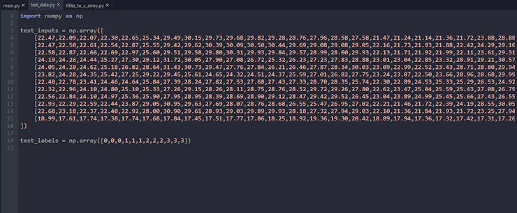

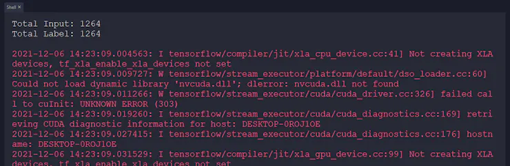

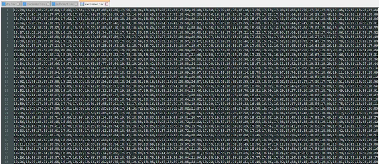

To train my neural network model so as to make predictions on the irrigation levels (classes) based on thermal imaging, I needed to create a data set with eminent validity. Therefore, I utilized the device to collect thermal imaging data from my plants with different irrigation levels for over one month.
Finally, I had a data set with 1264 inputs in total under these CSV files in the web application:
- dry.csv
- moderate.csv
- sufficient.csv
- excessive.csv

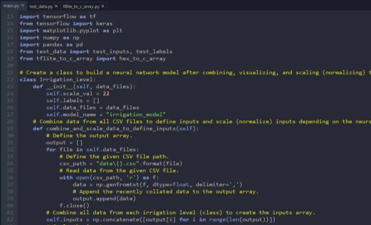

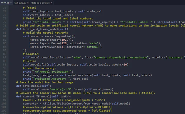

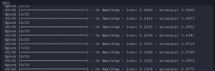

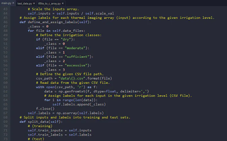

Step 5: Building an Artificial Neural Network (ANN) with TensorFlow
When I completed collating my irrigation level data set by thermal imaging, I had started to work on my artificial neural network model (ANN) to make predictions on the irrigation levels (classes) based on thermal imaging.
I decided to create my neural network model with TensorFlow in Python. Thus, first of all, I followed the steps below to grasp a better understanding of my data set so as to train my model accurately:
- Data Merging (Combining)

As explained in the previous steps, the web application saves the thermal imaging data under four different CSV files according to the empirically chosen irrigation classes. Since the thermal imaging data was already separated by irrigation classes, I preprocessed my data set effortlessly to assign labels for each thermal imaging array (input):

First of all, I created a class named Irrigation_Level in the main.py file to execute the following functions precisely.
⭐ Include the required modules.
import tensorflow as tffrom tensorflow import kerasimport matplotlib.pyplot as pltimport numpy as npimport pandas as pdfrom test_data import test_inputs, test_labelsfrom tflite_to_c_array import hex_to_c_array
⭐ In the __init__ function, define the required variables for building the neural network model.
def __init__(self, data_files): self.scale_val = 22 self.labels = [] self.data_files = data_files self.model_name = "irrigation_model"
I will elucidate each file and function in detail in the following steps.
Step 5.1: Merging and scaling (normalizing) the input data and assigning labels (irrigation classes)
Since the thermal imaging data is separated under four different CSV files with irrigation class names in the web application, as shown below, I needed to merge (combine) and preprocess all data before proceeding.
To be able to read CSV files in Python, I moved all CSV files from the web application to the data folder:
- dry.csv
- moderate.csv
- sufficient.csv
- excessive.csv
After merging (combining) all thermal imaging data, I utilized each thermal imaging array generated by the MLX90641 thermal imaging camera in my data set as an input. Then, I scaled (normalized) each input to format the input data properly.
⭐ In the combine_and_scale_data_to_define_inputs funtion, merge (combine) thermal imaging data from all CSV files to create inputs:
⭐ Define the output array.
⭐ Read data from all CSV files in the given file list as NumPy arrays by using the genfromtxt function.
⭐ Then, append the recently collated data for each CSV file as NumPy arrays to the output array.
⭐ Finally, merge all NumPy arrays in the output array as the inputs NumPy array by using the concatenate function.
⭐ Each input includes 192 parameters [shape=(192, )]:
- [22.31, 22.66, 22.39, 22.25, 22.80, 25.00, 28.80, 28.84,...]
⭐ After creating the inputs array, divide it by 22 (scale value) to format the input data properly.
def combine_and_scale_data_to_define_inputs(self): # Define the output array. output = [] for file in self.data_files: # Define the given CSV file path. csv_path = "data\{}.csv".format(file) # Read data from the given CSV file. with open(csv_path, 'r') as f: data = np.genfromtxt(f, dtype=float, delimiter=',') # Append the recently collated data to the output array. output.append(data) f.close() # Combine all data from each irrigation level (class) to create the inputs array. self.inputs = np.concatenate([output[i] for i in range(len(output))]) # Scale the inputs array. self.inputs = self.inputs / self.scale_val
After creating inputs from thermal imaging arrays, I needed to assign labels to train my neural network model.
⭐ In the define_and_assign_labels function, define irrigation classes for each CSV file in the given file list:
- 0 — Dry
- 1 — Moderate
- 2 — Sufficient
- 3 — Excessive
⭐ Read data from all CSV files.
⭐ For each thermal imaging array (input) in a given CSV file, append its assigned label (irrigation class) [0 - 3] to the labels array.
⭐ Then, convert the labels array to a NumPy array by using the asarray function.
def define_and_assign_labels(self): _class = 0 for file in self.data_files: # Define the irrigation classes: if (file == "dry"): _class = 0 elif (file == "moderate"): _class = 1 elif (file == "sufficient"): _class = 2 elif (file == "excessive"): _class = 3 # Define the given CSV file path. csv_path = "data\{}.csv".format(file) # Read data from the given CSV file. with open(csv_path, 'r') as f: data = np.genfromtxt(f, dtype=float, delimiter=',') # Assign labels for each input in the given irrigation level (CSV file). for i in range(len(data)): self.labels.append(_class) f.close() self.labels = np.asarray(self.labels)

Then, I built my artificial neural network model (ANN) by using Keras and trained it with the training set for twenty epochs.
You can inspect these tutorials to learn about activation functions, loss functions, epochs, etc.
def build_and_train_model(self): # Build the neural network: self.model = keras.Sequential([ keras.Input(shape=(192,)), keras.layers.Dense(128, activation='relu'), keras.layers.Dense(4, activation='softmax') ]) # Compile: self.model.compile(optimizer='adam', loss="sparse_categorical_crossentropy", metrics=['accuracy']) # Train: self.model.fit(self.train_inputs, self.train_labels, epochs=20) ...
After training with the training set (1264 inputs and labels), the accuracy of my neural network model is between 0.93 and 0.97.
Step 5.3: Evaluating the model accuracy and converting the model to a C array
After building and training my artificial neural network model, I tested its accuracy and validity by utilizing the testing data set (inputs and labels).
The evaluated accuracy of the model is 0.9167.
... # Test the accuracy: print("\n\nModel Evaluation:") test_loss, test_acc = self.model.evaluate(self.test_inputs, self.test_labels) print("Evaluated Accuracy: ", test_acc)
After evaluating my neural network model, I saved it as a TensorFlow Keras H5 model (irrigation_model.h5) to the model folder.
def save_model(self): self.model.save("model/{}.h5".format(self.model_name))
However, running a TensorFlow Keras H5 model on the Wio Terminal to make predictions on the irrigation levels (classes) is not eligible and efficient considering size, latency, and power consumption.
Thus, I converted my neural network model from a TensorFlow Keras H5 model (.h5) to a TensorFlow Lite model (.tflite). Then, I modified the TensorFlow Lite model to create a C array (.h file) to run the model on the Wio Terminal successfully.
To alter the TensorFlow Lite model to a C array, I applied the hex_to_c_array function copied directly from this tutorial to the tflite_to_c_array.py file.
⭐ In the convert_TF_model function, convert the recently trained and evaluated model to a TensorFlow Lite model by applying the TensorFlow Lite converter (tf.lite.TFLiteConverter.from_keras_model).
⭐ Then, save the converted TensorFlow Lite model (irrigation_model.tflite) to the model folder.
⭐ Modify the recently created TensorFlow Lite model to a C array (.h file) by executing the hex_to_c_array function.
⭐ Finally, save the converted C array (irrigation_model.h) to the model folder.
def convert_TF_model(self, path): #model = tf.keras.models.load_model(path + ".h5") converter = tf.lite.TFLiteConverter.from_keras_model(self.model) #converter.optimizations = [tf.lite.Optimize.DEFAULT] #converter.target_spec.supported_types = [tf.float16] tflite_model = converter.convert() # Save the TensorFlow Lite model. with open(path + '.tflite', 'wb') as f: f.write(tflite_model) print("\r\nTensorFlow Keras H5 model converted to a TensorFlow Lite model!\r\n") # Convert the recently created TensorFlow Lite model to hex bytes (C array) to generate a .h file string. with open("model/{}.h".format(self.model_name), 'w') as file: file.write(hex_to_c_array(tflite_model, self.model_name)) print("\r\nTensorFlow Lite model converted to a C header (.h) file!\r\n")

After importing and setting up the model (as a C array) on the Wio Terminal successfully, I run the model to detect irrigation levels (classes) of various plants in my garden and balcony.
After executing the code for running the model on the Wio Terminal:
🌿💧 If the 5-way switch is pressed, the device runs inference with the model by employing the most recently generated thermal imaging array as the input array.
🌿💧 Then, the device displays the output, which represents the most accurate label (irrigation class) predicted by the model.
🌿💧 Each irrigation level (class) as the output has its unique color code:
- Dry ➡ Green
- Moderate ➡ Greenyellow
- Sufficient ➡ Orange
- Excessive ➡ Red
🌿💧 As far as my experiments go, the device works impeccably while detecting irrigation levels (classes) of various plants in different conditions :)
