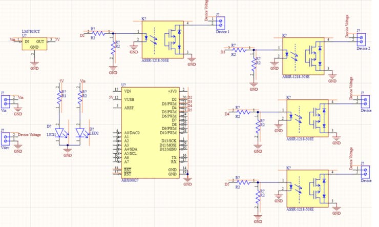

So I used Altium Designer to draw the circuit and design the PCB. It is a powerful tool that can be used to design and create your own PCBs for your project as well as complex and multiplayer PCBs for industrial use. I will leave the link to the free trial version in the description.
Also, if you are planning to buy it, there is an awesome 30% discount by purchasing it using the link below! So do make use of it!The board has two voltage inputs: one for the Arduino and other components, and another for driving the electronic devices connected to the relay, which will be controlled by an Android App.
Here, I’ll be connecting a 12 V DC adapter to power the Pumps.
A 7805 regulator is used to regulate the input voltage. The 7805 is a 5V regulator that converts an input voltage of 7-32V to a consistent 5V DC supply by using a 7-32V adjustable voltage conversion.

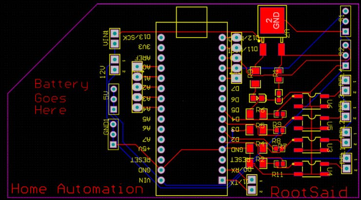

After the circuit was created and tested, I drew up a PCB layout for our watering system so I can simply mount your Arduino Nano 33 IOT and SSR, connect everything without having wires or cables hanging around. The board is compact and lightweight, and it may be run on a 9V battery or a 9-12 V power adapter.

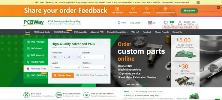

I ordered PCB from PCBWay. PCBWay is a PCB manufacturer specializing in PCB prototyping, low-volume production, and neat and tidy PCB assembly.

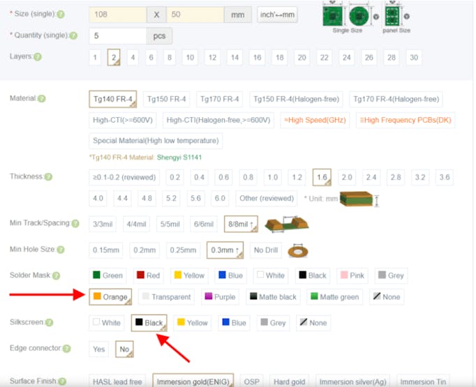

To order your PCB from PCBWay, go to the PCBWay website and fill in the basic board details in the instant order form. From there you will be directed to a form where you can provide more elaborate board details. Update your board information in the PCB specification screen. On the next screen, you should be able to upload your Gerber file and submit it for review. Once the review is completed, all that is left is to add to the cart, make payment, and wait for your PCBs to arrive.

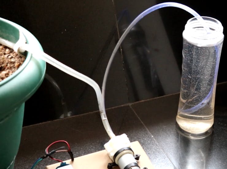

Now all you have to do is start the app, enter the IP address of the Arduino and port it is listening to (5005). Load the IP and Port using the link button and navigate to the Home Automation Tab. Now, you should be able to turn on and off different pumps using the buttons.
You can now use this simple project to control pumps connected to your Arduino and turn it on and off.
