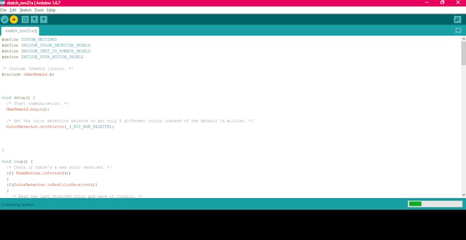

Step 5: Write your code inside Arduino sketch
#define CUSTOM_SETTINGS #define INCLUDE_COLOR_DETECTOR_SHIELD #define INCLUDE_TEXT_TO_SPEECH_SHIELD #define INCLUDE_PUSH_BUTTON_SHIELD /* Include 1Sheeld library. */ #include void setup() { /* Start communication. */ OneSheeld.begin(); /* Set the color detection palette to get only 8 different colors instead of the default 16 million. */ ColorDetector.setPalette(_3_BIT_RGB_PALETTE); } void loop() { /* Check if there's a new color received. */ if( PushButton.isPressed()) { if(ColorDetector.isNewColorReceived()) { /* Read the last received color and save it locally. */ Color readColor = ColorDetector.getLastColor(); /* Get red, blue and green components values. */ byte redValue = readColor.getRed(); byte greenValue = readColor.getGreen(); byte blueValue = readColor.getBlue(); colorName(redValue,greenValue,blueValue); } delay(1000); } } /* indentify the color using the values of red ,green,and blue and say the color name */ void colorName(byte redvalue,byte greenvalue ,byte bluevalue) { if (redvalue== 0 && greenvalue== 0 && bluevalue == 0) TextToSpeech.say("black"); else if (redvalue== 0 && greenvalue== 0 && bluevalue == 85) TextToSpeech.say("nave"); else if (redvalue== 0 && greenvalue== 0 && bluevalue == 170) TextToSpeech.say("dark blue"); else if (redvalue== 0 && greenvalue== 0 && bluevalue == 255) TextToSpeech.say("blue"); else if (redvalue== 0 && greenvalue== 85 && bluevalue == 0) TextToSpeech.say("dark green"); else if (redvalue== 0 && greenvalue== 85 && bluevalue == 85) TextToSpeech.say("green"); else if (redvalue== 0 && greenvalue== 85 && bluevalue == 170) TextToSpeech.say("blue"); else if (redvalue== 0 && greenvalue== 85 && bluevalue == 255) TextToSpeech.say("blue"); else if (redvalue== 0 && greenvalue== 170 && bluevalue == 0) TextToSpeech.say("green"); else if (redvalue== 0 && greenvalue== 170 && bluevalue == 85) TextToSpeech.say("dark green"); else if (redvalue== 0 && greenvalue== 170 && bluevalue == 170) TextToSpeech.say("sky blue"); else if (redvalue== 0 && greenvalue== 170 && bluevalue == 255) TextToSpeech.say("light blue"); else if (redvalue== 0 && greenvalue== 255 && bluevalue == 0) TextToSpeech.say("green"); else if (redvalue== 0 && greenvalue== 255 && bluevalue == 85) TextToSpeech.say("spring green"); else if (redvalue== 0 && greenvalue== 255 && bluevalue == 170) TextToSpeech.say("light green"); else if (redvalue== 0 && greenvalue== 255 && bluevalue == 255) TextToSpeech.say("aqua"); else if (redvalue== 85 && greenvalue== 0 && bluevalue == 0) TextToSpeech.say("dark red"); else if (redvalue== 85 && greenvalue== 0 && bluevalue == 85) TextToSpeech.say("dark purple"); else if (redvalue== 85 && greenvalue== 0 && bluevalue == 170) TextToSpeech.say("purple"); else if (redvalue== 85 && greenvalue== 0 && bluevalue == 255) TextToSpeech.say("blue"); else if (redvalue== 85 && greenvalue== 85 && bluevalue == 0) TextToSpeech.say("yellow"); else if (redvalue== 85 && greenvalue== 85 && bluevalue == 85) TextToSpeech.say("gray"); else if (redvalue== 85 && greenvalue== 85 && bluevalue == 170) TextToSpeech.say("blue"); else if (redvalue== 85 && greenvalue== 85 && bluevalue == 255) TextToSpeech.say("light blue"); else if (redvalue== 85 && greenvalue== 170 && bluevalue == 0) TextToSpeech.say("green"); else if (redvalue== 85 && greenvalue== 170 && bluevalue == 85) TextToSpeech.say("lame green"); else if (redvalue== 85 && greenvalue== 170 && bluevalue == 170) TextToSpeech.say("green"); else if (redvalue== 85 && greenvalue== 170 && bluevalue == 255) TextToSpeech.say("light blue"); else if (redvalue== 85 && greenvalue== 255 && bluevalue == 0) TextToSpeech.say("light green"); else if (redvalue== 85 && greenvalue== 255 && bluevalue == 85) TextToSpeech.say("green"); else if (redvalue== 85 && greenvalue== 255 && bluevalue == 170) TextToSpeech.say("blue green"); else if (redvalue== 85 && greenvalue== 255 && bluevalue == 255) TextToSpeech.say("aqua"); else if (redvalue== 170 && greenvalue== 0 && bluevalue == 0) TextToSpeech.say("red"); else if (redvalue== 170 && greenvalue== 0 && bluevalue == 85) TextToSpeech.say("dark pink"); else if (redvalue== 170 && greenvalue== 0 && bluevalue == 170) TextToSpeech.say("purple"); else if (redvalue== 170 && greenvalue== 0 && bluevalue == 255) TextToSpeech.say("purple"); else if (redvalue== 170 && greenvalue== 85 && bluevalue == 0) TextToSpeech.say("light brown"); else if (redvalue== 170 && greenvalue== 85 && bluevalue == 85) TextToSpeech.say("pale pink"); else if (redvalue== 170 && greenvalue== 85 && bluevalue == 170) TextToSpeech.say("purple"); else if (redvalue== 170 && greenvalue== 85 && bluevalue == 255) TextToSpeech.say("meduim purple"); else if (redvalue== 170 && greenvalue== 170 && bluevalue == 0) TextToSpeech.say("yellow"); else if (redvalue== 170 && greenvalue== 170 && bluevalue == 85) TextToSpeech.say("pale green"); else if (redvalue== 170 && greenvalue== 170 && bluevalue == 170) TextToSpeech.say("gray"); else if (redvalue== 170 && greenvalue== 170 && bluevalue == 255) TextToSpeech.say("blue"); else if (redvalue== 170 && greenvalue== 255 && bluevalue == 0) TextToSpeech.say("light green"); else if (redvalue== 170 && greenvalue== 255 && bluevalue == 85) TextToSpeech.say("green"); else if (redvalue== 170 && greenvalue== 255 && bluevalue == 170) TextToSpeech.say("green"); else if (redvalue== 170 && greenvalue== 255 && bluevalue == 255) TextToSpeech.say("light blue"); else if (redvalue== 255 && greenvalue== 0 && bluevalue == 0) TextToSpeech.say("red"); else if (redvalue== 255 && greenvalue== 0 && bluevalue == 85) TextToSpeech.say("pink"); else if (redvalue== 255 && greenvalue== 0 && bluevalue == 170) TextToSpeech.say("pink"); else if (redvalue== 255 && greenvalue== 0 && bluevalue == 255) TextToSpeech.say("pink"); else if (redvalue== 255 && greenvalue== 85 && bluevalue == 0) TextToSpeech.say("orange"); else if (redvalue== 255 && greenvalue== 85 && bluevalue == 85) TextToSpeech.say("lame pink"); else if (redvalue== 255 && greenvalue== 85 && bluevalue == 170) TextToSpeech.say("pink"); else if (redvalue== 255 && greenvalue== 85 && bluevalue == 255) TextToSpeech.say("pink"); else if (redvalue== 255 && greenvalue== 170 && bluevalue == 0) TextToSpeech.say("orange"); else if (redvalue== 255 && greenvalue== 170 && bluevalue == 85) TextToSpeech.say("light orange"); else if (redvalue== 255 && greenvalue== 170 && bluevalue == 170) TextToSpeech.say("pink"); else if (redvalue== 255 && greenvalue== 170 && bluevalue == 255) TextToSpeech.say("pink"); else if (redvalue== 255 && greenvalue== 255 && bluevalue == 0) TextToSpeech.say("yellow"); else if (redvalue== 255 && greenvalue== 255 && bluevalue == 85) TextToSpeech.say("light yellow"); else if (redvalue== 255 && greenvalue== 255 && bluevalue == 170) TextToSpeech.say("paje"); else if (redvalue== 255 && greenvalue== 255 && bluevalue == 255) TextToSpeech.say("white"); }

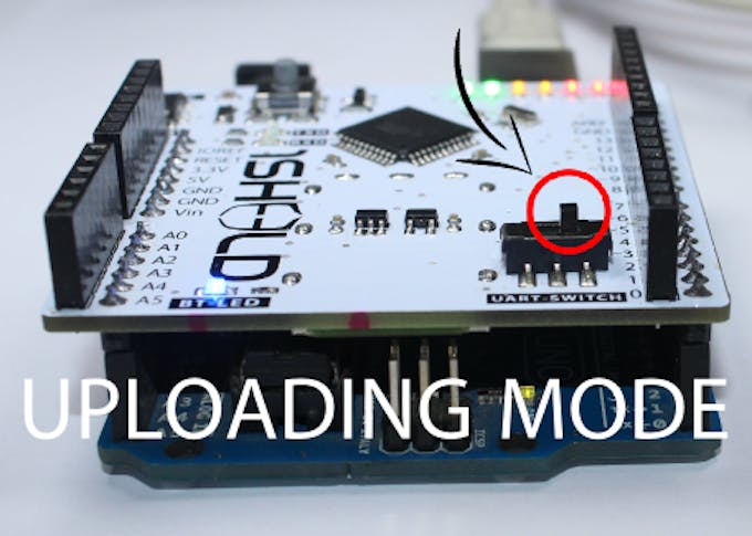

Step 6: compile and Upload your sketch to your Arduino board
Switch 1Sheeld to the Uploading-mode before you upload your sketch to the Arduino board to avoid serial conflicts between 1Sheeld and Arduino.
Upload mode is turned on when the UART switch is pushed away from the 1Sheeld logo.

And then press the Upload button in the IDE, and upload your code to Arduino.
![](https://hackster.imgix.net/uploads/attachments/228639/SyJvzkFpn21uPirtQc4C.png?auto=compress%2Cformat&w=680&h=510&fit=max)

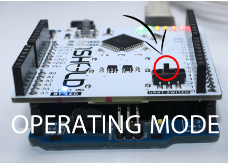

after you completed your upload you need to switch 1Sheeld back to the operating mode
![](https://hackster.imgix.net/uploads/attachments/228645/GiUKrhK6n9cCs8146XdX.png?auto=compress%2Cformat&w=680&h=510&fit=max)

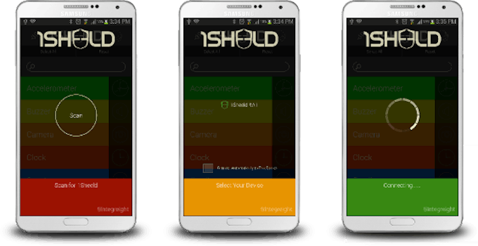

Step 7: connect 1sheeld to your smartphone using one shield application
![](https://hackster.imgix.net/uploads/attachments/228647/jxAPACa4HOX58jQeZ27D.png?auto=compress%2Cformat&w=680&h=510&fit=max)
You will be required to enter the pairing code (the default pairing code is 1234) and connect to 1Sheeld via Bluetooth.

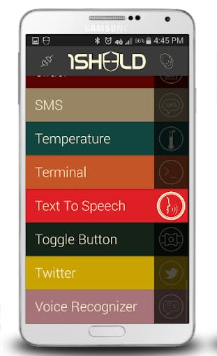

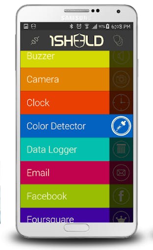

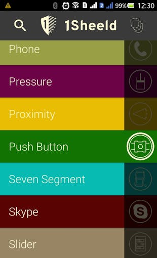

Step 8: Access Shields
· color detector
· push button
· text to speech
![](https://hackster.imgix.net/uploads/attachments/228651/7cD9S1hb1ftXV3uFledK.png?auto=compress%2Cformat&w=680&h=510&fit=max)
![](https://hackster.imgix.net/uploads/attachments/228653/e5cCfIiqASpSc5Fm1yl0.png?auto=compress%2Cformat&w=680&h=510&fit=max)
![](https://hackster.imgix.net/uploads/attachments/228654/daeIbQu3p3PuBBY7U4zR.jpg?auto=compress%2Cformat&w=680&h=510&fit=max)

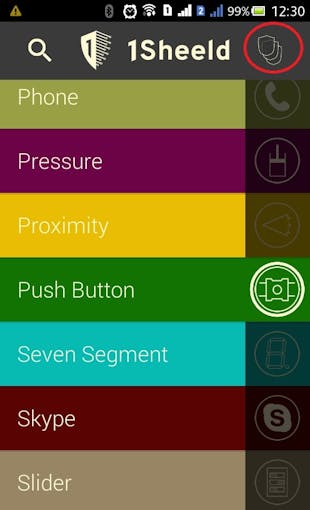

press on the multiple shields icon at the top right of the app.
![](https://hackster.imgix.net/uploads/attachments/228655/GQ3RhEJ8zmwCNyen4XMS.jpg?auto=compress%2Cformat&w=680&h=510&fit=max)

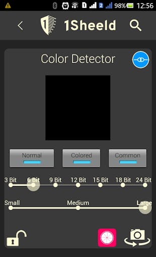

Step 9: configure color detector Shield
