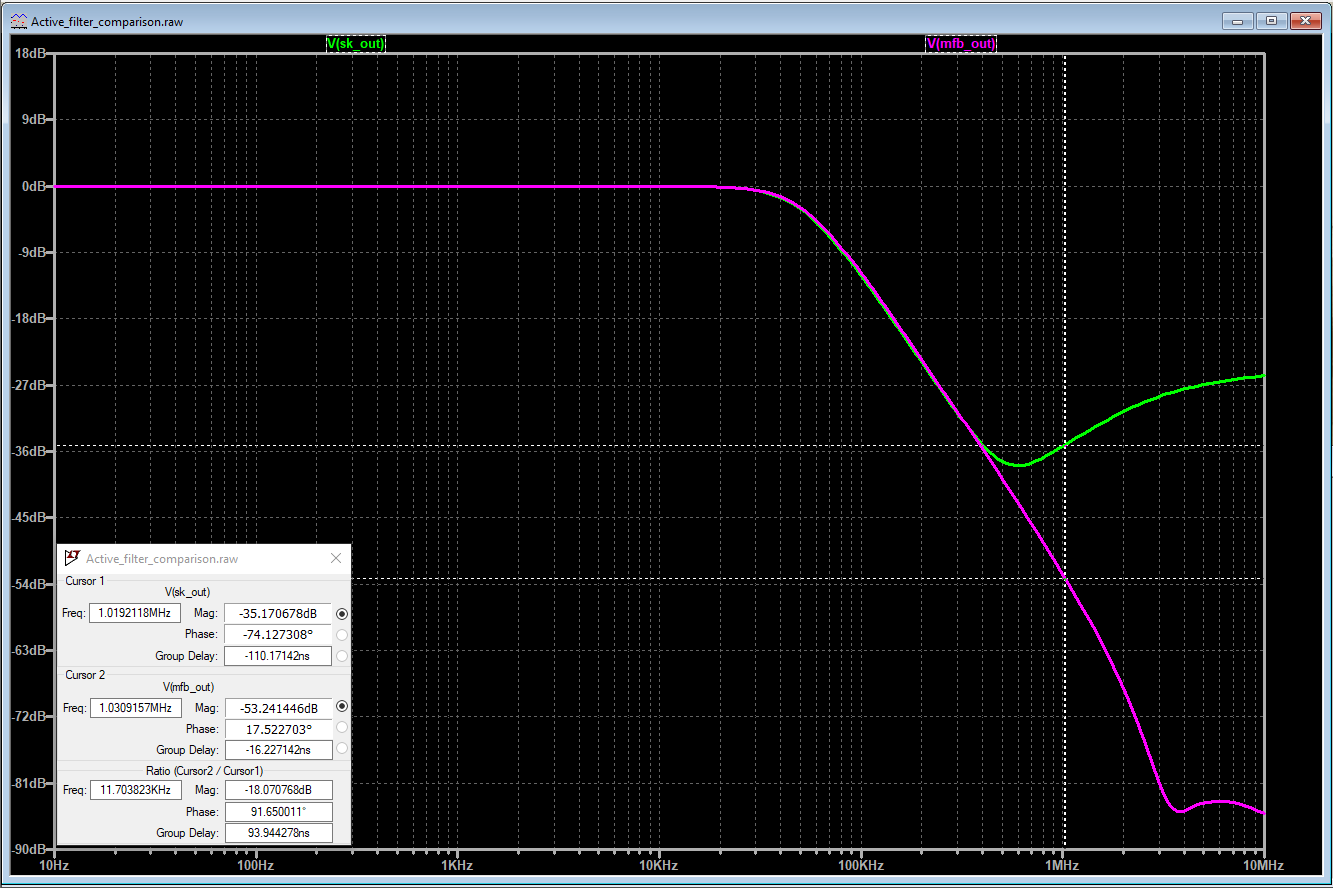

  • Building a Reconstruction Filter for the DAC
    Alperen • 05/09/2022 at 10:34 • 0 comments
    Developing a reconstruction filter for the DAC in PlainDAQ, to get nice looking sinewaves.
    Compared Sallen-key(SK) and Multiple feedback(MFB) topologies.
    MFB performed much better in the stop-band.
    LTSPICE files:
    https://github.com/AlperenAkkuncu/PlainDAQ/tree/main/Development/SPICE_simulation/Active_filter_comparison
    I had to choose between sallen-key or Multiple feedback topology, so I compared them.
    Here are the circuits that I compared:
    FSTh7YkXsAA9D6r (1185×891)Here are the results:
    FSTilZDWQAEkgYG (1333×888)Multiple feedback performed much better in attenuating the stop band.
    Added them to the schematic in my KiCAD project. I also added a switch to switch between filtered and non-filtered DAC output to see the difference between, it's going to be a fun little experiment.
    With the help of the switch I will be able to generate square waves with faster rise-time by using the non-filtered DAC output which is a plus.
