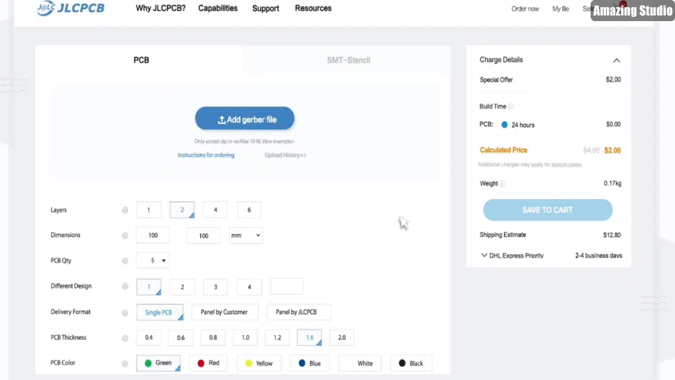

PCB manufacturing:
Ordering process:
My link is here for you, Get big discount coupons on your Very first order. Sign-up Now on JLCPCB. And try services like- prototype PCB, Stencils, SMT assembly and 3D-Printing.
