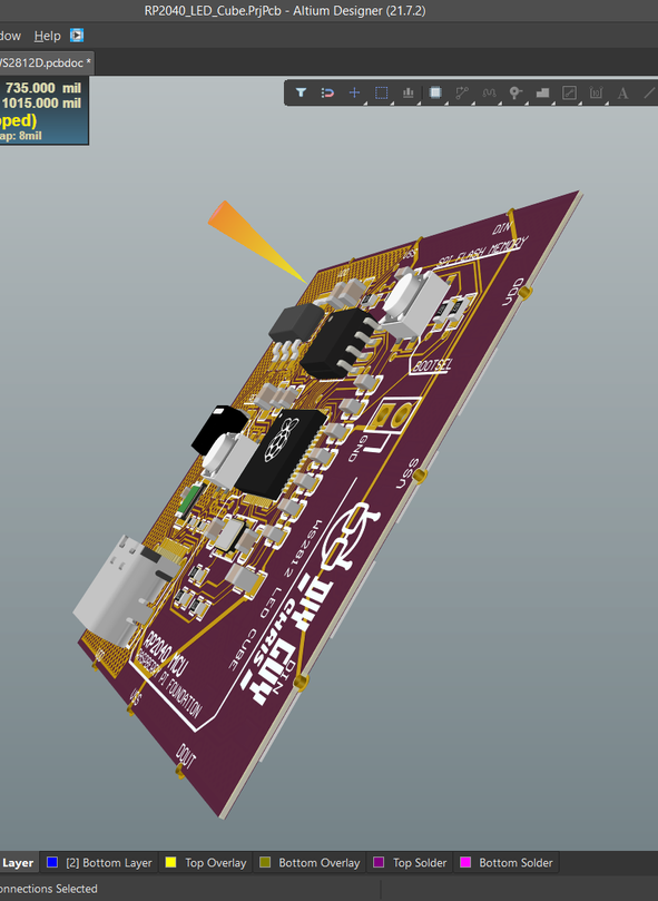

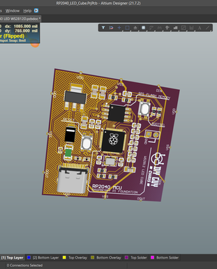

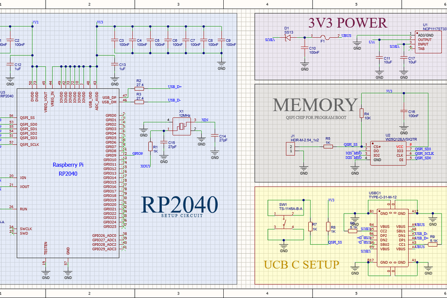

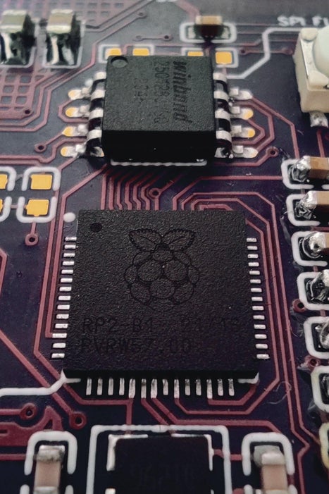

First and most important step is the selection of the appropriate components to establish a working circuit design. Since I'm dealing with the RP2040 MCU by RaspberryPi foundation then I moved to their website where I found an interesting link document to the recommended circuit setup, you can check the document link by clicking on this link.
I then followed the recommended setup to create a circuit design on Altium designer (I attached a screenshot of the Schematic), a attached supporting PDF file of the circuit schematic is available below.
I divided the schematic to four main blocks:

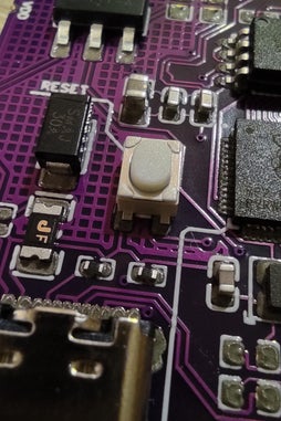

In this block, you can visualize the needed components around the micro-controller, I highly recommend that you don't ignore the decoupling capacitors for the power lines of the MCU and keep them closer to the power pins in your PCB design (recommended 100nF capacitor per power pin).

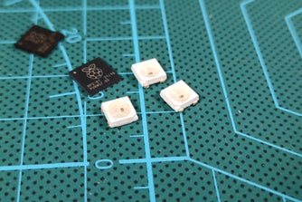

Maybe this micro-controller looks a bit different then the other ones since it needs an external memory chip where we load the program code, that's why I use a QSPI memory chip (recommend W25Q128JVS device).
This MCU needs a 1,1V generated internally by the MCU itself and a 3,3V that has to be provided externally through a voltage regulator and that's the use of the voltage regulator on my schematic.

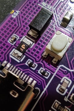

I got several requests on "what is the best setup for USB C connector for serial programming" and here I used a Type C connector so in case you are willing to use this Connector in any design of your designs then you can follow the Setup of the USB C block on my schematic.

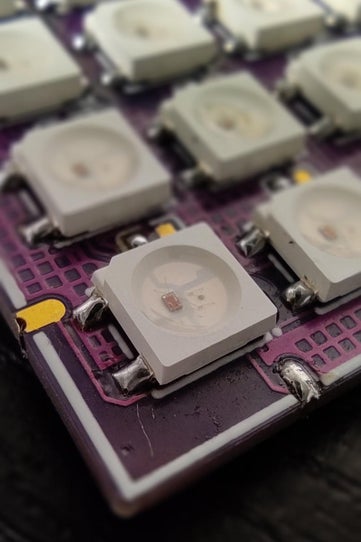

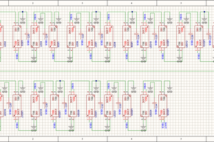

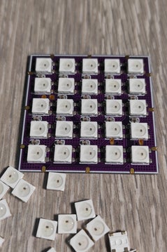

I then placed 25 RGB LED of the WS2812 type wired in series and accompanied with some 100nF decoupling capacitors.

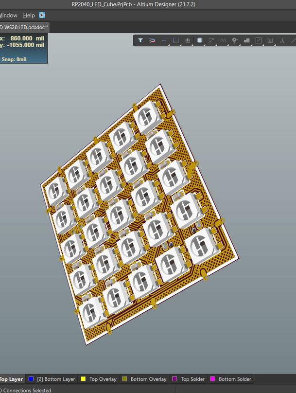

About the PCB design you can decide the shape of your choice, in my case it is a cube shape that's why all the Cube pieces has to have a rectangular shape (40mm x 40mm) you can go for a bigger size but the 40x40mm is the suitable size to equally distribute the RGB LEDs.
Note : you can download the PCB design GERBER files from this link

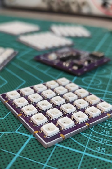

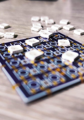

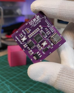

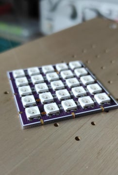

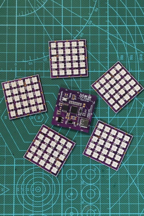

After getting the PCB design produced and delivered then all what I need is soldering the electronic components for the top and bottom sides of one single piece then I solder just the RGB LEDs in the bottom side of five pieces, all in all we have six pieces creating the cube shape. I used the Stencil that I order alongside with the PCB and this will help to equally distribute the solder paste on the PCB spots.
Probably some of you guys are not familiar with PCB assembly, not a problem because you can order the design fully assembled by any PCB manufacturer of your choice as long as you have the GERBER file BOM and P&P files which I already added them to this project. (the GERBER could be downloaded through this link)
I use Hot plate to assemble the Cube pieces, I used a low temperature solder paste due to the low temperature of my hot plate.
Note: don't forget to clean the flux from your assembled boards after finishing the assembly

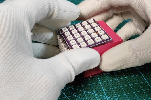

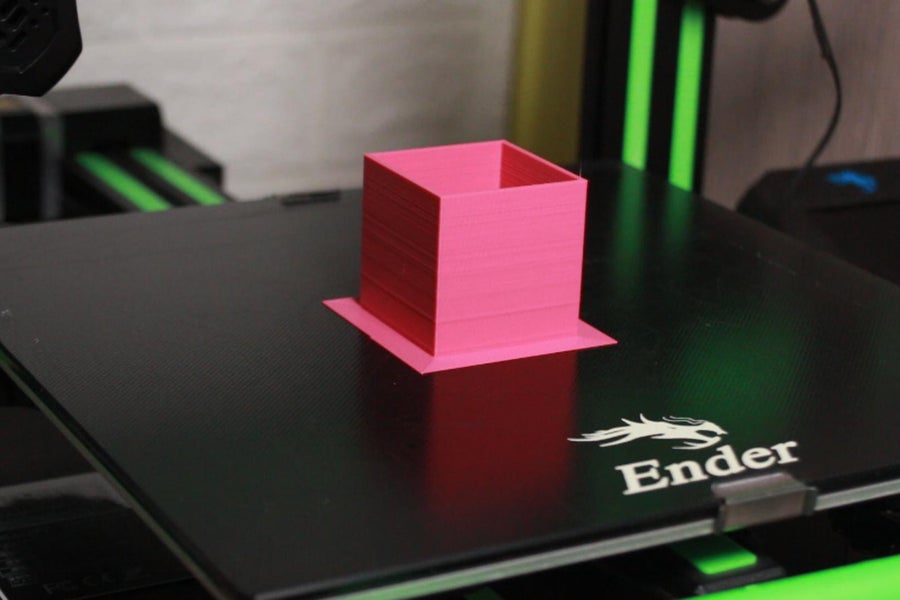

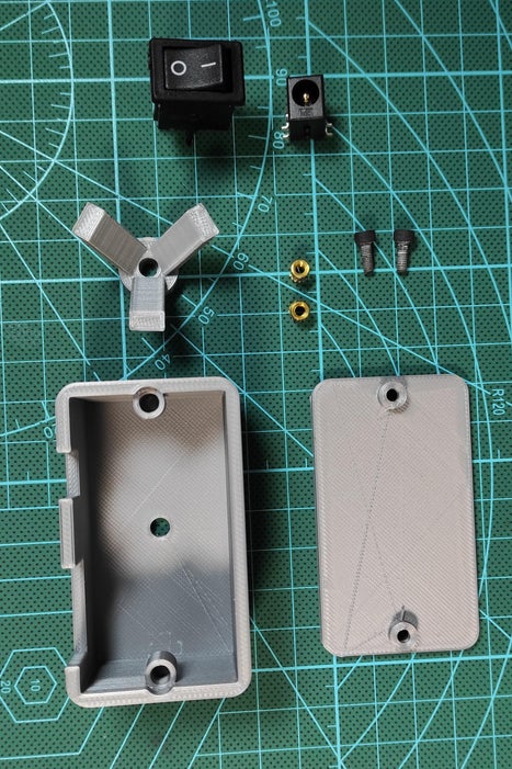

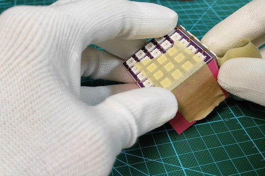

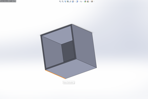

After getting the Cube pieces assembled then we must join them together to complete the Cube shape, I designed an assembly aid and 3D printed it to help me achieve the assembly of the Cube pieces (check the attached images, the pink Cube)

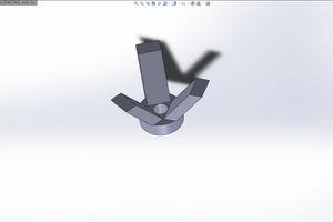

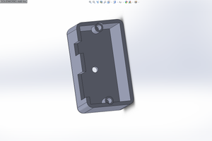

I then used Solidworks to design a good stand for the Cube where I'm going to set my Cube after assembling it.
All STL Files of the designed parts are available for download.

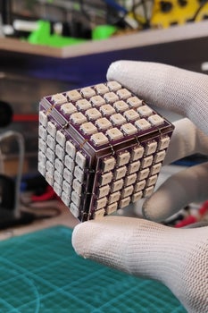

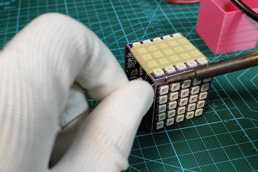

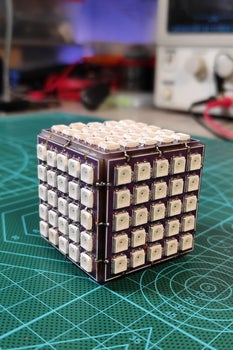

Since the PCB design that we have made has a side pins for VDD, VSS, Din and Dout then we can use these side pins to join the cube pieces together as follows:
First piece Second piece
VDD ----> VDD
VSS ----> VSS
Dout ----> Din
Then you continue with the other pieces by connecting One Dout side of the piece to the Din side of the next piece
Note : the first piece is the one that has the micro-controller.

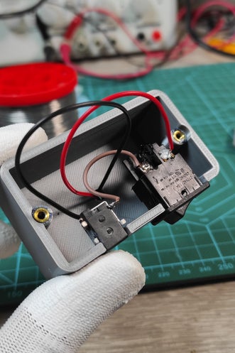

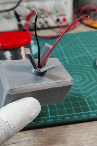

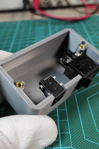

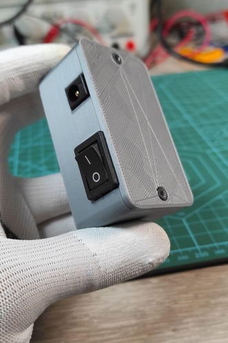

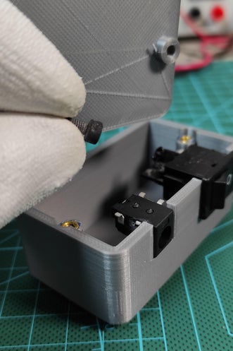

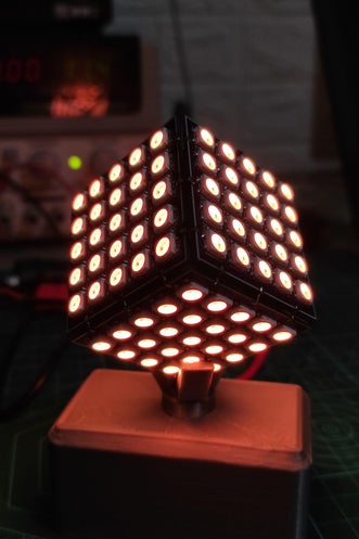

I then added a Power switch and Power Jack connector to the 3D printed stand and wired the power wires to the VDD and VSS of my Cube.

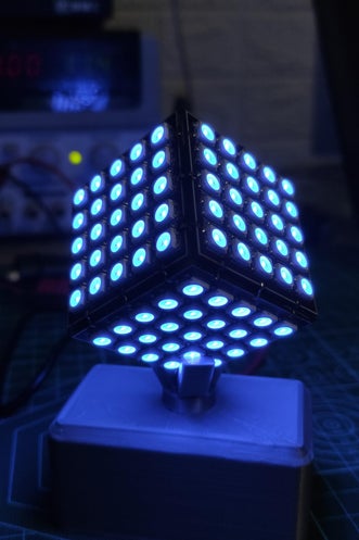

Make sure that you use a power adaptor capable to deliver 5V and up to 2Amps because these LEDs could drop up to 1.3Amps when it runs in full brightness.

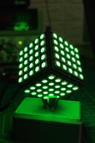

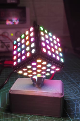

Once I turned the power switch, I got the Cube GLOWING and my RGB LEDs dancing through some wonderful color animations.
