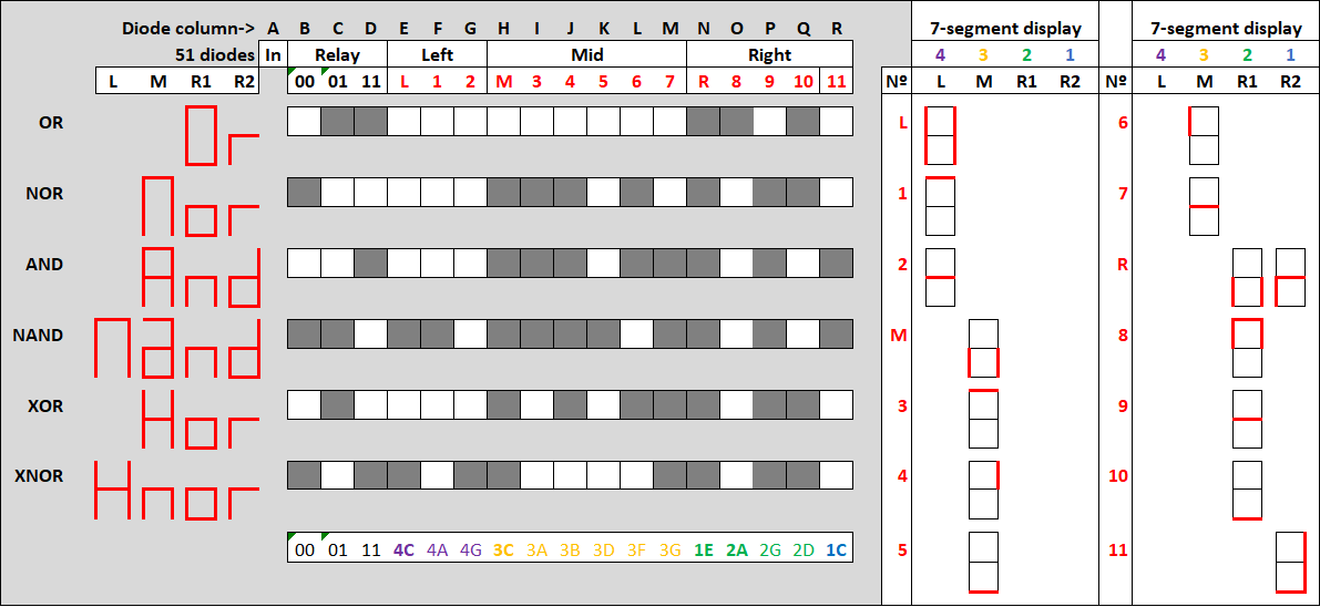

The leftmost three columns in the diode matrix are used for the gate logic. The other columns display the characters on the 7-segment displays.
The diode matrix for the logic and for the character display on the 7-sement displays. A dark square represents a diode. Horizontally the required gate is inputted, vertically the output can be found.

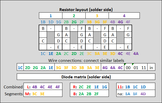

After that, the basic setup of the perfboard is soldered. First solder the 7-segment displays with their resistors attached to the perfboard. Then place the standoffs and solder the switches on the perfboard. Connect the switches with the horizontal input (i) of the diode matrix. Solder the three LED's and connect the outer two to the push buttons. Don't forget to use current limit the resistors for the LED's.
Solder guide for the 2181AS common cathode displays.
After that the tedious process of connecting the output of the diode matrix tot the several segments of the 7-segment displays. Since some diode signals need to light several segments, pins with the same colour need to be connected. Be sure that every segment has its own resistor!
Finally the relays are soldered and connected to the LEDs and the USB connector is soldered tot the perfbord.

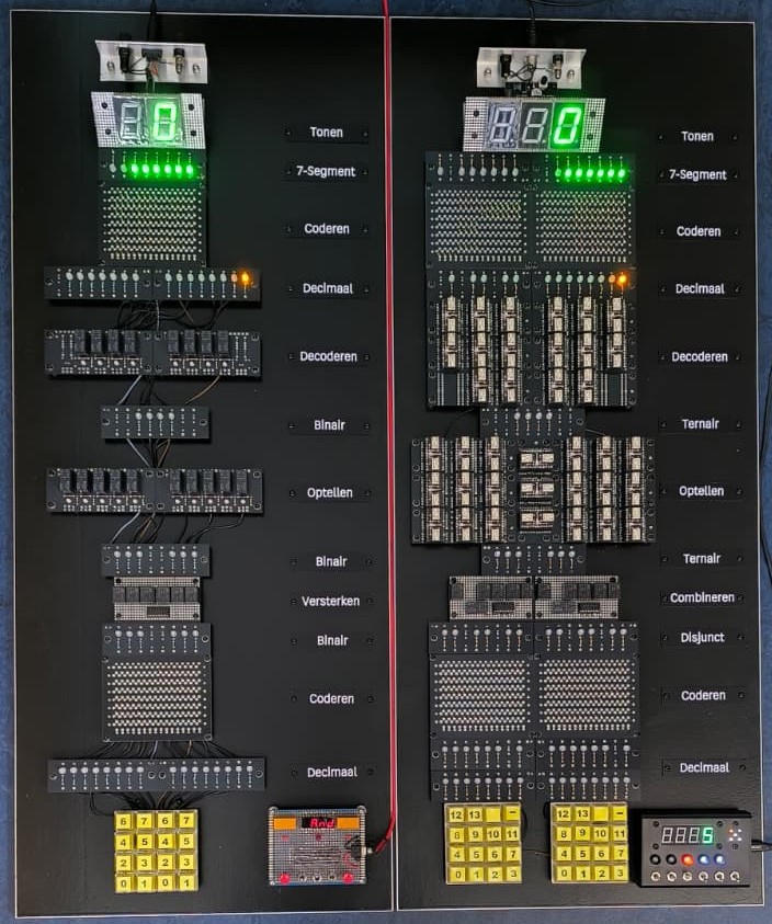

This project is part of my four‑project series “My Relay ADDiction” (pun intended): a hands‑on exploration of logic and arithmetic built with relays, diodes, LEDs, and a healthy amount of curiosity.
Each project stands on its own, but together they form a learning path—from basic binary gate behavior (It’s logic!), through number representation (TritBits), to full adders in both binary and balanced ternary.
