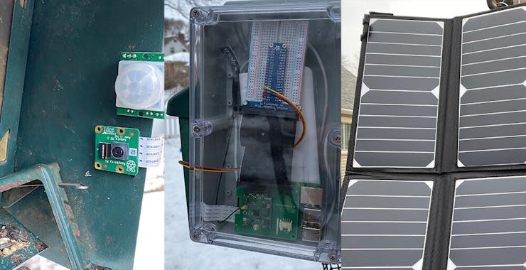

We are going to build a remote ML-powered birding solution that is a:
- Battery-powered (with a solar charger),
- Raspberry Pi 4,
- with a PIR motion sensor,
- and a Pi Camera,
- running the TensorFlow Lite runtime (using Python),
- sending identified bird data over cellular,
- and notifying us via SMS!

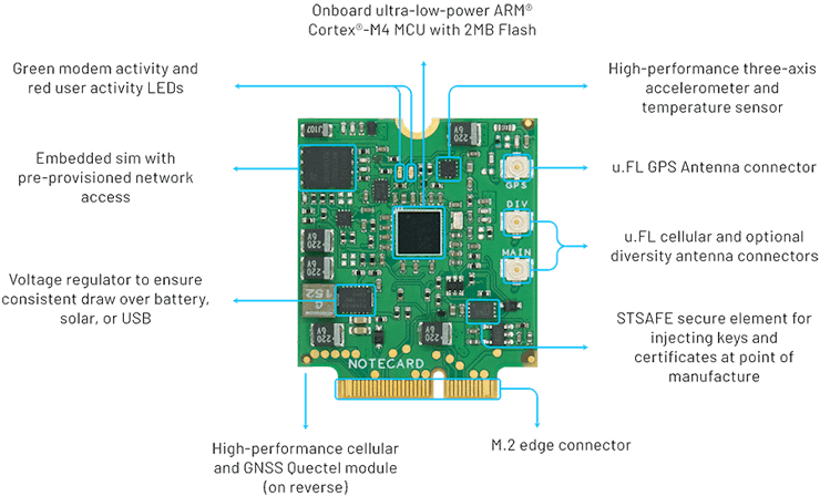

I chose to tackle this with the Notecard from Blues Wireless. The Notecard is a cellular and GPS-enabled device-to-cloud data-pump that comes with 500 MB of data and 10 years of cellular service starting at $49. No activation charges, no monthly fees.
The Notecard itself is a tiny 30mm x 34mm SoM and ships ready to embed in a project via its m.2 connector. But to make things even easier, Blues Wireless also provides a series of expansion boards (Notecarriers). For this project, I used the Notecarrier-PI, a Pi HAT with pass-through headers.

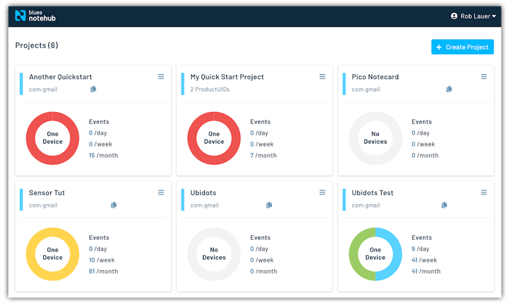

The Notecard comes preconfigured to securely communicate with Notehub.io, the Blues Wireless service that enables secure device-to-cloud data flow. Notecards are assigned to a project in Notehub, which then syncs data in those projects for routing to your cloud of choice.
The Notecard is an IoT developer's dream come true due to the baked-in security, automatic provisioning, and developer-friendly programming model.
For instance, all commands to/from the Notecard are just JSON! Should we want to send data in an event (a.k.a. "note") from Notecard to the cloud, this is how it might be composed:

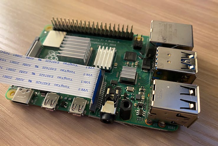

Raspberry Pi Camera
If you're using the default installation of Raspbian, it's more than likely the picamera
package is already installed. You can check by issuing this command:
Did it work? Great! If not, try:
- Verifying the camera is installed properly
- Installing the package with
pip3 install picamera
- Enabling the camera in
raspi-config
Back to bird.py
, add another import statement:
import picamera

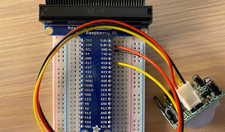

PIR Sensor
We'll dive into the motion sensor later on, so first let's make sure we have the correct package installed:

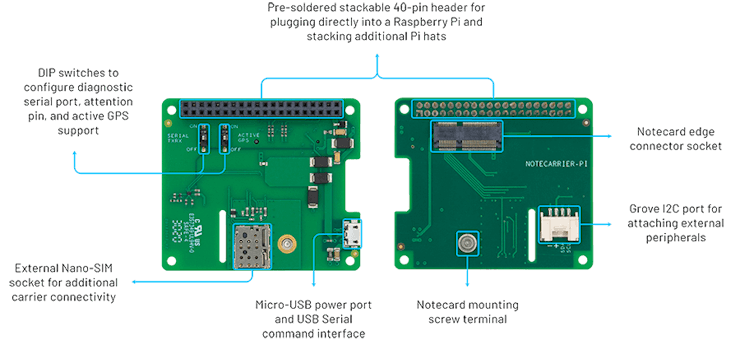

Notecard
The Notecard uses I2C for communicating with our Raspberry Pi. First, make sure I2C is enabled by:
- Running the
raspi-config
utility - Navigating to Interfacing Options
- Selecting P5 I2C and enabling it
If prompted, reboot your RPi and meet us back here.
Next, install the i2c-tools
package, so you can confirm connections to I2C devices:
sudo apt-get install -y i2c-tools
Later on after the Notecarrier Pi HAT is set up, we can ensure the Notecard is detected by our RPi by running:
sudo i2cdetect -y 1
We should see 17
in the output provided. This means the Notecard responded at 0x17
, which is the I2C address the Notecard uses.

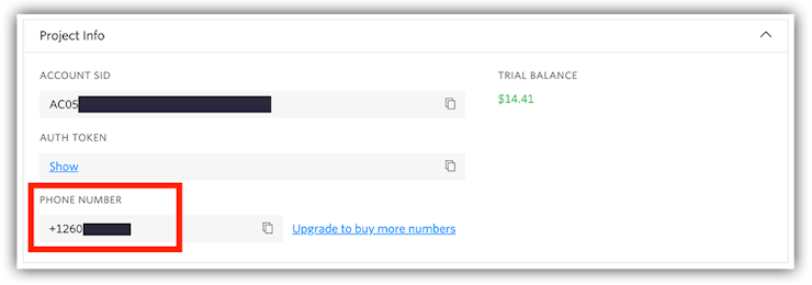

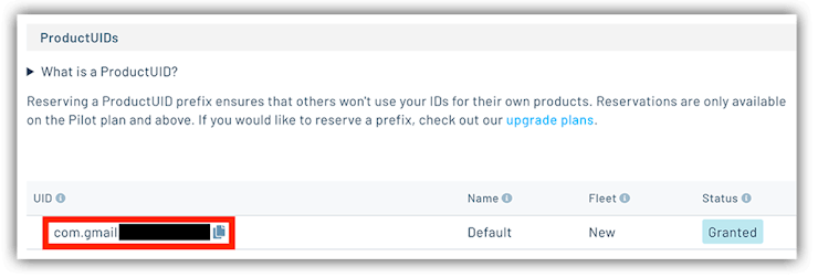

import above? There are three sensitive pieces of information we'll be dealing with later:
- Project ID for the Notecard
- Phone number provided by Twilio
- Your personal phone number
Create a new file called keys.py
and add placeholders for all three:
PRODUCT_UID = "com.your-company.your-name:your_product" SMS_FROM = "+18005551234" SMS_TO = "+18005551234"
Go ahead and enter your mobile number for the SMS_TO
value.

Activate Camera with a PIR Sensor
As previously noted, we aren't exactly putting together a low-power solution here. While we will get to the solar/battery situation, we already know that we don't want streaming video to capture the moment a bird lands on the feeder.

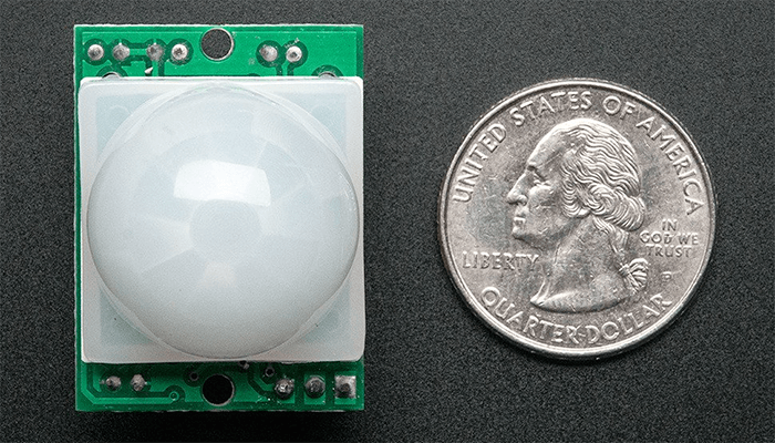

To be a little more conservative, we can use a PIR sensor to only activate the camera when movement is detected.
To the uninitiated, PIR stands for "passive infrared". The sensor detects any infrared radiation present around it. Birds (thankfully) generate a little infrared heat, and as a result, this sensor can pick that up.
In bird.py
initialize our PIR sensor with:
pir_sensor = digitalio.DigitalInOut(board.D18) pir_sensor.direction = digitalio.Direction.INPUT
Then we can create a main
function that checks for the boolean
value returned by the sensor (and runs in an infinite loop):
def main():
""" check to see if PIR sensor has been triggered """
if pir_sensor.value:
check_for_bird()
time.sleep(30) # only check for motion every 30 seconds!
# make sure this loop remains at the bottom of your script
while True:
main()

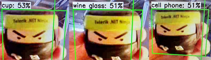

Machine Learning models aren't perfect. Far from it in fact.
Therefore, we'll want to specify a confidence threshold at which point we deem a notification worthy of being sent to the cloud.
prob_threshold = 0.4
In this case, we are setting the threshold very low (40%). Once we've verified that things are working as expected, we can increase this to at least 0.8

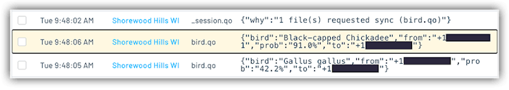

This function is building a JSON object with a request to add a new note (an "event"), specifying the name of the note file, bird.qo
, and the body of the request.
The body of the JSON object we are sending to Notehub will look like this:
"bird": "Black-capped Chickadee",
"from": "+1260XXXXXX",
"prob": "91.0",
"to": "+1608XXXXXX"

To get going with a free Notehub account:
- Navigate to notehub.io and login, or create a new account.
- Using the New Project card, give your project a name and
ProductUID
. - Take that
ProductUID
and enter it inkeys.py
That's it! When we eventually run the app, Notecard will automatically associate itself with this Notehub project. Any notes (events) you send to Notecard will travel over cellular and show up in the Events panel when received:

If you don't have one already, create a new (free) Twilio account. You'll then need to set up a Verified Caller ID number. This is required in order to send SMS messages.
Open your keys.py
file and add the provided Twilio phone number as the SMS_FROM
value.

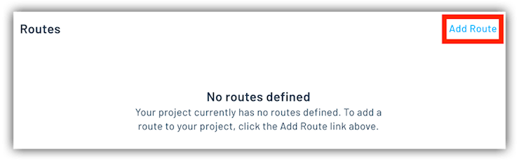

Back in Notehub, navigate to the Route creation screen by clicking Add Route.

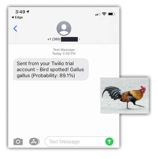

To send an SMS, Twilio expects to receive Body
, From
, and To
parameters. Therefore, our JSONata expression can be something like this, which is transforming data from the JSON object we created above:
"&Body=Bird spotted! " & body.bird & " (Probability: " & body.prob & ")&From=" & body.from & "&To=" & body.to & "&"

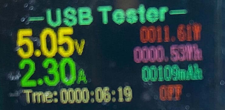

We ideally want to provide a 3.0A (current) output to reliably power our RPi. In practice, I found the power requirements to be lower when idling. But it's best to be safe.
Battery capacities are denoted with mAh (milliamp hours). For example, a 1000mAh battery will provide 1A of power for 1 hour.
🚨Overkill alert!🚨 To play it safe, I chose a 30000mAh(!) battery. Worst case scenario this would give us about 10 hours of service. In reality, with most peripherals disconnected and the device idling most of the time, we could easily see > 24 hours of operation (which is great as we want to charge it during the day!).
NOTE: You can squeeze more savings out of a RPi with/usr/bin/tvservice -o
to disable HDMI, turn off all LEDs, and runrpi-config
to underclock the CPU.

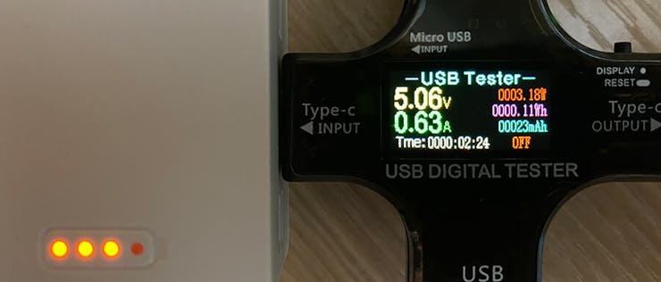

To charge our battery during the day we ideally want to supply more juice than the RPi is using (accounting for nighttime idling and cloudy days).
🚨Overkill alert!🚨 I opted to use a 42W solar panel array. Under ideal situations this array could provide enough power (on a sunny day) to keep our battery charged. Even with full sun though, I was only seeing 11W.
There are a lot of variables to consider with solar power (varying consumption rates, changing temps, cloudy conditions, etc). YMMV when it comes to properly powering your RPi!
NOTE: It's outside the scope of what I hoped to accomplish with this project, but ideally we would execute a safe shutdown of the RPi when power supply gets too low.
Thankfully, connecting the Raspberry Pi --> power bank and power bank --> solar is a snap with USB-C and USB-A connectors.
(Some) Assembly Required
Thankfully, the Raspberry Pi allows for easy assembly of the rest of our components.
The Pi Camera slots into the...Pi Camera slot on the RPi.

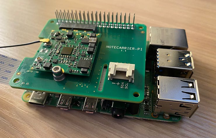

The Notecarrier-Pi HAT slides in place and provides pass-through headers for the T-Cobbler.
The T-Cobbler provides an easy (but granted, a bit bulky) means of connecting to our PIR sensor with jumper wires to power, ground, and GPIO pin 18.
Get Ready for the Outdoors
While I wasn't anticipating this would be a 24/7/365 solution, I did want to provide some amount of weatherproofing for this array of supporting hardware.

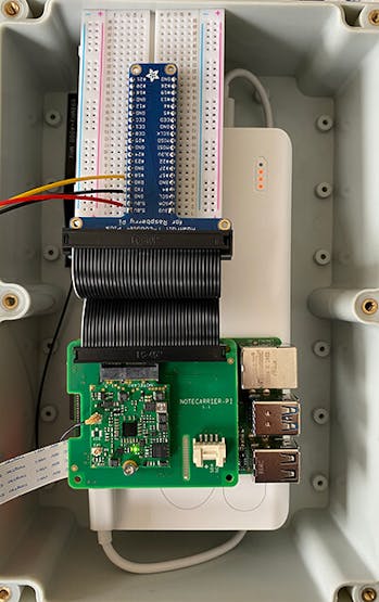

A reasonably-priced option turned out to be the Awclub ABS Plastic Junction Box. Secured by six bolts and rubber stripping, it's a nice plastic case providing just enough security from the elements.
After drilling a small hole in the bottom for the solar panel's USB cable, we can thread the camera and PIR sensor wiring through a gap in the seam (avoiding more drilling while still providing just enough weatherproofing for my needs!). Using some double-sided tape we can securely attach the PIR sensor and camera to the feeder.
And we're done!
